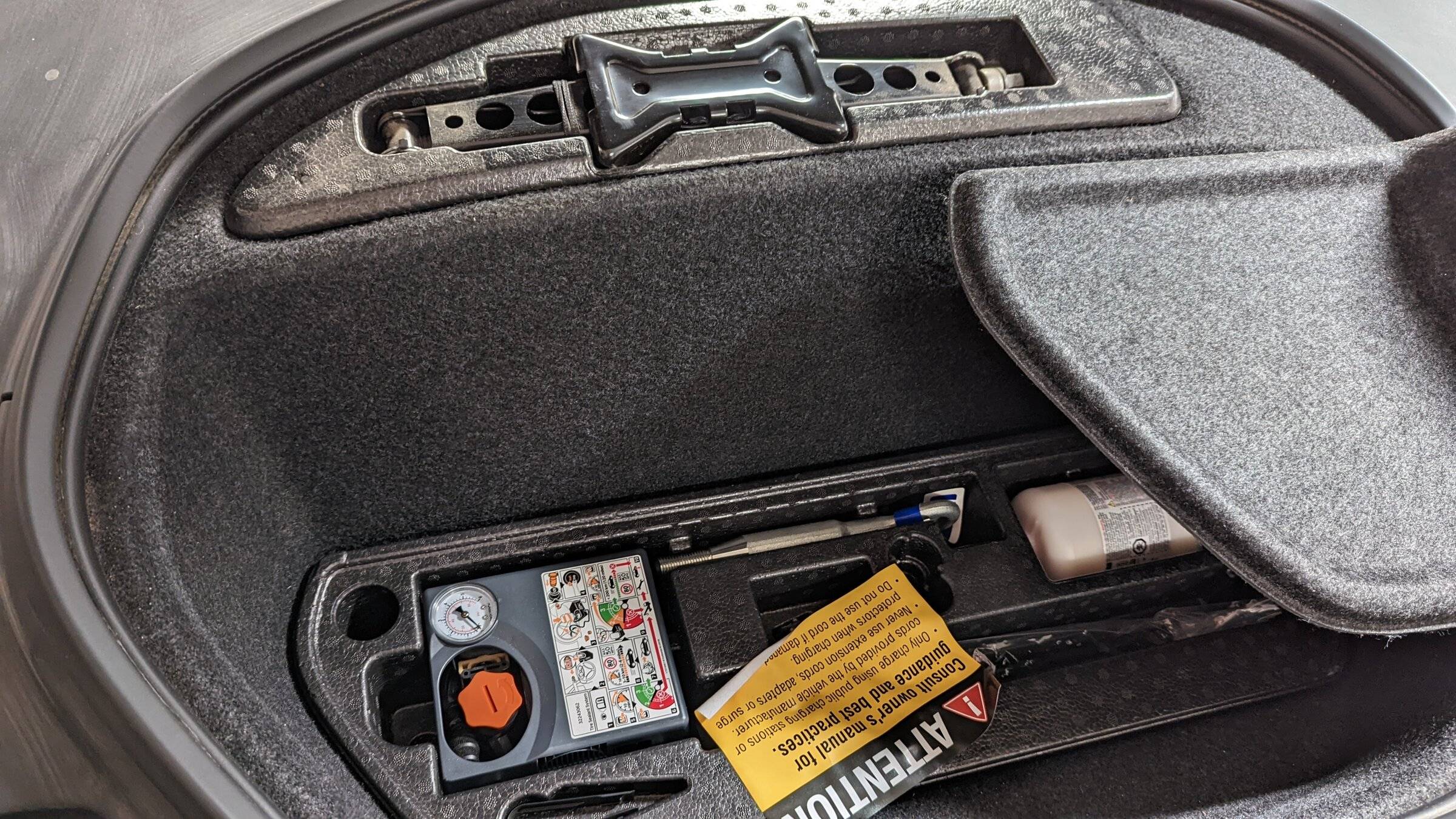

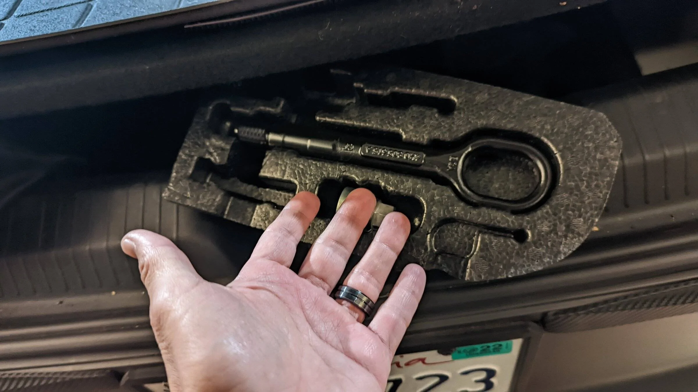

In case anyone's interested, in my garage currently:
Ford Mustang Mach-E Factory Tow Hook PXL_20220407_060510451
Tow hook in a lovely carpeted frunk in the Polestar 2. Towing points front and back.
Ford Mustang Mach-E Factory Tow Hook PXL_20220407_060710615
Oh look! It's a tow hook in my VW ID.4. It fits in the front and rear bumper too.
Wow. A jack AND a tow hook. Now I’m jealous.
ROFL and both of those tow hooks look to be right-hand thread. Ford chose LH… ???

I think UK uses LH thread in general, and I wonder if that was basically the launch country in the EU for the vehicle.
