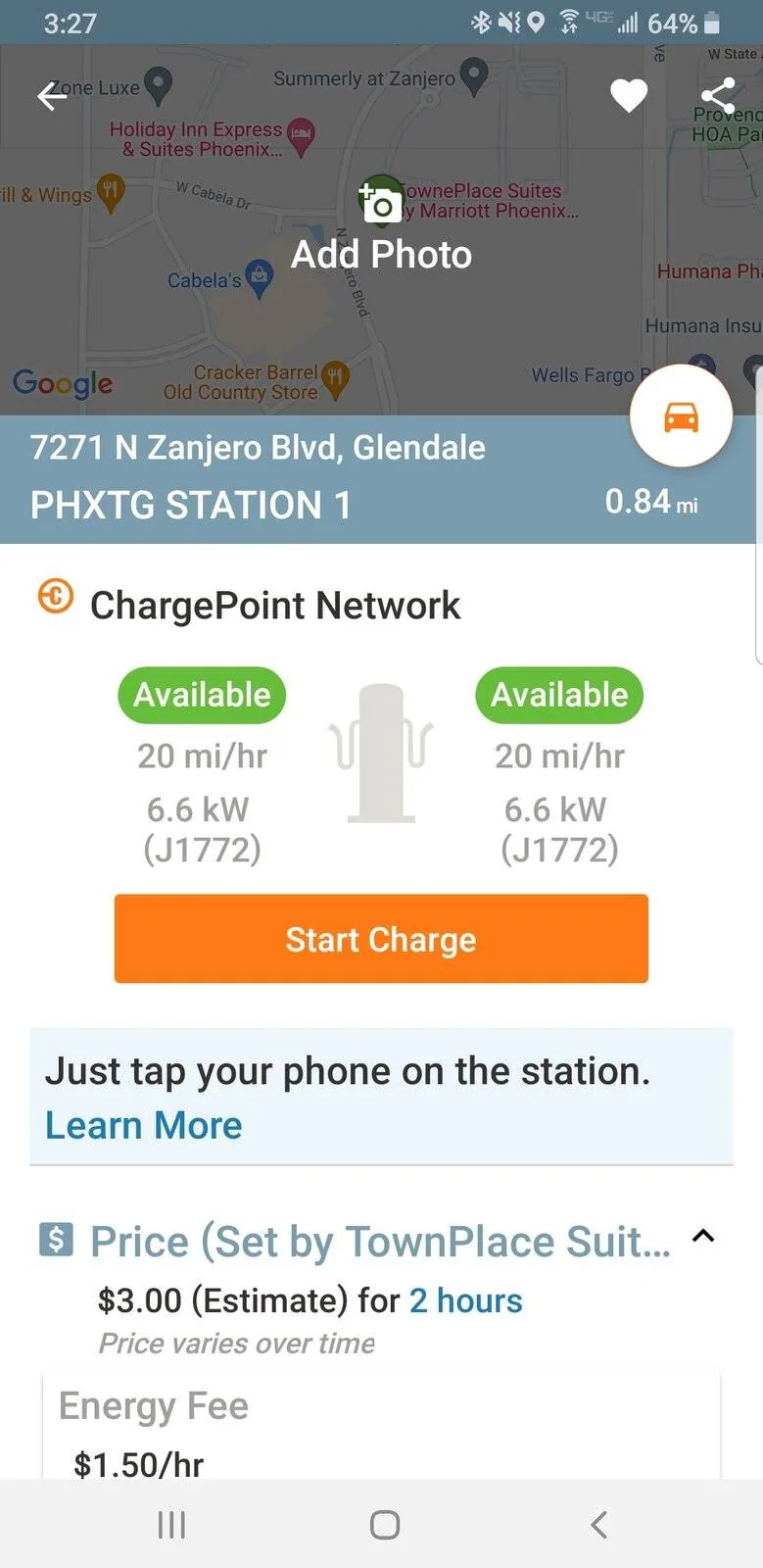

In my case I had to use the app in order to make the charger work, since the NFC on the charger was not working.
In order to make the app work, you open the app. On the map you will see yourself circled and one or more stations pinpointed in your circle. Tap on the pinpoint and it will open a little pane at the bottom of your screen. The name of thee charge station you have selected will be in that pane. If that name doesn't match the one on the screen of the one you're parked at, tap on the pinpointo n the map again and it'll cycle through the station names at your location. Once the name of the charging station on your phone matches the one on the screen of the station you are parked at, swipe the lower pane up or tap on it. You can then tap on the "Start Charge" button.

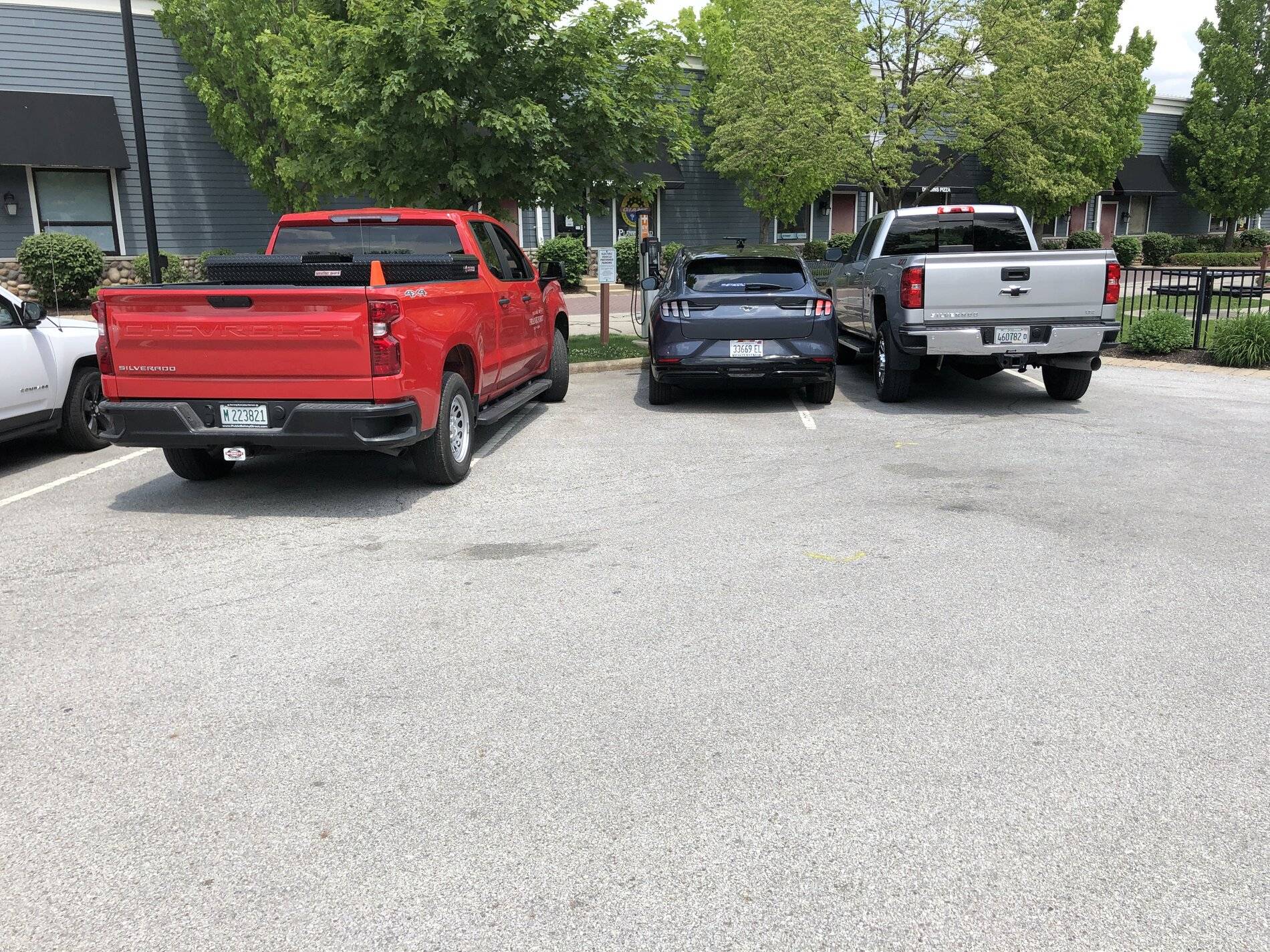

So I e-mailed the Village and didn't expect to get an answer right away but at 8:45 am this morning I got an answer and he contacted the company and got the charger on the map and registered in their network. I went over there and tried it again there was an illustration of how to do it. I followed the directions and used my Charge Point in my Apple wallet. It worked and the unit was ready to charge. I was at 98% so I didn't care to sit there to get to 100%. It was funny because I was surronded by two enormous gas guzzleing trucks.
Ford Mustang Mach-E Failed to Connect at a Charge Point EV Station IMG_0783.JPG
I got out of there as fast as I could once I saw the unit charging. As you can see, I didn't park very well as I was too close to the silver truck. The red truck was a Village of Frankfort truck so he'd be cool but I don't know who owned the silver one.
Is that on Oak Street? I see a charger on the map there today that I don't remember seeing on Saturday.

It’s actually in the parking lot off Kansas Street. It’s the same parking lot they have Thursday night auto shows (if they stil have them). The charger is about 10 feet from the Plank Trail and about 30’ from the stage. Yes, they added the charger when I contacted the Village of Frankfort and e-mailed them that Charge Pointe said they weren’t in the Network and not on the map. The person who helped me must have joined the network because now it’s on te map.h
