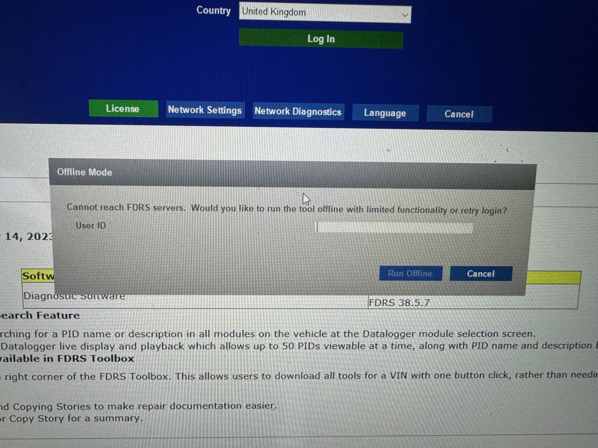

Hi ive purchased a 24hr Licence (im based in the United Kingdom we dont have a 2 day option), ive installed FDRS, when i try and connect i get the attached error. Am i doing something wrong, also i need to install IDS before installing FDRS?
Any advice would be much appreciated.

You will want to uninstall FDRS, download an older version (search for a link to download 37.4.7), install it and you will be able to log in. After you log in successfully you will be able to upgrade to 38.5.7 and use it successfully.
I would return the license before you go through this process.

You can get the older version of FDRS below:
https://github.com/nitrobass24/FDRS-Archive/releases
I recommend 37.4.7.
Edit: The error message you posted is showing FDRS has no online connectivity. Maybe a dumb suggestion, but make sure your wifi signal reaches wherever you are working on your car.

Looks like the same issue i got with FDRS, in my case it was the wrong language version installed. An older FDRS version also helps.

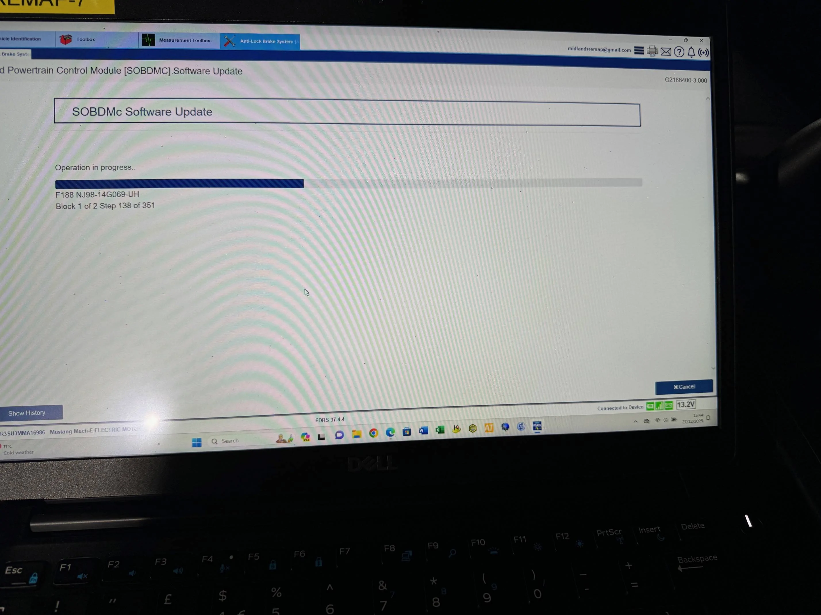

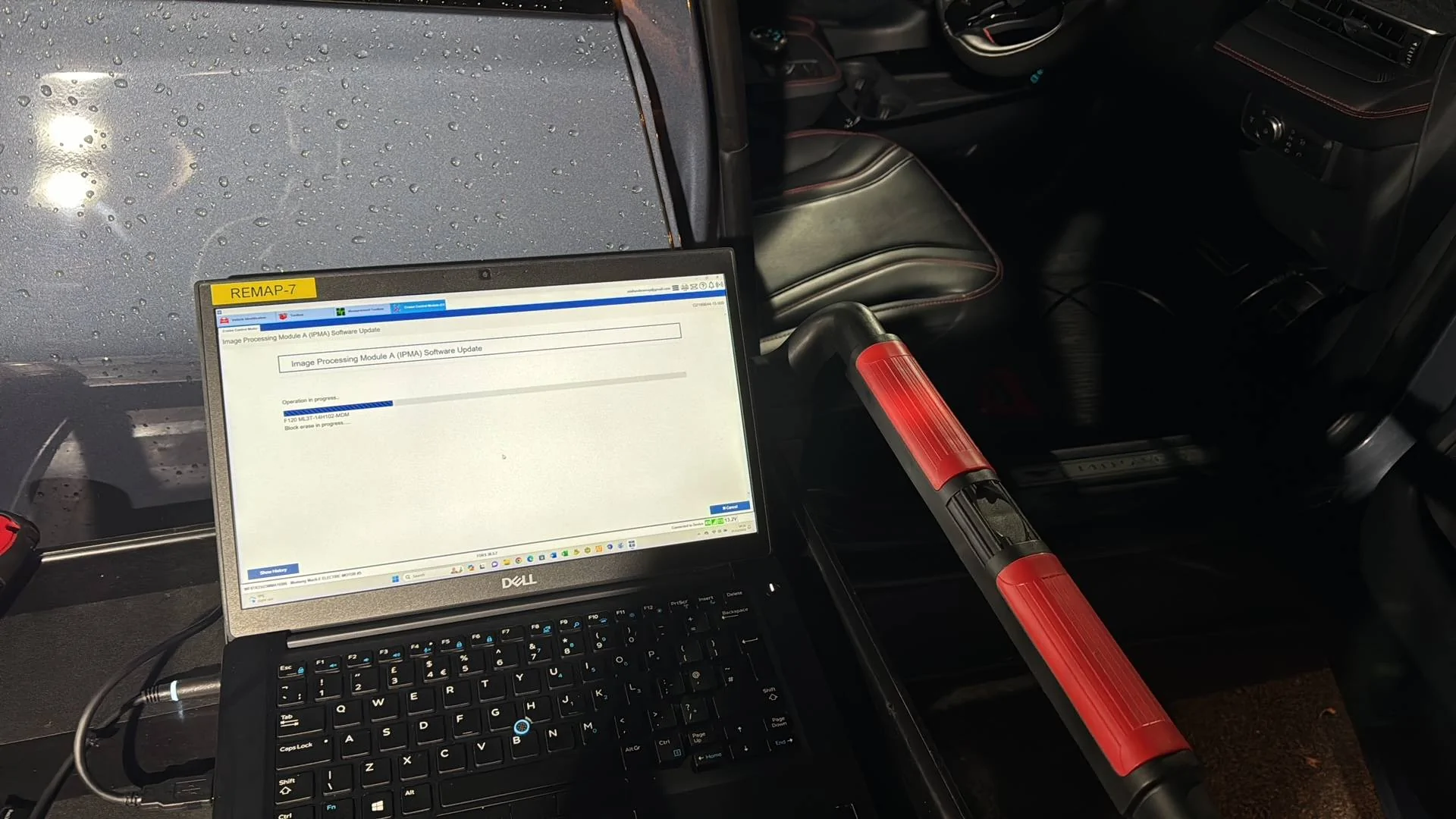

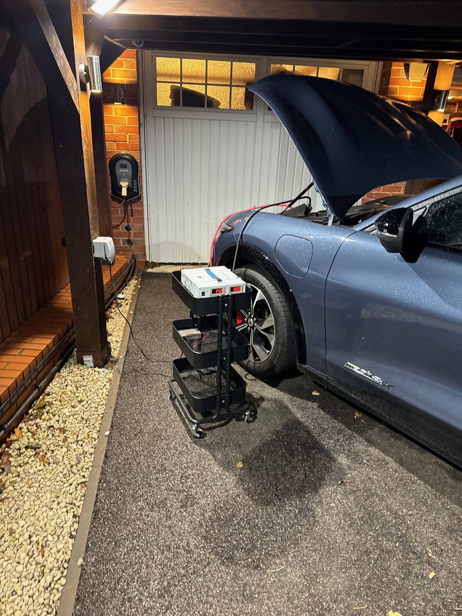

Got it installed, started at 2pm and finished at 11pm. I have a dedicated battery support unit (can supply upto 80amps), the car did not draw more than 30amps throughout.
Happy with the results.

Glad you were successful. Can you please confirm how you got FDRS working? Did you follow the recommendation to downgrade FDRS to an older version and then reinstall?
yes i downgraded to a older version and then updated as it would not connect to the servers with the latest version

Thank you for the confirmation. That was my experience when I ran into the issue so I'm glad to see you were able to reproduce the solution.
