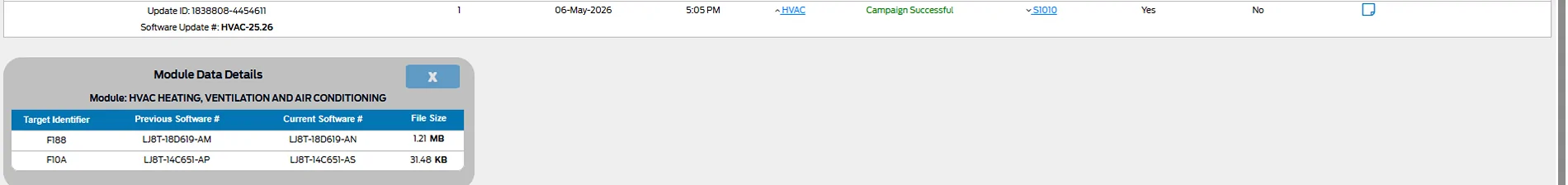

elmedico27
Drew
May 19, 2022
274
363
Missouri
2022 Mach-E Premium AWD ER
I checked the VIN you sent me to compare to yours, but that vehicle got that OTA over 6 months ago, so I am not able to see the name of the strategy file so I can look for it on your car. Because I am no longer able to see pending updates, I have to get creative to check these things. In this case, the method I use to check these things is useless. I would need the VIN of a vehicle that got the HVAC recent enough for me to be able to dsee the update details.
Do you have my VIN? I just got it on Wednesday.
