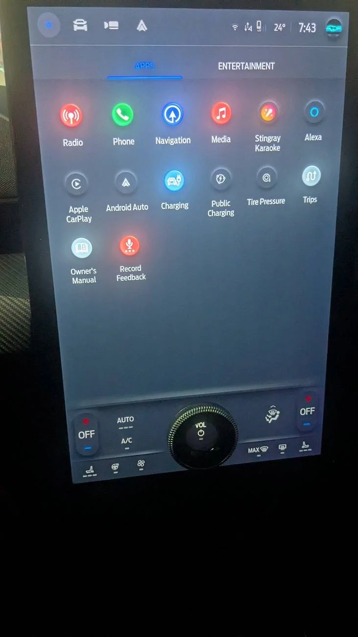

Let's start here:
Ford Mustang Mach-E Ford Connectivity PXL_20250616_024339931.MP
This is the Mach-E Apps which can't be changed. You will notice that there is CarPlay, Android Auto and Alexa.
As I said, for CarPlay it is only really using the speakers, display, microphone, and touch.
But what about Alexa? Well, it is a Mach-E App which works without your phone so clearly it gets its cell connection from the Mach-E.
I think the documentation for all of this is a bit misleading. it sort of implies that the Ford connection service can somehow do all this streaming on its own. But if that was true it would need some kind of way just to access those services like an app. But there isn't any app like that in the Mach-E's apps, with the exception of Alexa, which can do that.

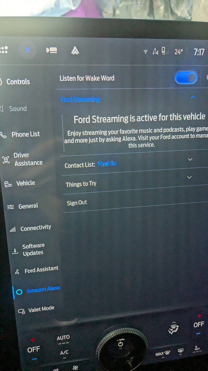

And look at this help:
Ford Mustang Mach-E Ford Connectivity PXL_20250616_021736639.MP
So, what you really have here is the Mach-E uses the "Ford Connectivity" to connect to Alexa and expects Alexa to provide all those promised services.
And what services would that be? Well, anyone connected to your Alexa account of course. Like I have Amazon Prime so I can ask Alexa to play music from the Amazon Music store. You can link Alexa to iHeart and have Alexa connect to that service (through the Amazon servers).
