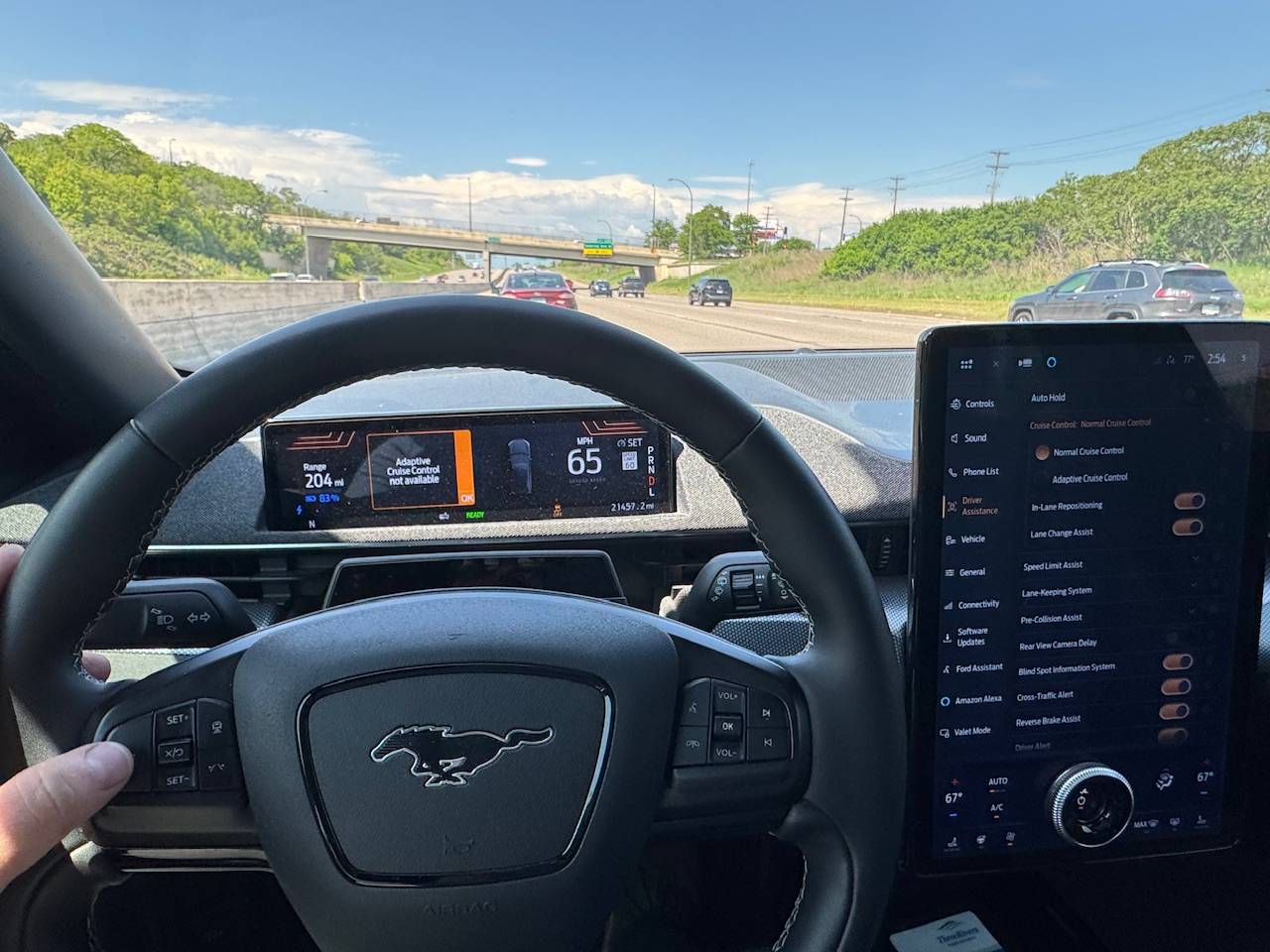

Ford pass hasn’t worked for me in about 3-4 weeks. Nor does the Ford owners website have updated car info. Fuses didn’t do crap. Smacked the car battery against the wall a few times and didn’t help either. Blue cruse is also out of commission. Mines at the dealership the 2nd time as I tell them again. I’m (the dealership) waiting on a Ford engineer to come out in a week or two to see why the car isn’t communicatIng. I’m guessing an update fubarbed the modem software as I read online seems to happen. Though strange it’s requiring an engineer to come out. Hopefully yours isn’t the same issue.
I am also have no connectivity and constant electrical system drain alert, and no word from the dealer/Ford. If yours was fixed any insights on the repair?

Received mine back memorial day weekend. That day back I had a no cruise control available. I’ve had no cruise control 2 more times. Last one was yesterday on way home from work (24 miles drive). Car goes in Tuesday to be looked at again. They had the car for about 5 weeks until the Holiday. Currently since being back, Ford pass works At least along with remote start etc. So that’s good. But last time that all eventually failed.
