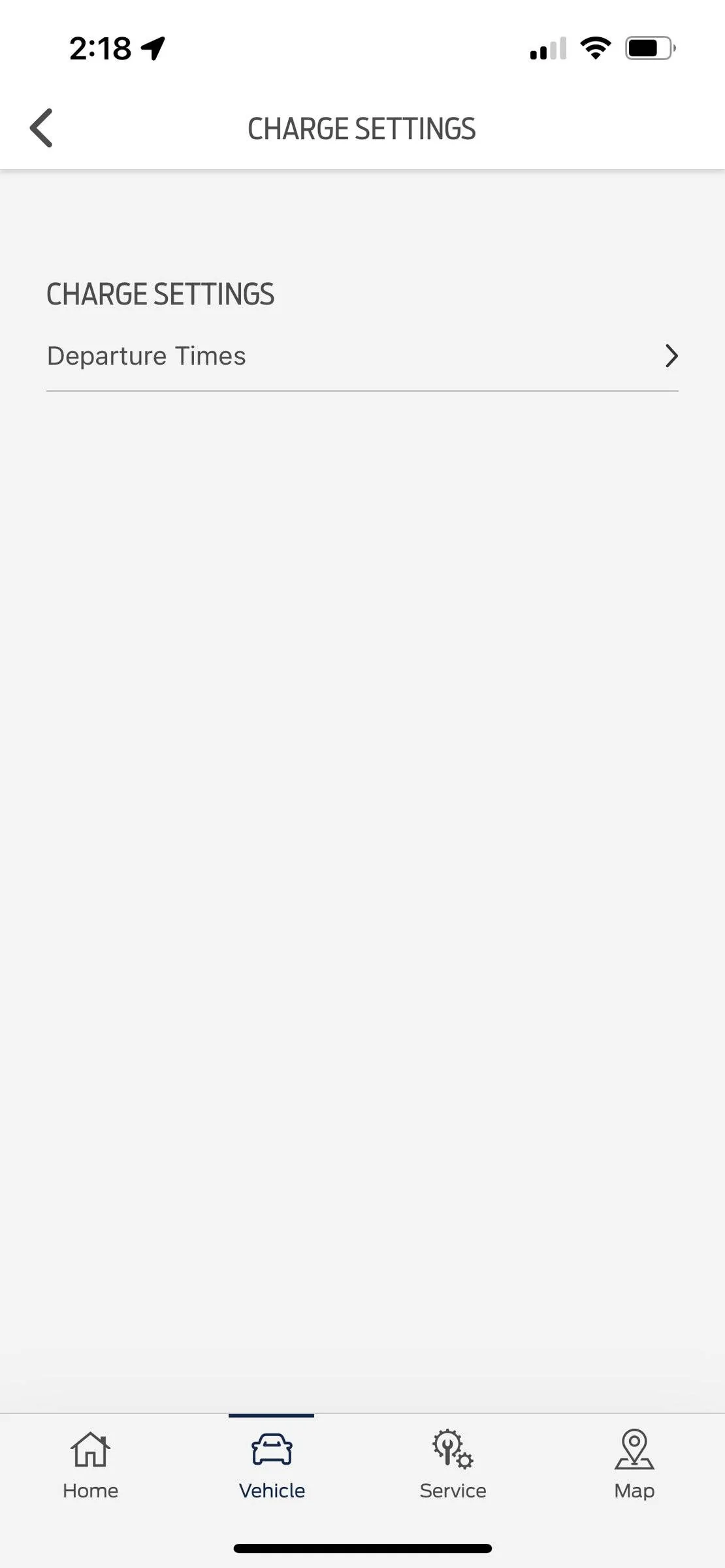

Hello, Did the most recent Ford Pass App remove the ability to adjust the max charge setting?
I could swear under Vehicle> Charging > Charge Settings I used to be able to adjust max charge level for different charging locations but now on the latest 4.14.0 on iOS all I see in that section is the departure time stuff.
Am I going crazy?

It used to be here, but it isn't anymore for some reason for me... Granted, I can still access it in vehicle but sometimes I just want to do stuff remote

Just attempted the delete of the app and reinstall. That did not fix the issue.
When I first noticed that this happened, I saw in the car that it started calling my house "Default" but when I go in to edit that location it says "Home" within that screen.
I think I'm going to have to delete all previous charge locations and re add them in vehicle.... maybe that will let the Ford Pass app have the data back. I also get to re-add my phone as a key...
If that works great if not, ¯\_(ツ)_/¯

So. After much trouble I’ve gotten phone as a key working again for our devices…. Which wasn’t even the reason for this thread. But now that is working again so yay.
I next deleted all my previously configured charging locations, which was just 3.
I then successfully re added my house as a location with a max charge of 80%.
after all that I am in the exact same situation where I can no longer configure my charging locations via the Ford pass app.
cautionary tale for anyone else that comes across this thread. If you also have this problem do not delete the app from your phone.
The only thing I didn’t try that I would have been willing to when in the depths of poorly designed edge case tech hell, is to completely forget my vehicle from my FordPass account.
now I am willing to live with my inability to adjust max charge percentage from just my phone.

Just an update to this thread, in case anyone ever has the issue of Departure Times and or Preferred Charge Times being Grayed out or missing...
I went all the way through removing the car from being connected to my wife and I's FordPass accounts.
Once I did that, I added it back to my Wife and I'd account's, and setting up PAAK and wireless car play etc. again.
This fixed my issue and I can now set Preferred Charge Times and Departure Times from my phone which is way better than having to jump in the car to do it.
