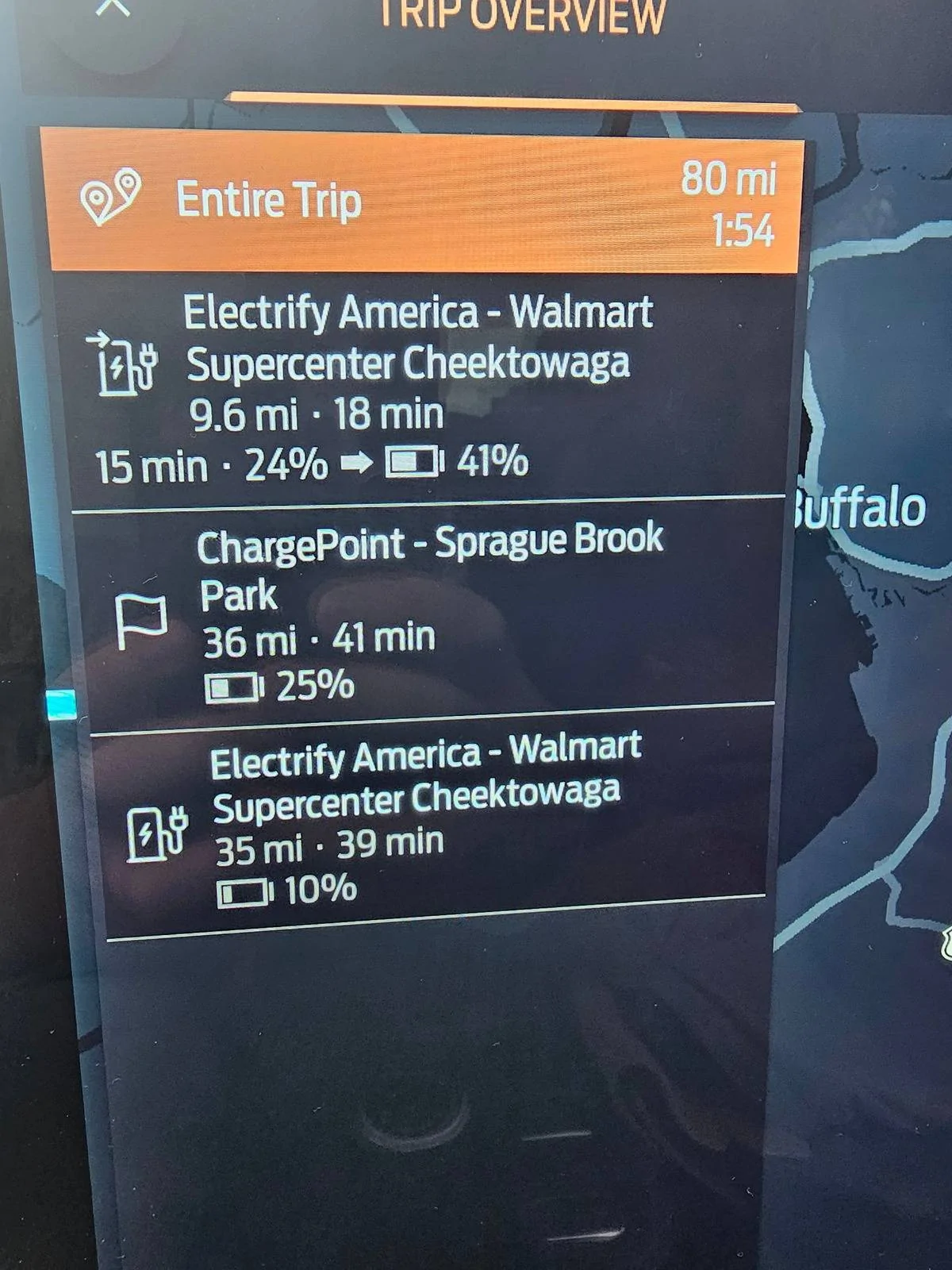

So I've done some testing with the Ford navigation on a couple of road trips now across the eastern United and I'm pretty sure it does not take into account elevation. I keep getting the message "range revised due to route" which is in line with others, however, it only ever shows up when there is a significant amount of highway driving.

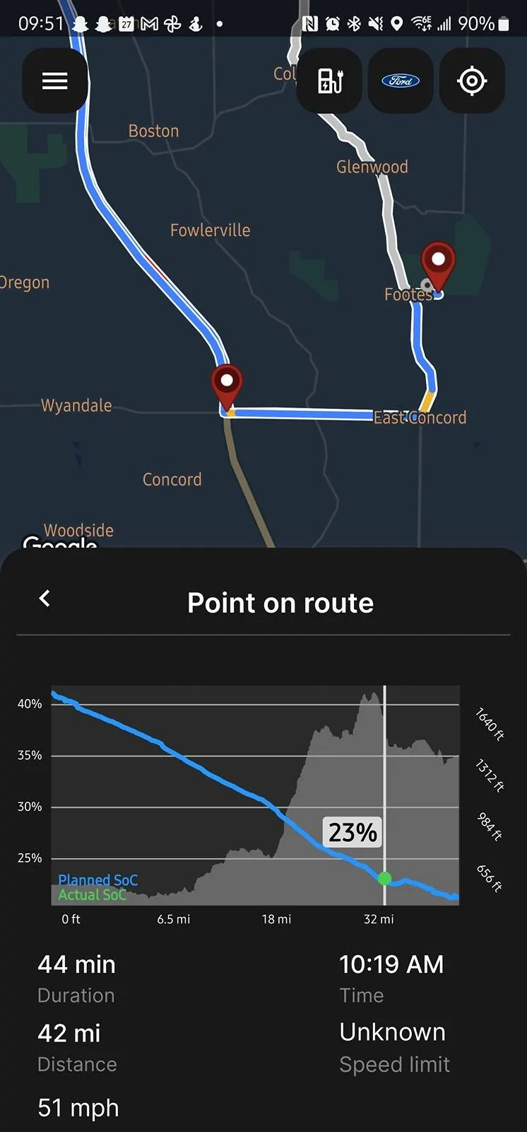

Today I went out to my car and plugged in the address of a local park that has roughly a 1500ft climb to reach the parking lot, and well the Ford nav said it was the same energy used both ways.

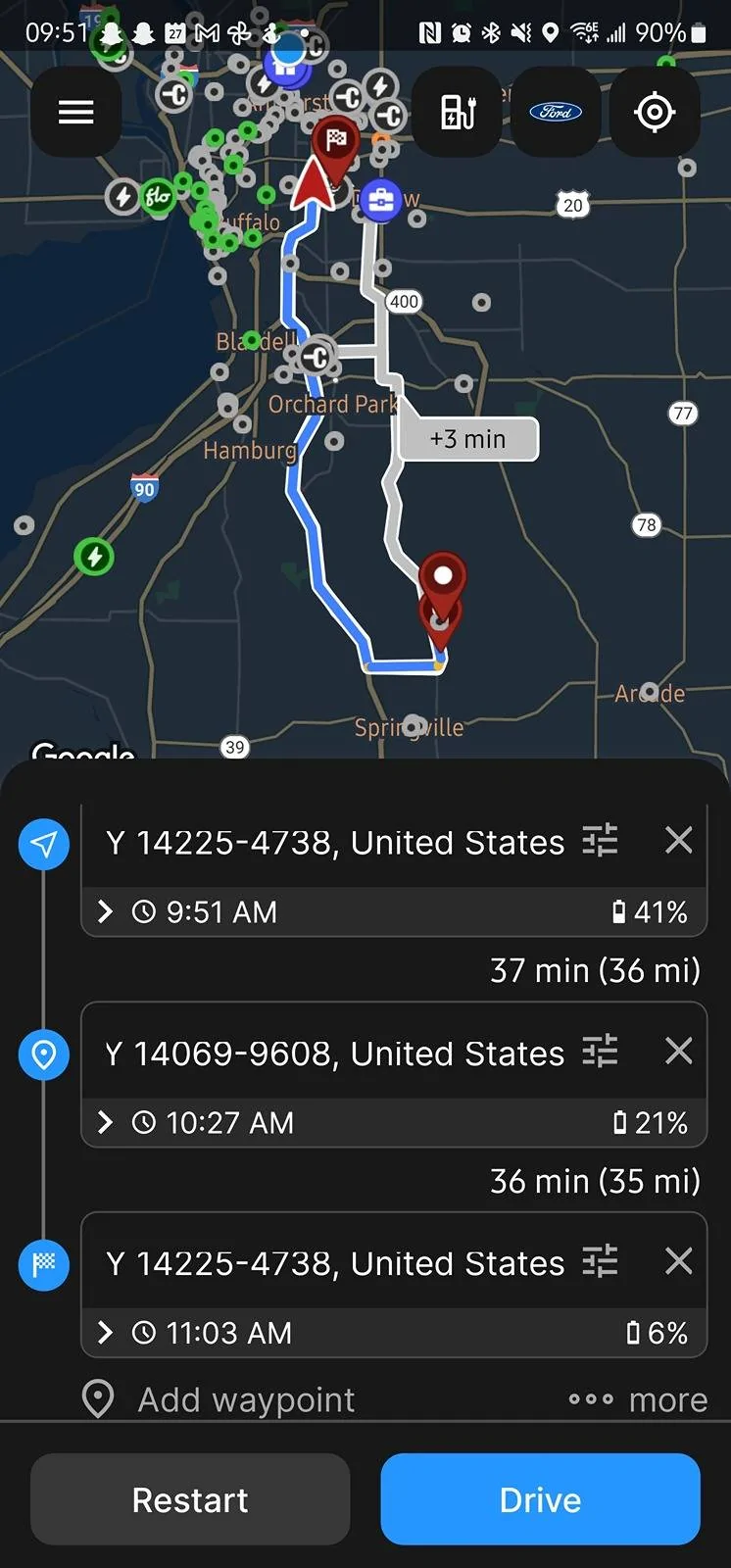

I have the car very well calibrated with ABRP with all categories being above 85%. The consumption it came up with is 3.16 mi/kWh, and its SOC on arrival is never off by more than 1 or 2 percent.
On this same route ABRP said arrival at 21% at the park and 6% back at EA. The car said 25% and 10% respectively.
Does anyone know if the enhanced intelligent range hill grade only works on major interstates? The road going to the park is a NYS state road but is a 65mph divided highway. It also never "adjusted" the gom for this route. Only if I put in a destination further than about 60 miles away does it do it.
Ford's wording on the "hill grade" seems very specific as in none of their press material does it say elevation, so is it simply "oh this is a steep mountain pass but we don't know how high it goes so just drop the estimate by 5%" or something else?

Ford will do navigation twice: once is done immediately in the vehicle. It's calculated by the onboard navigation software. Elevation, wind, temperature, etc. are not included in that calculation.
After you start driving you get that "range revised due to route" that includes all of these various environmental and other parameters. This is calculated by a Ford server. For our Lightning pulling a trailer it also takes trailer parameters into account and does pretty well for the overall route. It is still a bit on the conservative side. With the Lightning's four saved trailers, this gets better the more you drive.
You don't get a good complex model using Apple Maps. Also, Apple Maps does a lousy job of estimating the trailer impact and always estimates less power use than reality, resulting in an overly rosy range forecast.
