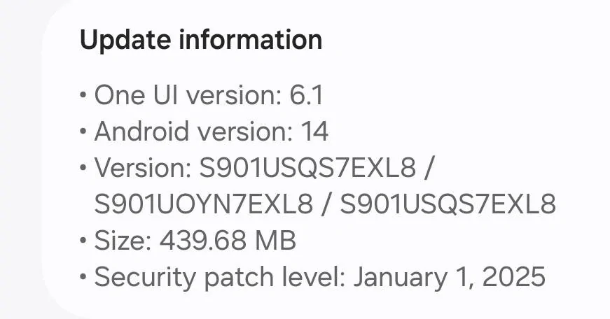

Jan 5 Google patch, or are you seeing an off-band patch? Can you screenshot your system updates screen?
Here's the S22 update that fixed PAAK and controls issue:
Ford Mustang Mach-E Fordpass - remote control functions not working Screenshot_20250131_135957_Software updat
