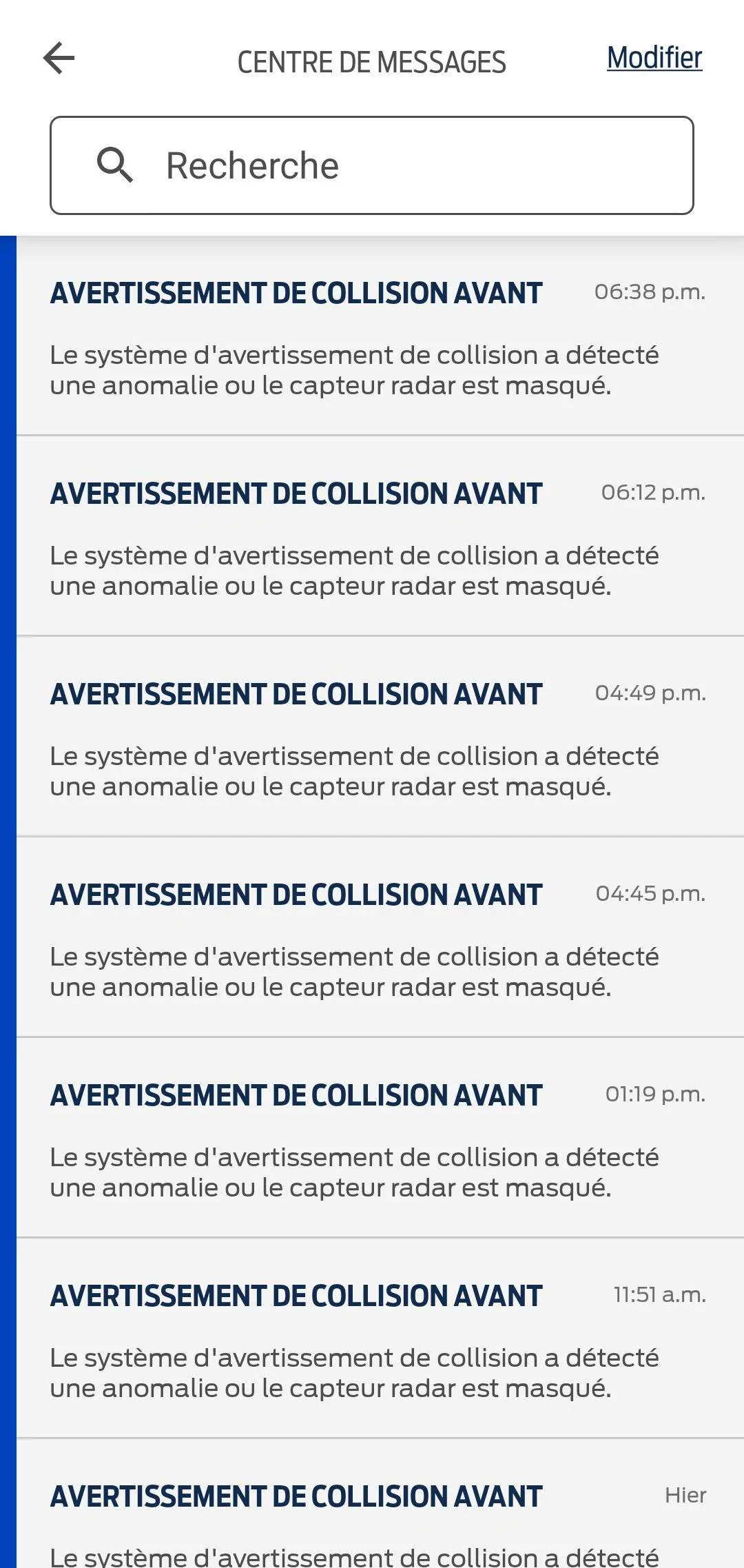

I visited my Ford dealer on Friday to book an appointment for that front camera fault. He insisted it's winter and it was only calcium on the parking sensors (they work fine) causing this problem. I insisted, he tried to shut me down by saying it was calcium and to just clean my car. He finally gave up and I have an appointment in two weeks... Your updates to the thread might save me a lot of time and frustration dealing with the dealer.
Ford Mustang Mach-E Front Camera Failure issue - Anyone else had this issue? Screenshot_20220226-234120_FordPass
I would certainly copy the post above about the service bulletin with the model numbers for the replacement module and show it to them. Otherwise you could be in for a long frustrating experience since your dealer doesn't seem like he is aware of the issue
