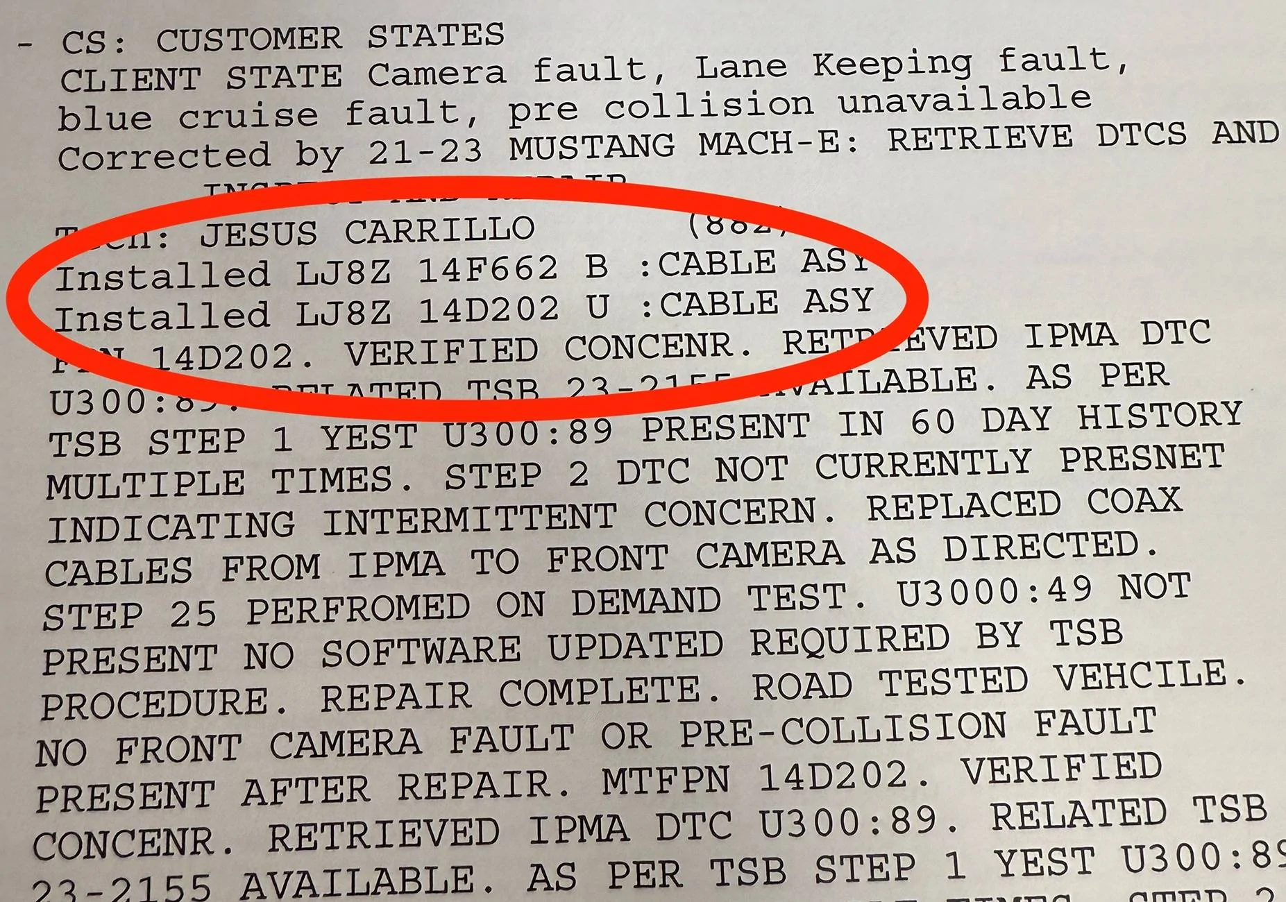

Like so many others, dealt with Camera Fault issues on our 2022 Mach E Premium. We had the car 2 years (but having racked up over 40K miles we were out of warranty). Was intermittent before crossing 36K, but infrequent and therefore nothing to "fix". By 39K it was consistent, and anything involving the front camera (Cruise Control, Headlights, Blue Cruise, Lane Assist, etc.) was non functioning.
Contacted the dealer in July (2024). $4000 to fix. I'm estimating, but a couple of inexpensive cables, $100 Camera, $2000+ IPMA, and 7 hours @ $180 labor. I was hopeful they could fix it without replacing the IPMA. They were able to prove (by looking back) we had intermittent problems while under warranty. But since we were past 36K, SOL.
Dealership opened a claim with Ford. Estimating again, we would pay $1000, Ford covers $3000. But we had to do the whole job. I insisted the IPMA was likely not the issue (it is the last step in the TSB after all, only if other steps weren't successful), that we were likely wasting $2000+. But was told the claim was for all of it, take it or leave it. So we bit, and they ordered the parts, and said they'd call us when the parts came in, expected in Aug.

Our one day fix lasted from Sept 23 until Oct 18. No joke. We didn't get a lot of clear answers as to what was going on, a lot of "its almost done we're on the last step". Something about "recalibration isn't working". We went over 2 weeks without an update. They did log like 150 miles on our car in that time. We were told someone from Ford had to come on site to finish the job.
Did that $2000 IPMA actually need to be replaced? We'll never know.
