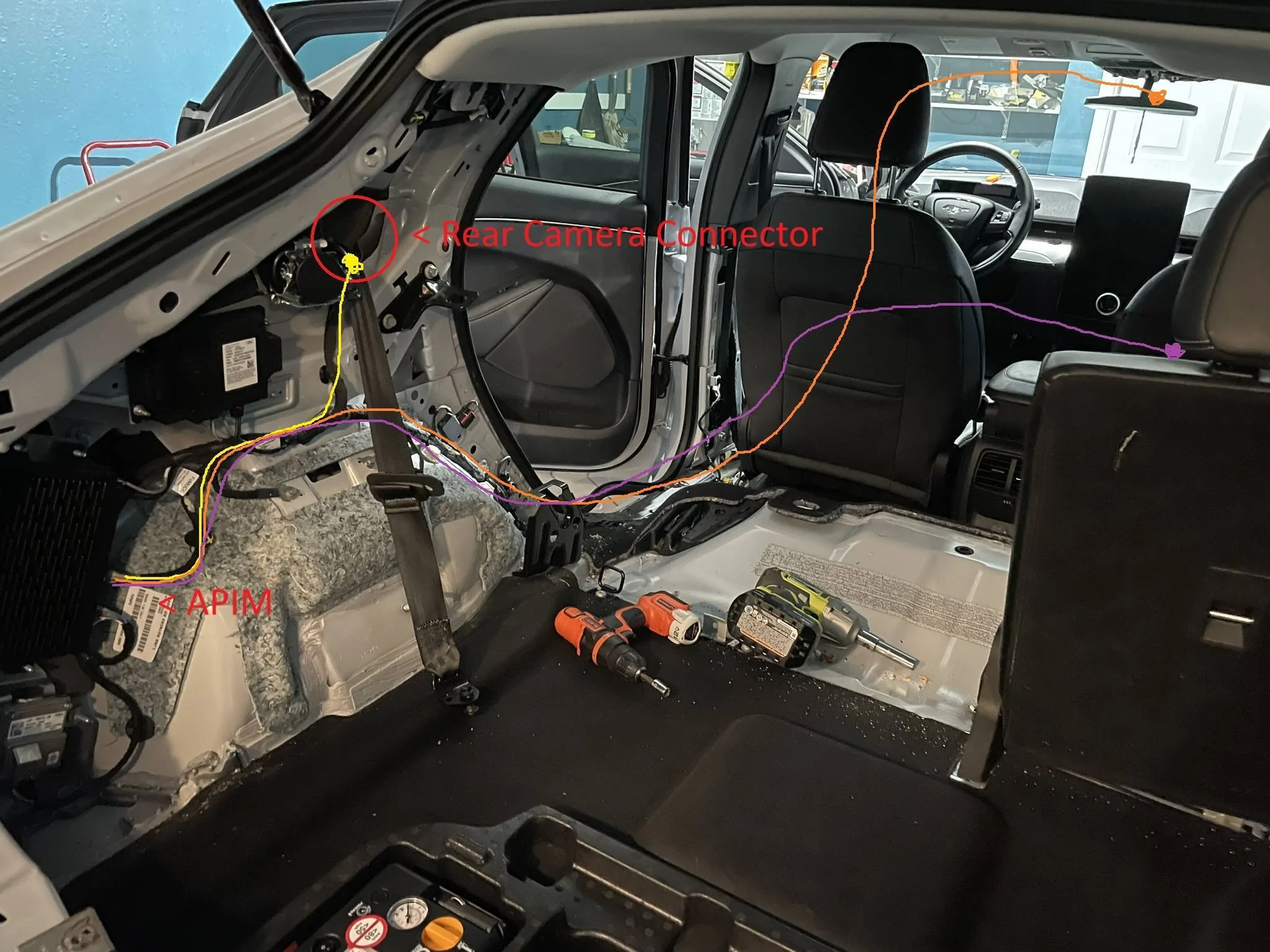

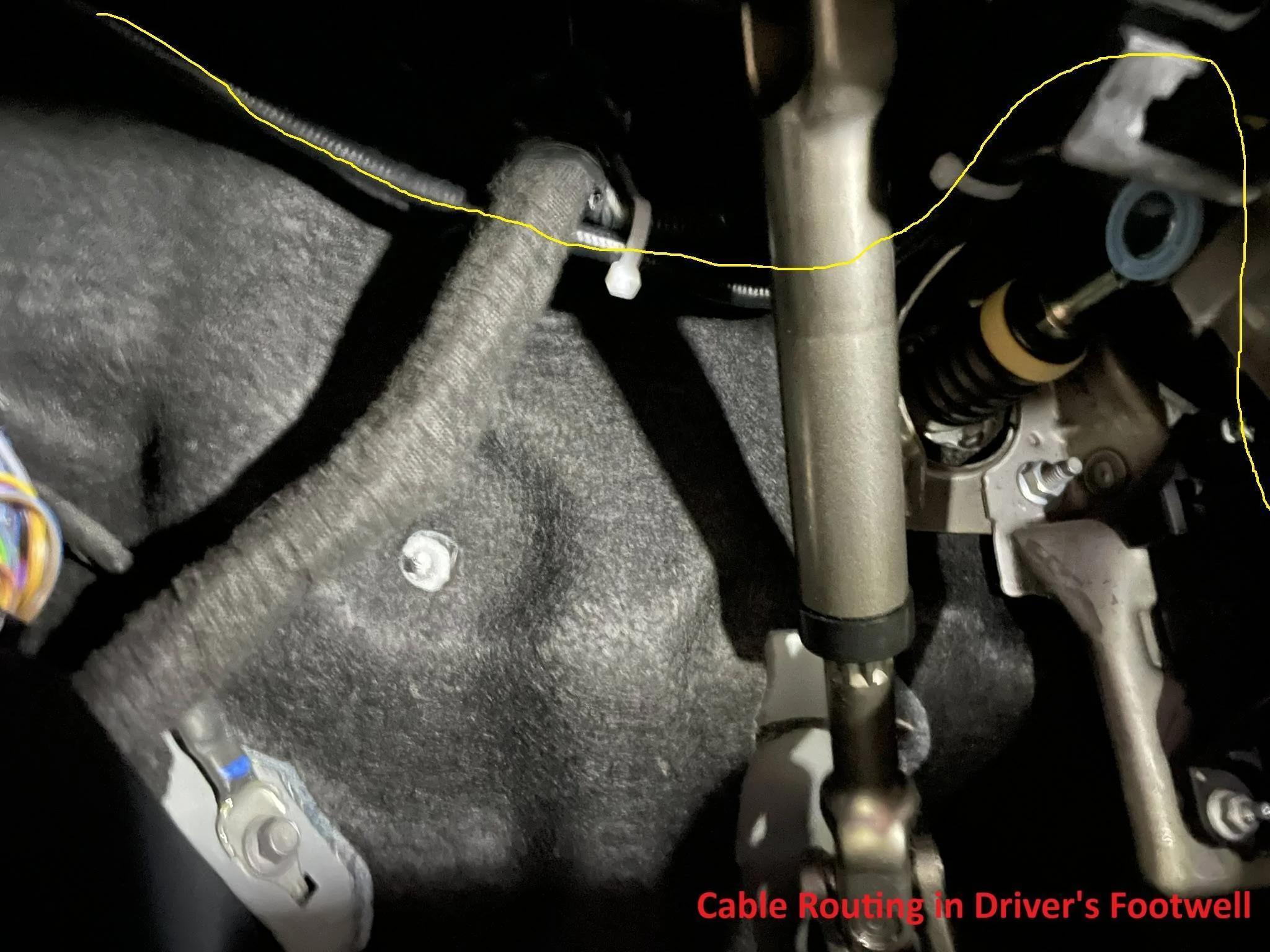

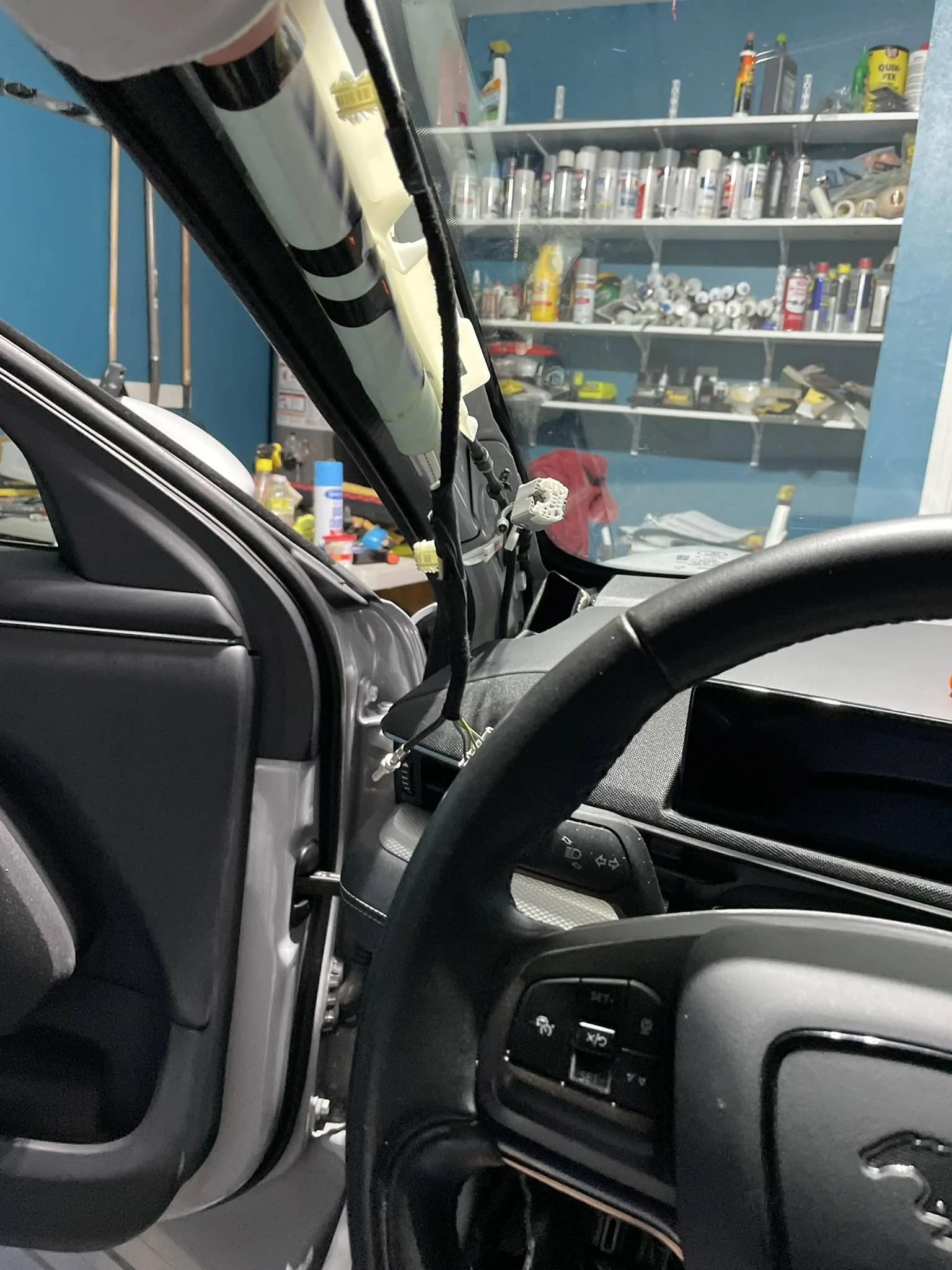

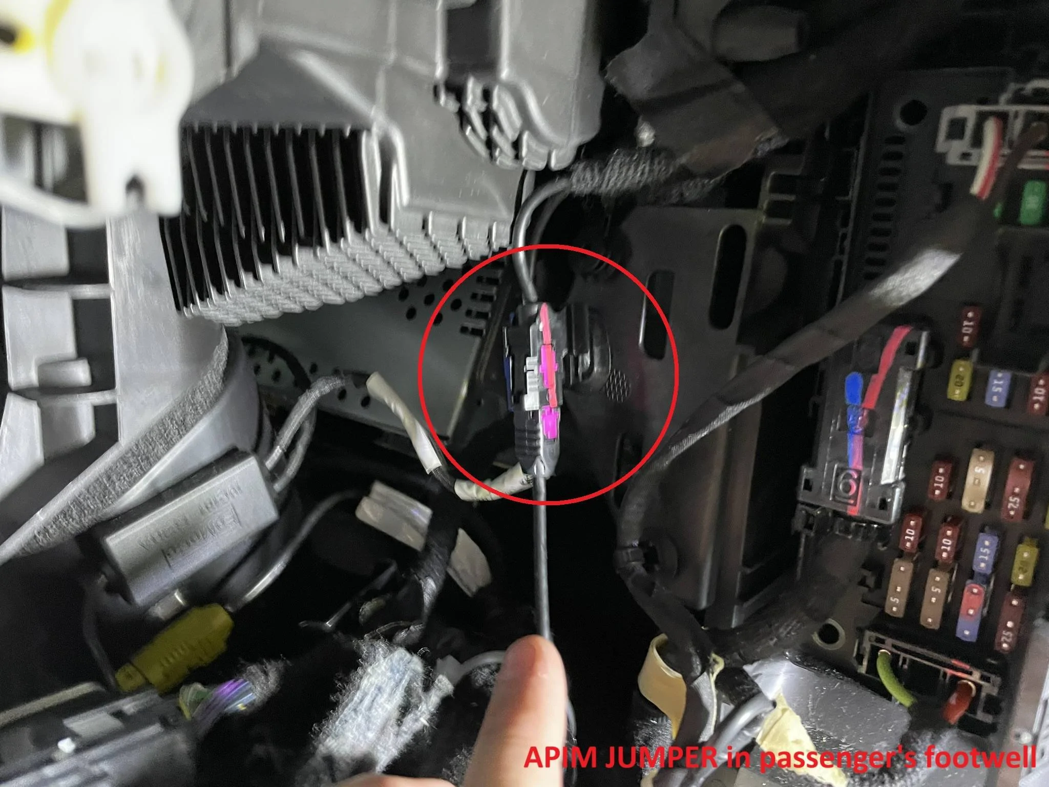

I made this post, I guess noone saw it:
Here is my post from the other thread:
I did it myself, by my observation, the original front camera cable is in a state of tension, and if you follow each of the cables they are subject to a number of sharp twists. Furthermore, the instructions indicate that only some cars will have the APIM jumper, but near as I can tell they all will since our car doesn't have BC yet still had the jumper. Also, I used split loom cables under the dash.
Here is a photo Dump:

Thank you so much for this. I had seen some of these pictures on a google search, but when I clicked it it said the thread wasn't there so I couldn't see any of the context.
From your images I have some questions.
1) The purple line in the one that shows the cable routes. Where exactly did you route that? It looks like that is going to the IPMA. If so, where exactly is the IPMA?
2) The orange wire it looks like runs along the ground instead of through the headliner. Would it be possible to run it through the roof and stay out of the A-pillar?

#1: this one:
Ford Mustang Mach-E TSB 23-2155 Camera Fix diy help 1727742081744-9
#2 that thought had occurred to me, you probably could, I figure, the reason they don't is due to the glass roof models. But keep in mind you'll need a way to keep the ends together, since normally the A-Pillar connector keeps them connected. You could probably connect the ends and put some heat shrink over them to keep them firmly connected.
