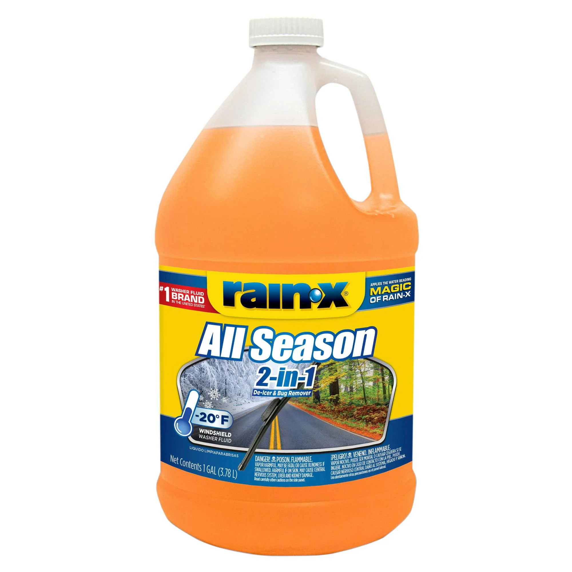

I use the orange rain-x haven't ever had an issue. Minnesota typically doesn't get lower than -20 though.

Purple Rain-X stuff rated to -30. I start using it around late October / early November so that by the time It really gets cold, all the summer stuff has gone through.

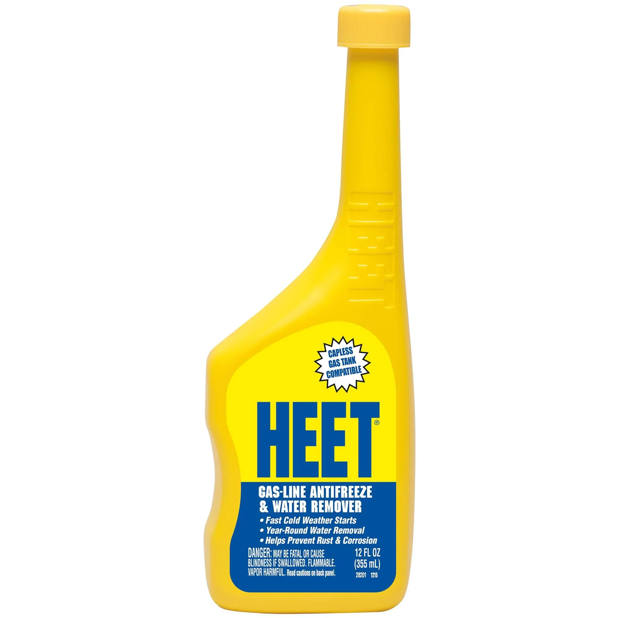

Every time I've had frozen washer fluid, it's because the dealer refilled it during the summer with non-freeze protected fluid. This is why I don't let dealers fill that anymore, I tape it shut. If you want to fix it, dump a bottle or two of yellow HEET (methanol) into the reservoir and fill it up with -20ºF fluid.
