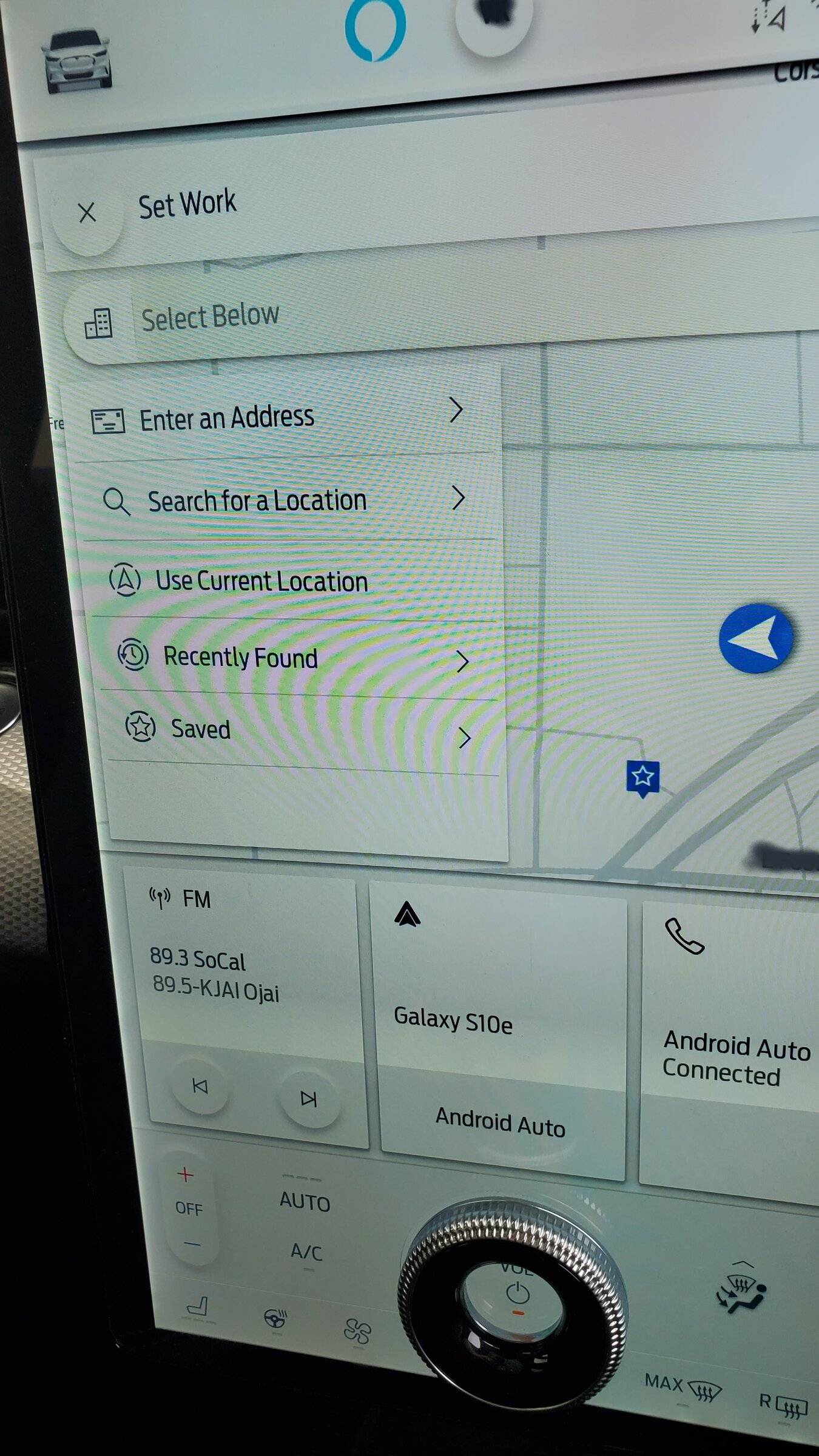

Here seems like a couple of glitches but may be I am missing something.
I want to navigate to work.
  1. I tap on destination field and it gets me to the destination selection
    Ford Mustang Mach-E Glitches! Glitches! Glitches! 20220527_084800
  2. In destination selection I tap Work and get to this screen
    Ford Mustang Mach-E Glitches! Glitches! Glitches! 20220527_084822
    which means I assume that I need to set the work address first.

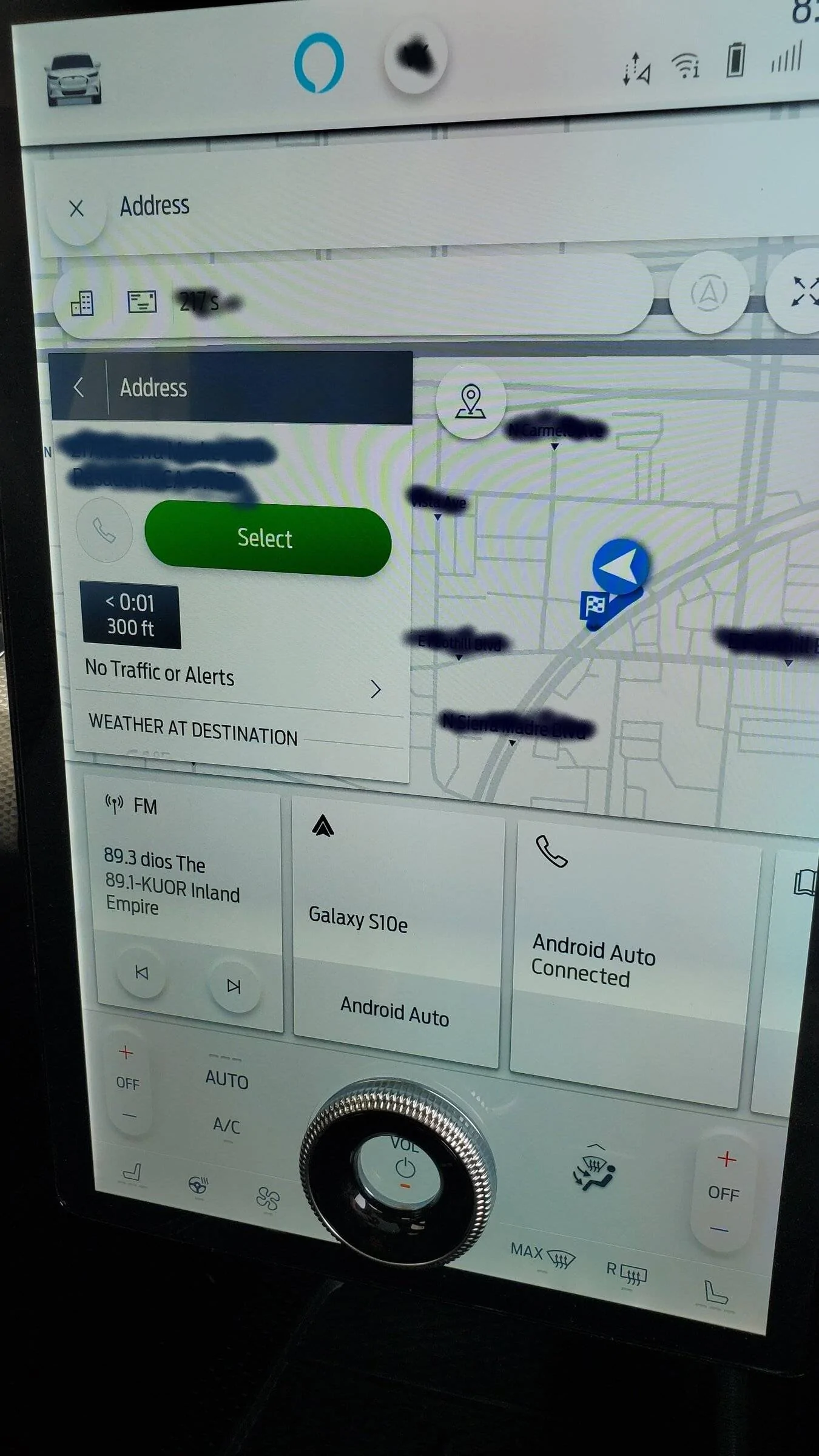

  3. I tap on Enter an Address and find the address i need. Then it get s me here
    Ford Mustang Mach-E Glitches! Glitches! Glitches! 20220527_084921

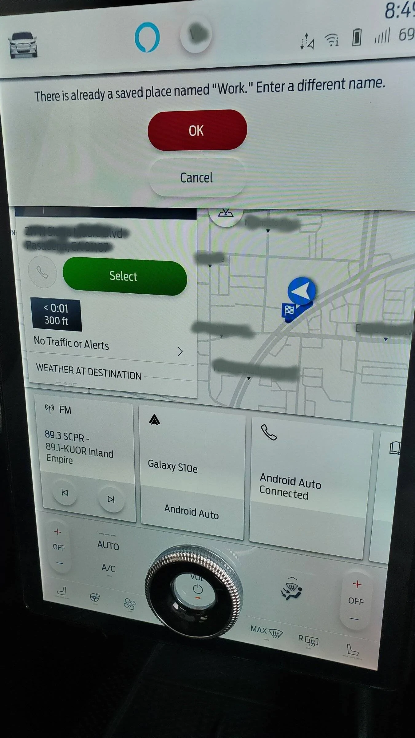

  4. I tap Select expecting that the Work address will be set. But instead I'm getting this
    Ford Mustang Mach-E Glitches! Glitches! Glitches! 20220527_084929
