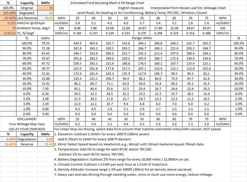

I made a spreadsheet to "do the math" and incorporate many factors, but the main thing I use is how the mileage drops with speed.
Ford Mustang Mach-E GoM broken in latest update MachE-ER-Range-100pc

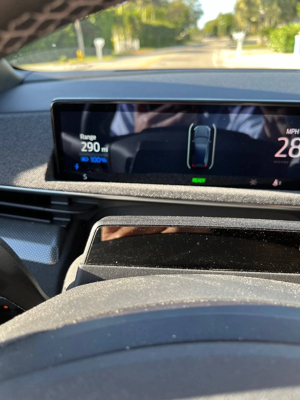

My car hasn’t had an update since last August. I’m in Florida (warm all the time) and my range at full charge varies from 230 to 290 miles. I drive the same area all the time too.
That’s a 26% variance without an update to blame.
I just think 6% is so small to point any fingers.
Ford Mustang Mach-E GoM broken in latest update IMG_0074
I would say that if your GOM keeps changing, driving history should be making an impact.
Yep. The GOM is not changing. It is defaulting to EPA range.
Except when it is cold. Then the range is less.
