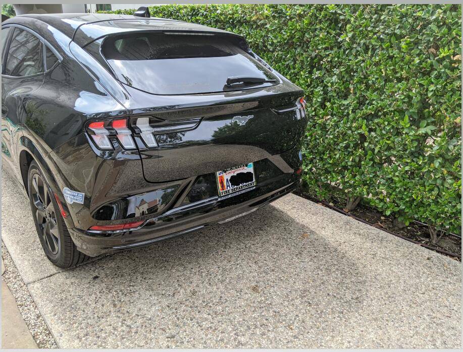

I have been driving my AWD Premium Extended Battery edition for a few months now.
We took a trip to the Southern California Mountains (near Arrowhead).
The many steep driveways created a common issue of the front bumper scraping (ouch). I did have the car loaded with two adults, luggage for the weekend and two large dogs (80 lbs +-)
I tried entering driveways at an angle and other navigation tricks from my days owning sports cars with low ground clearance. No luck.
So now my new Ford Mustang Mach E has a scratched up lower front bumper :-(
Best to all who love their cars as I do!
