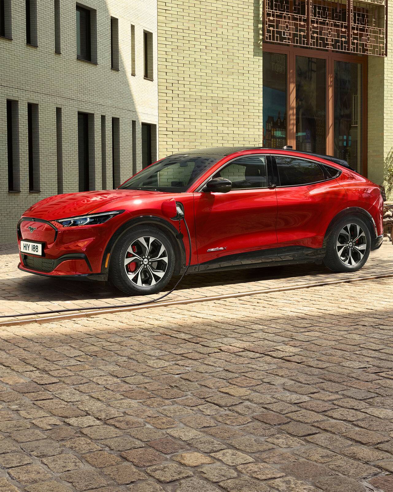

Is the second picture with it lowered? Or did they announce if there will be a lower kit?
if you hover over the picture you see the Name of the picture.
In theory those 3 are
- stock
- +35mm (compared to stock)
- -35mm (compared to stock)
I'll add soon realistic size tires on the lowered and the lifted version to see the final height and the final fit of the lowered version :)
