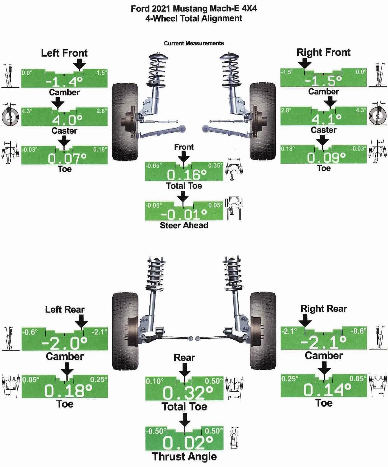

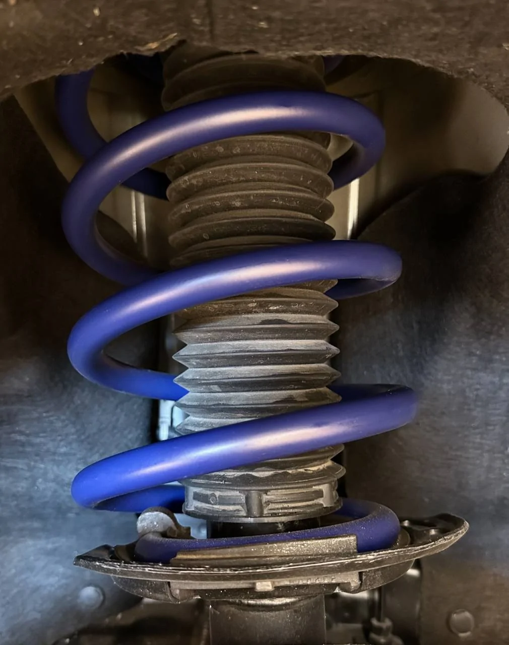

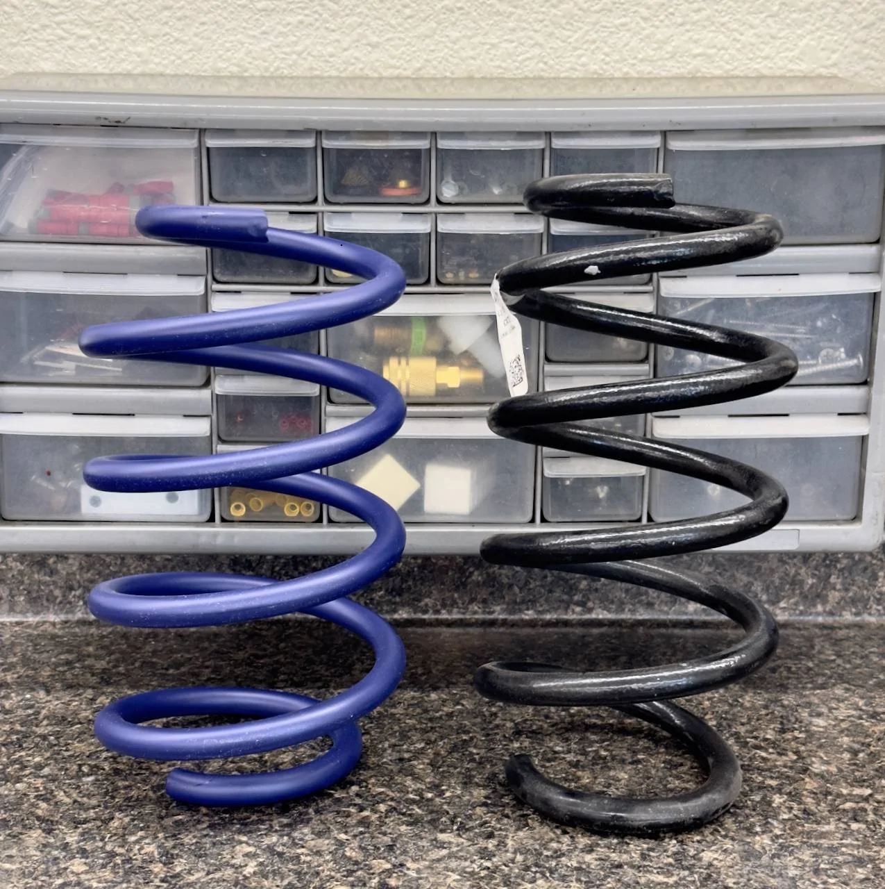

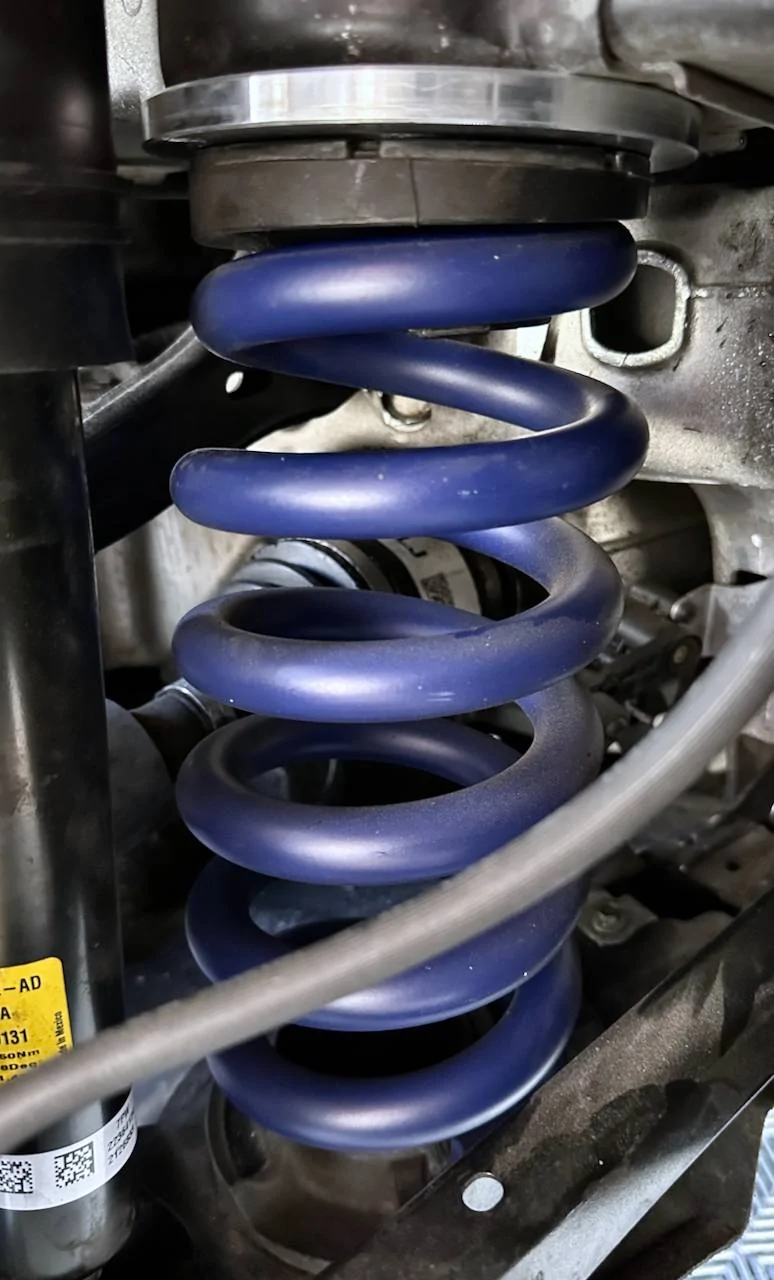

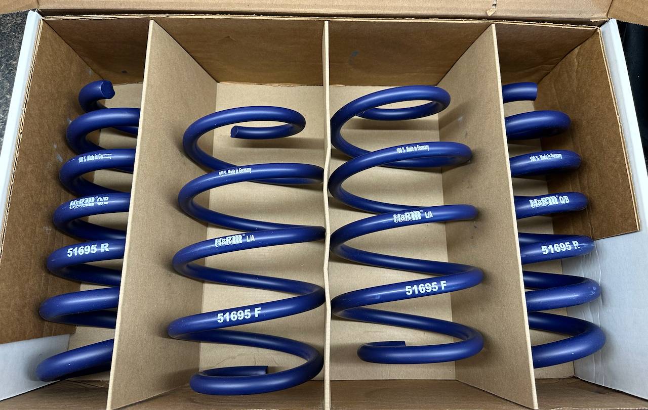

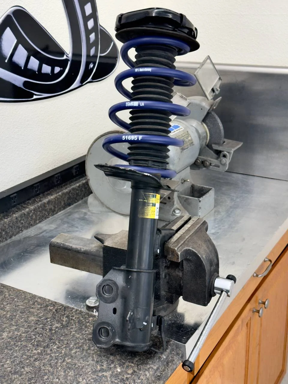

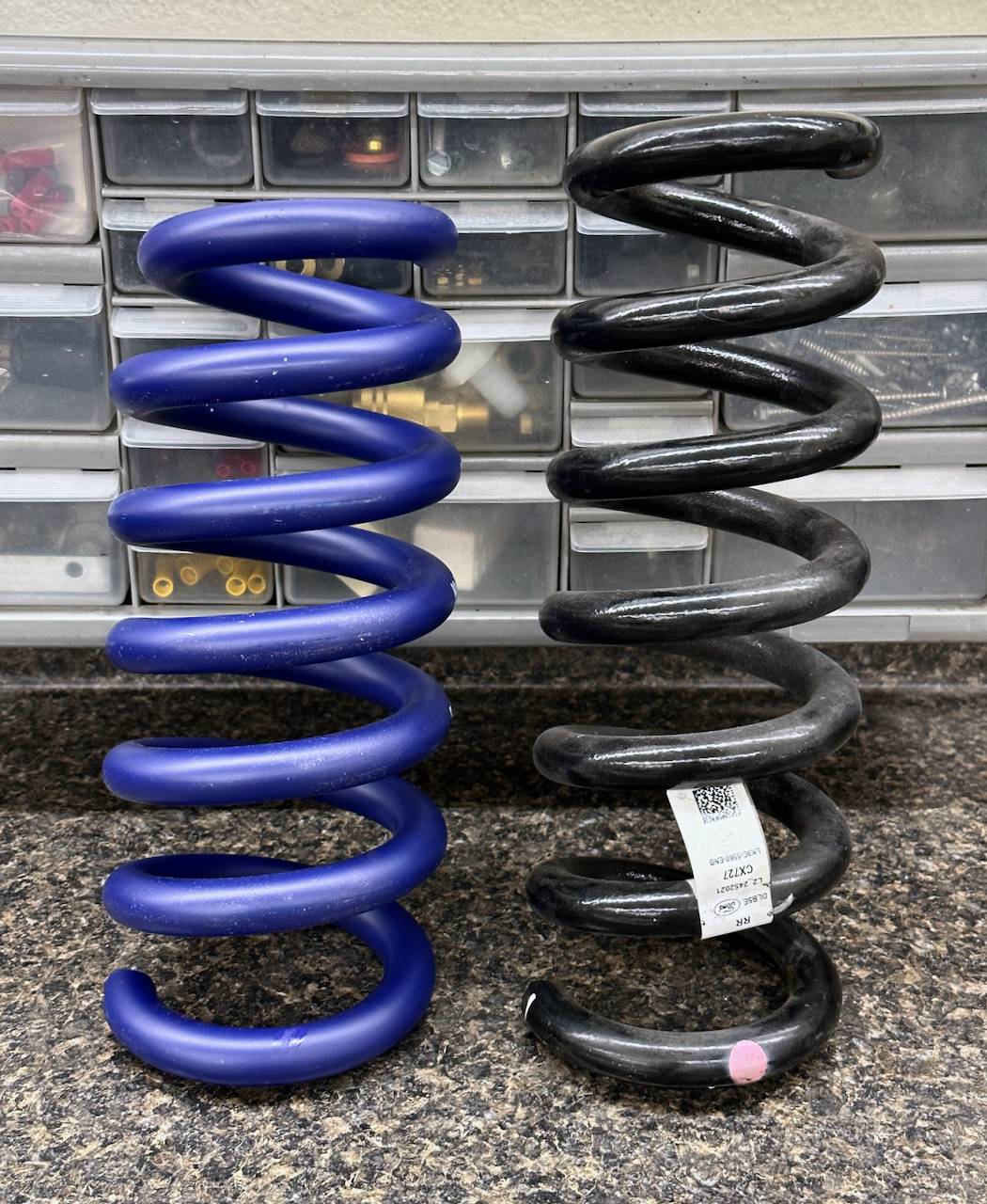

Had a couple of members ask what the H&R's look like next to the stock GT springs so here you go. They both have the same amount of coils but shorter with a slightly higher spring rate. The front springs are the same thickness and weight. The rear springs are 2.5mm thicker and weigh 2 lbs more each. These are the only photos I took of the install (not really much to show).
Also included my alignment specs. I always adjust the camber on my cars to -1.5 front and -2.0 rear because this is where I like the way it handles and it's not too aggressive for the street, at least for me. Just so happens on the Mach-E, this is the far end of the acceptable negative camber so I'm happy about this. After I put another 1500 miles or so on the car, I'll have it checked again to make sure it's ok in case the springs settle anymore but I doubt they will.
