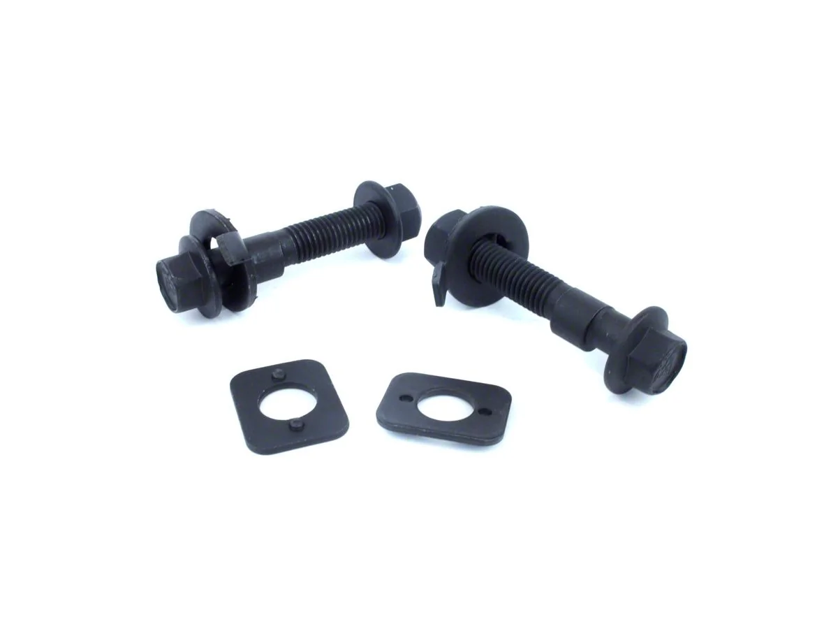

I knew you were going to ask me this and while I've replaced them on three Mach-E's now, I think they are 5/8" bolts, 3" long. I have some extras at home but I'm traveling today and won't get back until later tonight. I can make sure and get back to you then. I used grade 8 bolts, I know that. I do believe the Mach-E uses the same bolt size as the S550 Mustangs ('15+). I replaced the ones on my 2020 Mustang and pretty sure they were the same.@markboris do you know what diameter the bolt is that connects the strut to the knuckle?

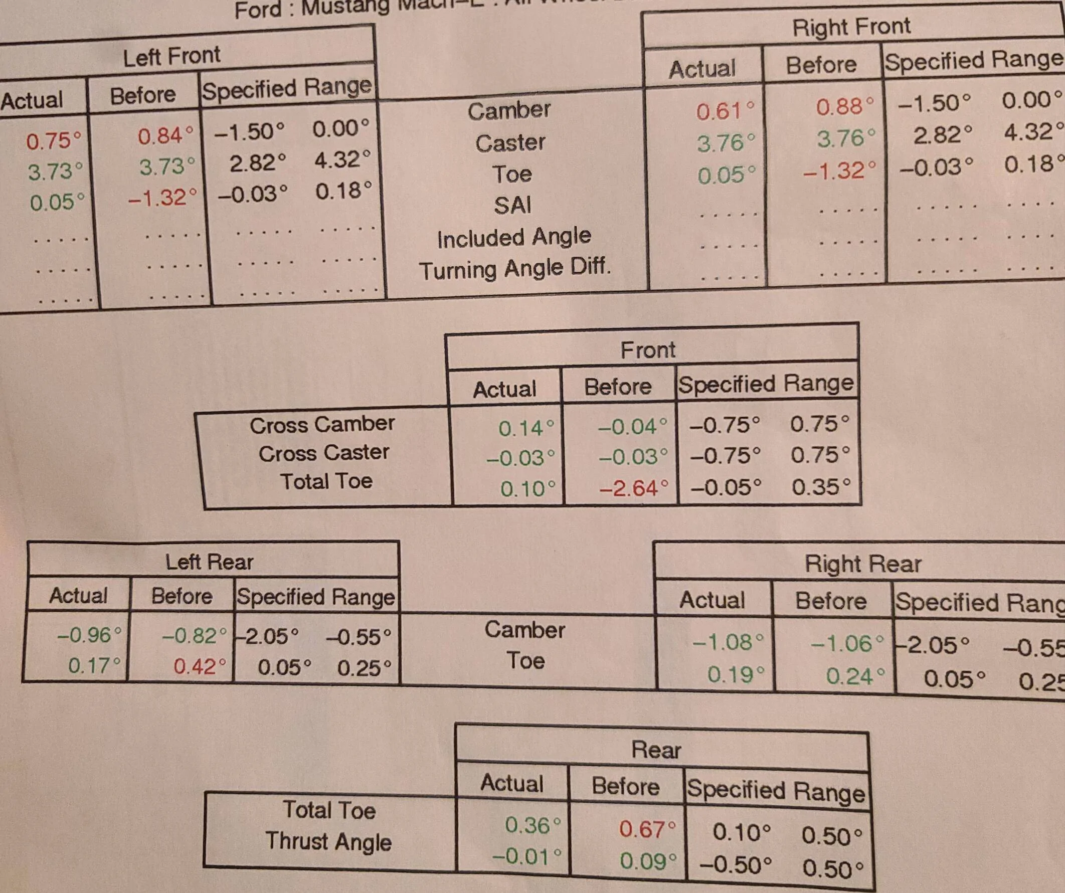

Someone said the Mach e may use the same bolt as a 2015+ mustang. If this is true they make special camber bolts that will help correct my alignment.
