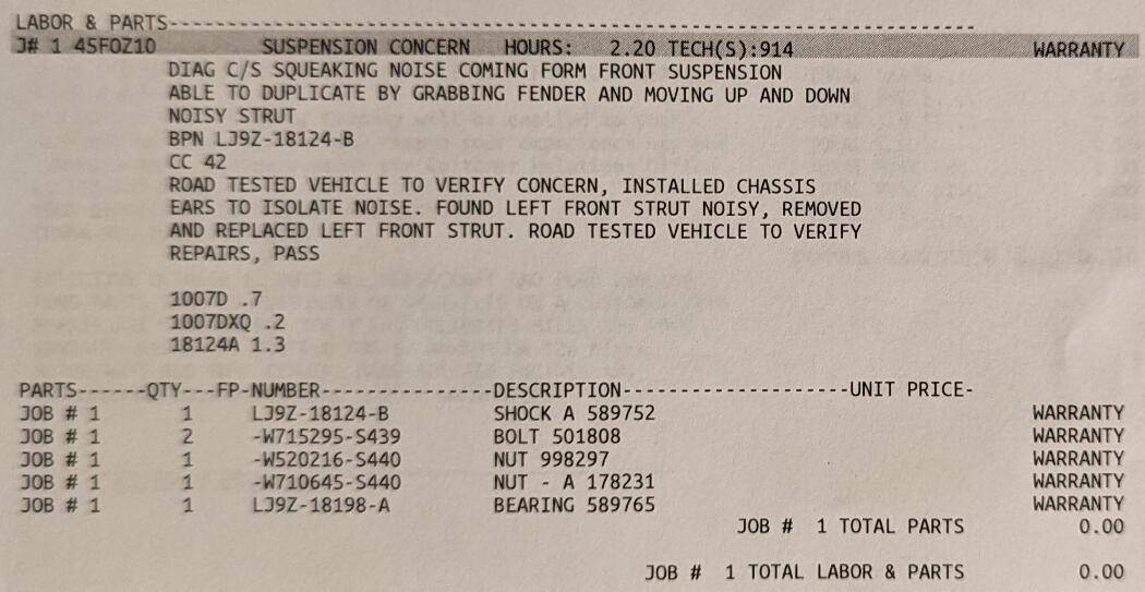

In case it's helpful to anyone else:
Ford Mustang Mach-E Squeaky Mach-E Suspension 1717448628163-w4

Nice that it is resolved. What are “chassis ears”? My MME is making an odd noise that I posted about recently so I was wondering if that was some technique they use to pinpoint the location of a noise.

Maybe so. I didn't even notice that.
