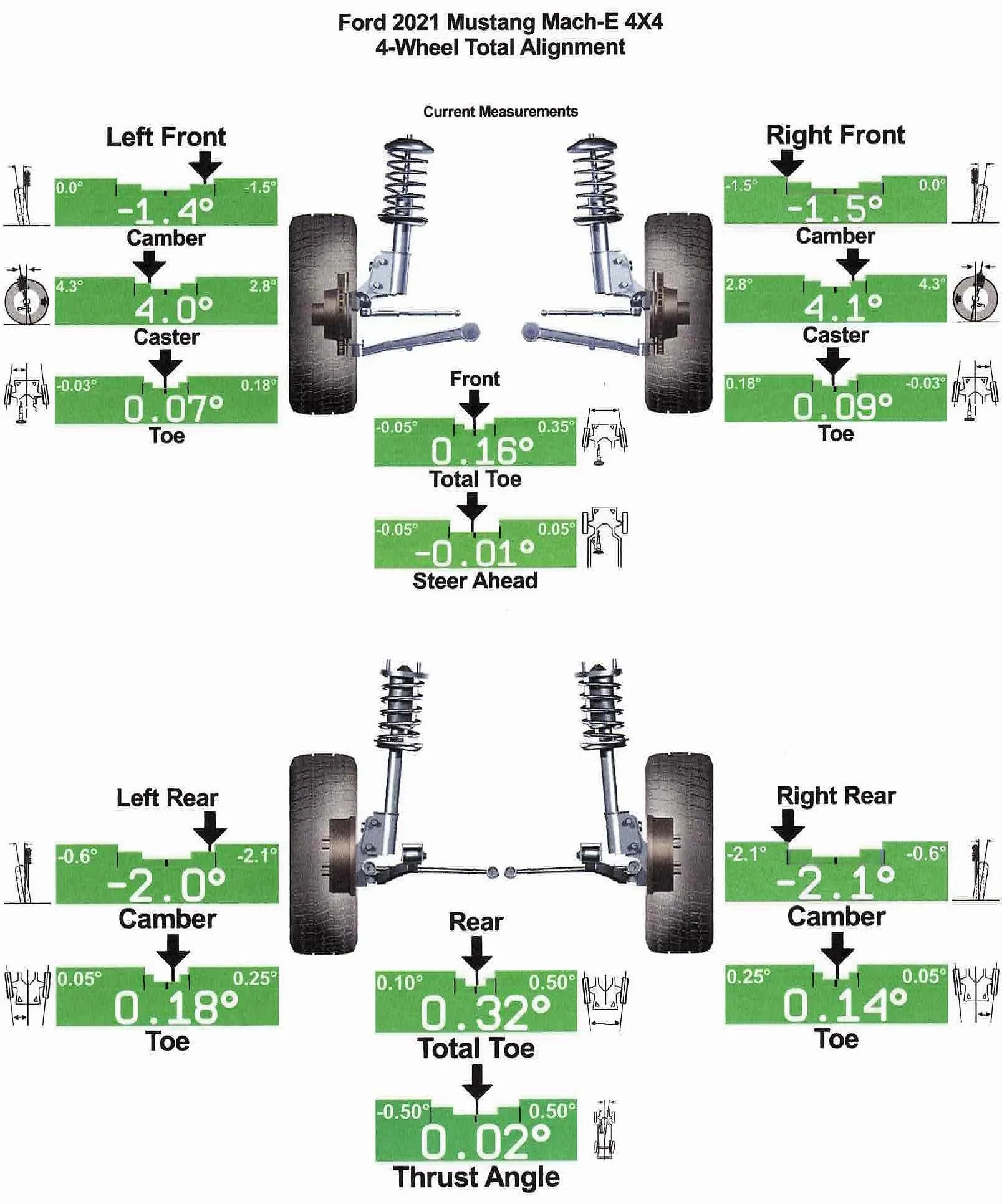

Mark,
Here is the rack sheet.

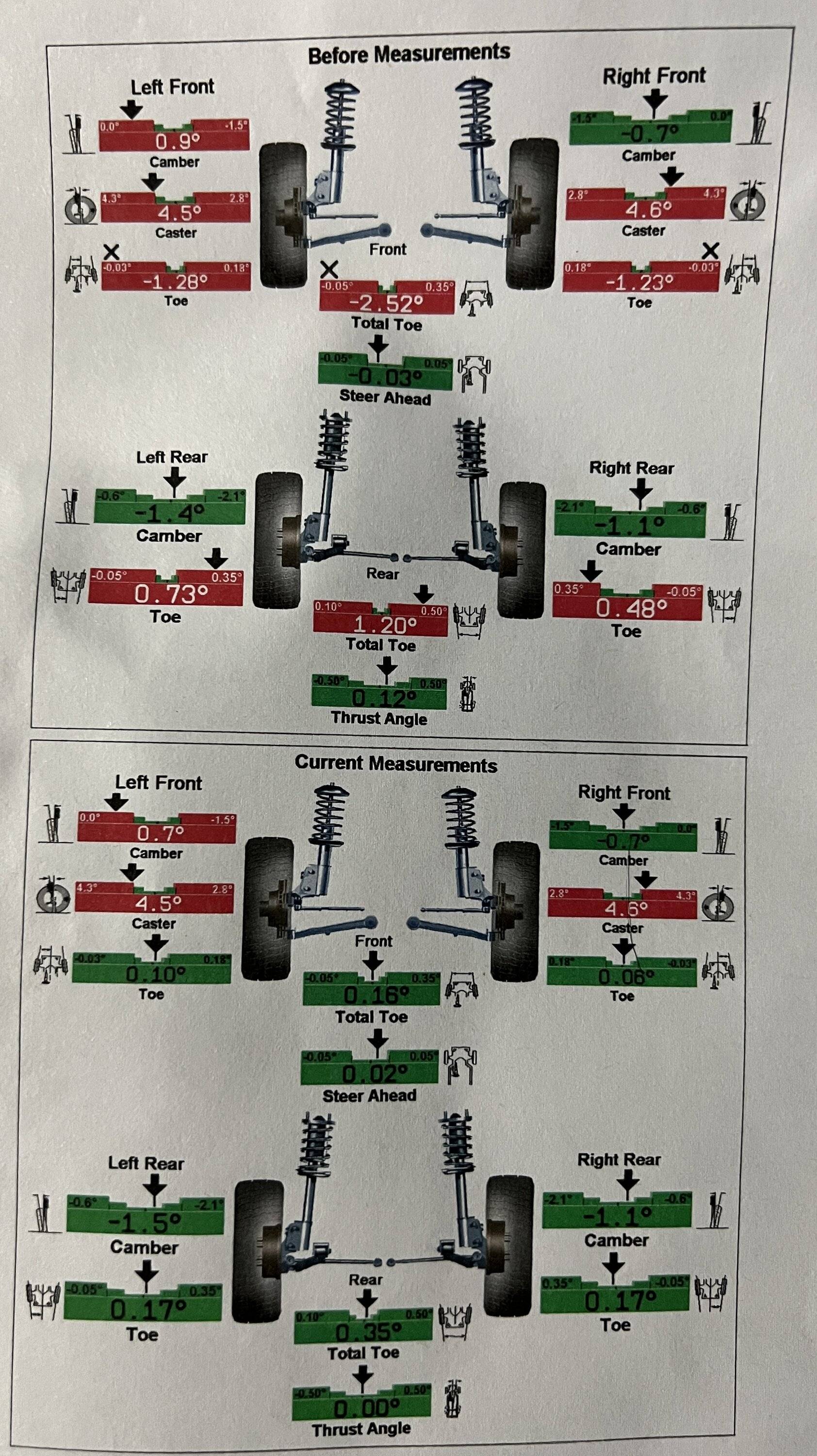

Sorry Randy, I thought you were looking for a specific amount of camber, not that you were having issues with it. You can adjust the front camber somewhat but your left side is out quite a bit. Once you get the camber close, the caster will be more inline.
For now you need to remove and discard the two large bolts (and nuts) that hold on the lower part of the strut to the wheel knuckle. They are splined bolts and you replace them with non-splined ones. I don't remember the size off hand but can get you that info if you want. This will allow you to gain a little more negative camber but only about -.5 which won't help you much on the left front. In other cars, I have also enlarged the holes that the upper strut mount bolts up to to gain another -.5 camber. Didn't have to do that in the Mach-E though. Just replacing the splined bolts got me to the negative camber I wanted. I checked with Ground Control Suspension Systems as I have used their adjustable camber plates before but they don't have any for the Mach-E at this time. Hopefully there is a company that does or will soon.
I generally like to run around -1.5 up front and -2 in the rear.
This is my rack sheet

I don’t have the KW kit, only the Magneride suspension. However no matter what suspension the Mach-E has, the alignment specs are all the same. I would think the KW kit should fall within those specs too once installed. Want to mention that the standard and magneride struts/shocks are all the same size, configuration, mounting, etc. There is no difference between them except the way they work internally.
That said, installing the KW kit on any Mach-E including the GTPE should yield the same alignment specs.

@markboris do you know what diameter the bolt is that connects the strut to the knuckle?
Someone said the Mach e may use the same bolt as a 2015+ mustang. If this is true they make special camber bolts that will help correct my alignment.
