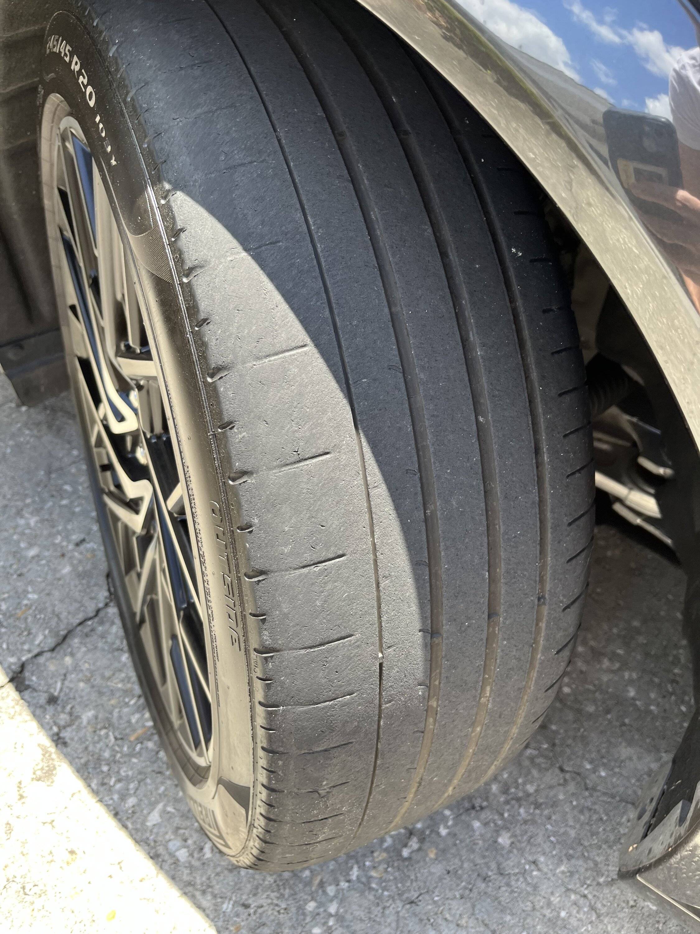

Fair warning- it may also impact your tire wear.
I have been at 36 psi since new and the outer tread is significantly more worn than my middle tread on my tires.
This is around 6-7k miles on my tires:
For the OP, there are a bunch of threads on the topic, but the bottom line is there isn’t a ton you can do. Our suspension doesn’t have enough travel for a soft ride.
The Mag ride on the GTPE is better, but will never ride like a luxury car. It’s a a mustang after all.
Whoa, those are some slicks ;) . I've only been running my tires at the lower pressure for about a week now, but at 20K miles at the higher pressure, my factory tires still have > 8/32" tread depth. I guess I need to drive my car a bit more spirited.
