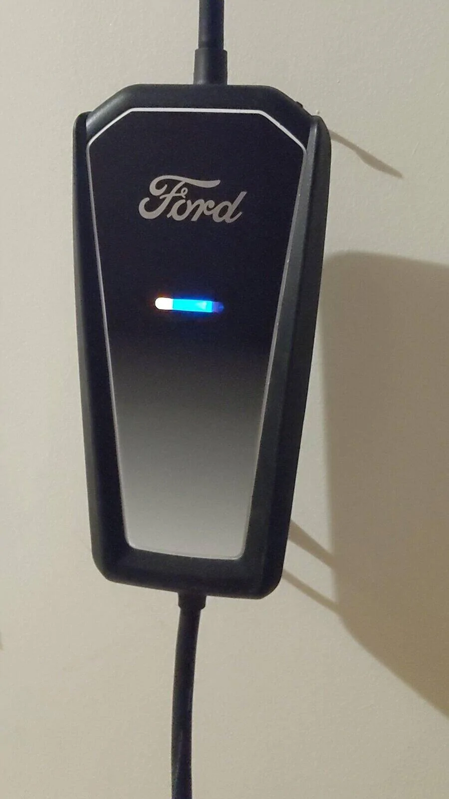

I have started to get the Amber light coming on when charging the vehicle. During this time the charge rate is drastically reduced. What was normally a 4-hour charge is now showing closer to 7 hours.
I found the picture below from another forum post and this is what I have going on.
Ford Mustang Mach-E Help - Ford Mobile Charger Amber Light. 1650334046822
The Questions…
  • First can I continue to charge the car with this light on, is there any danger? While it is not ideal it is better than no charge.
  • What can I do to fix the problem? Do I need another mobile charger from Ford?
  • Can you please recommend a home charging station that will take my installed 14-50 NEMA 50 amp with the ground plug at the top. Ideally one I can simply plug in and will not required another electrical visit.
Thank you for helping me on the EV journey.

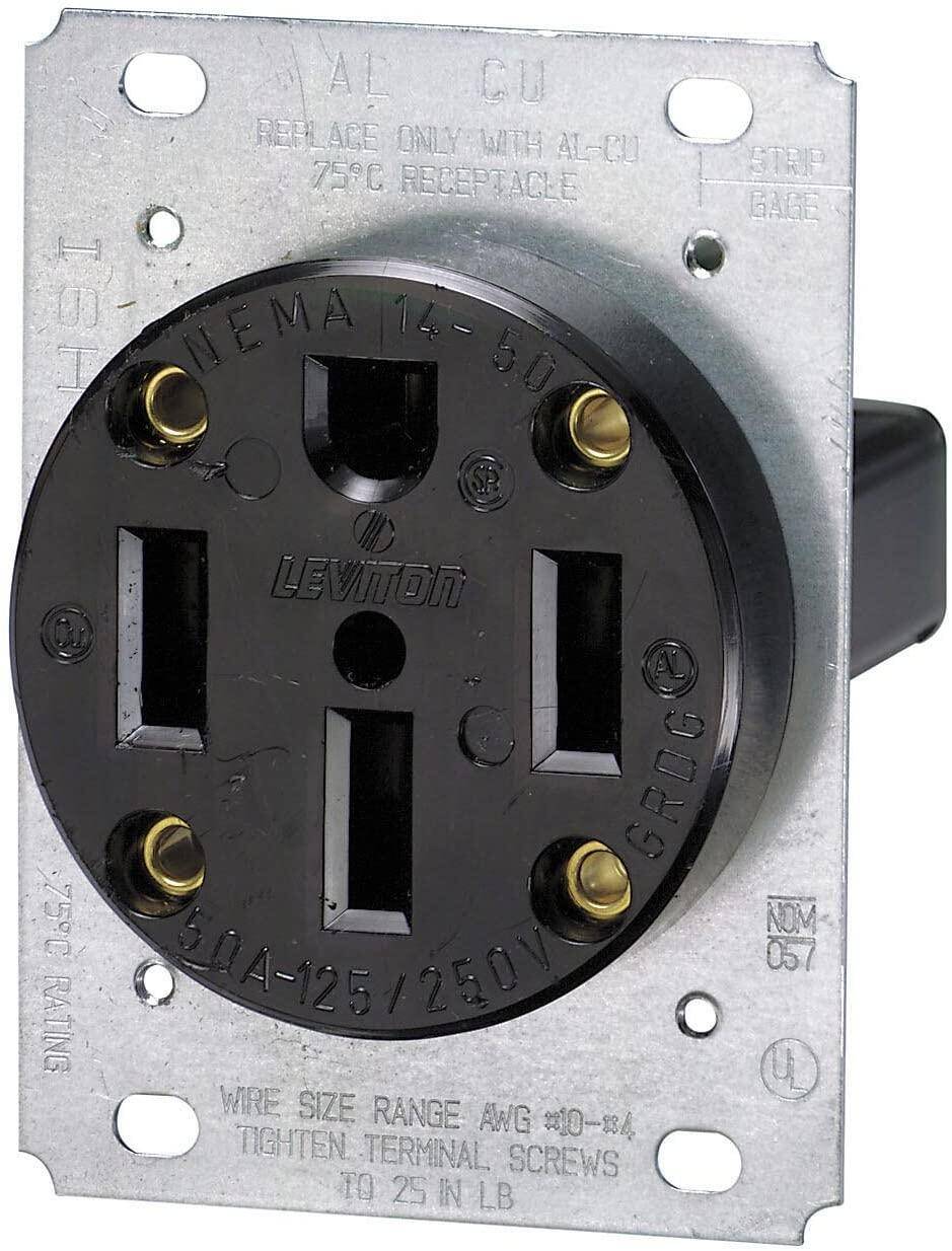

Everything I have seen said you should use the Hubble instead of the Leviton.
