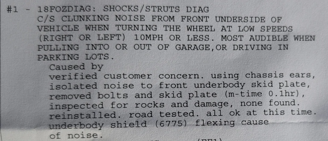

Just got the car back from the dealer, they said the noise was due to the "front underbody skid plate."
Ford Mustang Mach-E Help maintenance issue - noise & mechanical bump front wheels 1775694167835-mr
The noise no longer reproduces after they reinstalled the skid plate, but I'm suspect of whether this is a durable fix since this was the same outcome as my last visit.

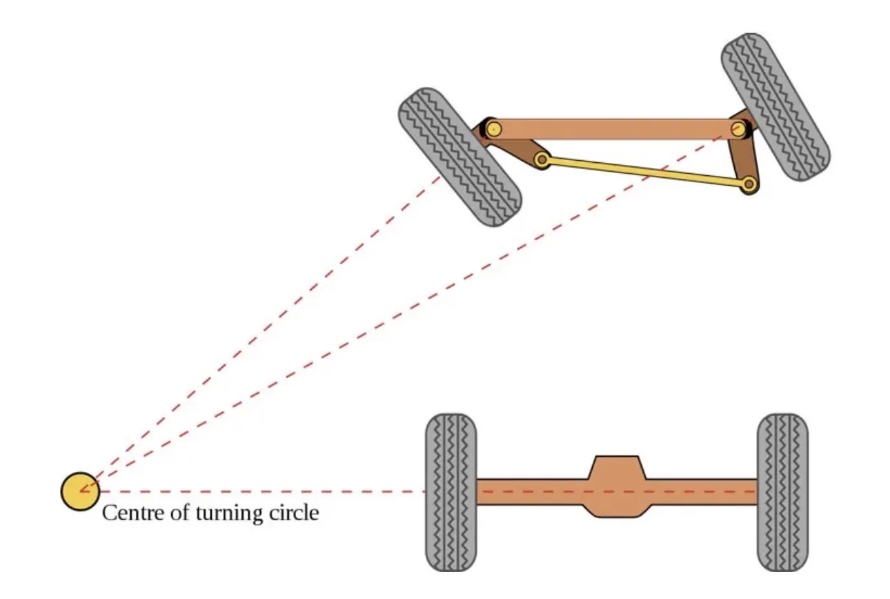

It’s probably the correction of the tyre slip angles on the steered axle when on full lock.
Steering linkage design is such that the front wheels can be kept aligned with the centre of turn up to a point beyond which the wheels become less and less aligned with CoT as steering is turned further.
You hear this sound & feel the jumping when driving slowly because, by definition, you’d only be driving slowly at near to full lock.
If the tyres you have are less grippy you’d hear & experience it less because they’ll slip/slide gradually maintaining alignment with steered path of the wheels, grippier tyres grip the road surface better so increasing the angle between the steered path of tyre & wheel until the tyres effectively jump as they lose and regain grip between ground in the correction of this difference.
You could have the 4-wheel alignment & general condition checked to ensure there’s no other cause to be on safe side.

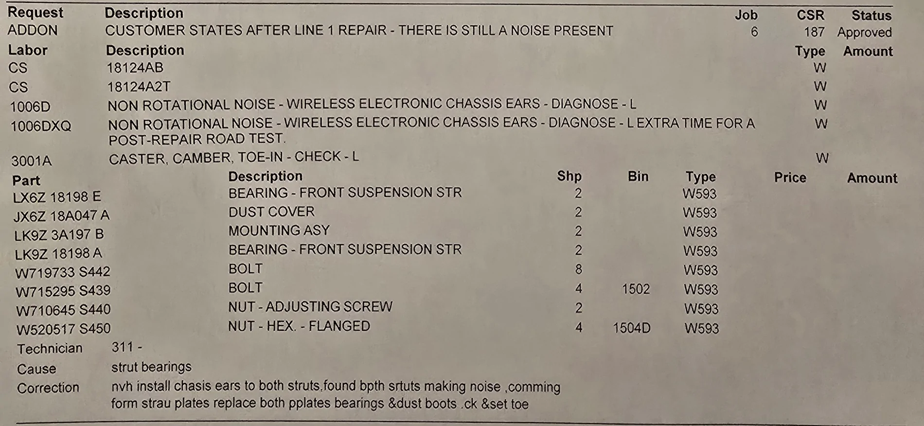

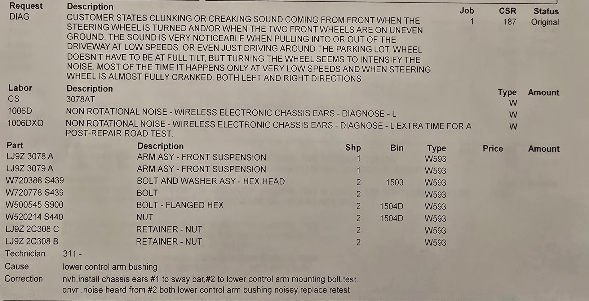

The dealer fixed the noise by first replacing the control arms and then the strut bearings. I haven't heard the noise so far.
