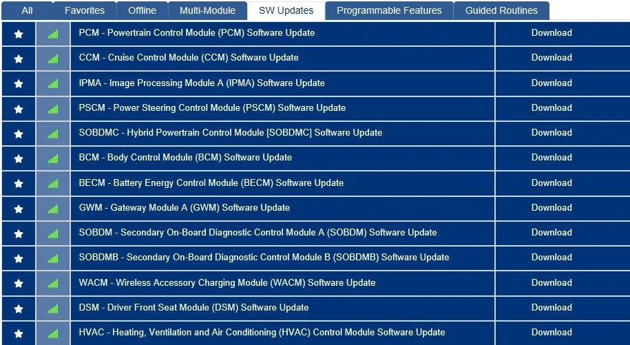

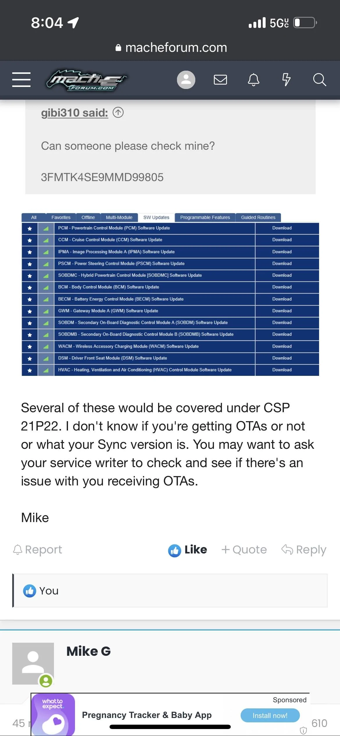

Anyone in SoCal with FDRS and know what they’re doing willing to help me out and get the updates? Dealership isn’t much help. They keep telling me my car isn’t eligible for upgrades but another member (@Mike G) already checked this for me.
I haven’t received a single update since I purchased the car in September so I’m guessing my OTA updates are stuck.
Willing to pay for the service, help out with a license, and bring some drinks to pass some time.

Job 2’s have not had any OTA’s other than blue cruise map update in February. You aren’t stuck, you are just waiting for our turn. If you don’t want to wait then you can go the FDRS route or have the dealership do 21p22.

The dealer has about half of the updates available for the GT if they hook up your car. They don't authorize doing them all. But with this new recall coming, I don't see much attention going to normal OTA updates until the recall is addressed now.

All the above tracks with my multiple convos with several dealer service mgrs here in SoCal. Only the BC update for GTs is available-- and when you ask them to "force" an update, it's an 8+ hour affair with no garuntee that it will work. They will also charge you for it. I'm not willing to do this manually & will (patiently) await the official OTA or a notice from the dealer that they are ready/able to do this for me @ n/c.
