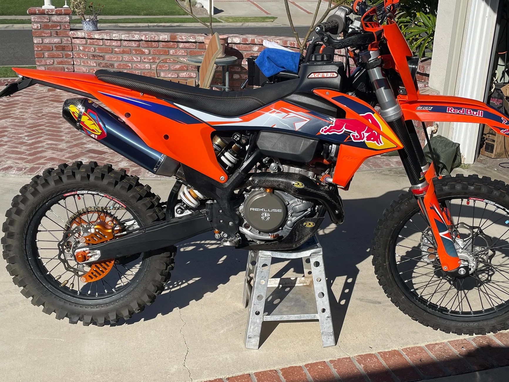

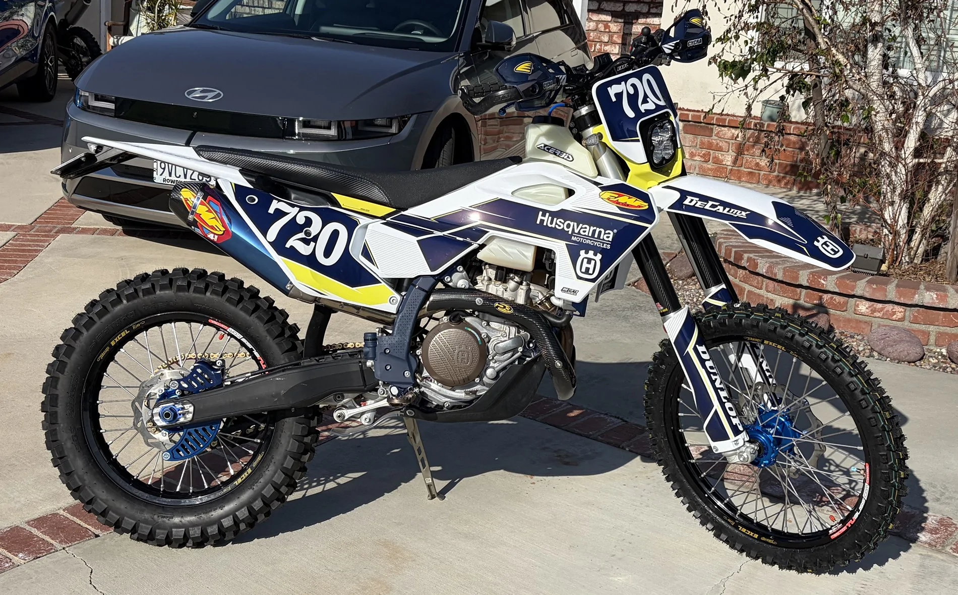

I'll bring my helmet as well, need to be fully protected. :wink:
You mentioned the spring rates were changed on the 25's but the overall length? I don't recall if we took a picture of the 2 springs side by side. From what I recall, which isn't as accurate as it's been in the past :crazy: , I thought the OEM's were smaller. I'm only familiar with dirt bike suspension (I just changed the fork seals and went up 2 spring rates over the weekend on my new Husky). I wonder what the spring rates are between the 2025 OEM and the Rally's and how the length differences plays into the overall change
Ford Mustang Mach-E Mechanic Recs in SoCal (Ventura County) KTM
Ford Mustang Mach-E Mechanic Recs in SoCal (Ventura County) HUsky
