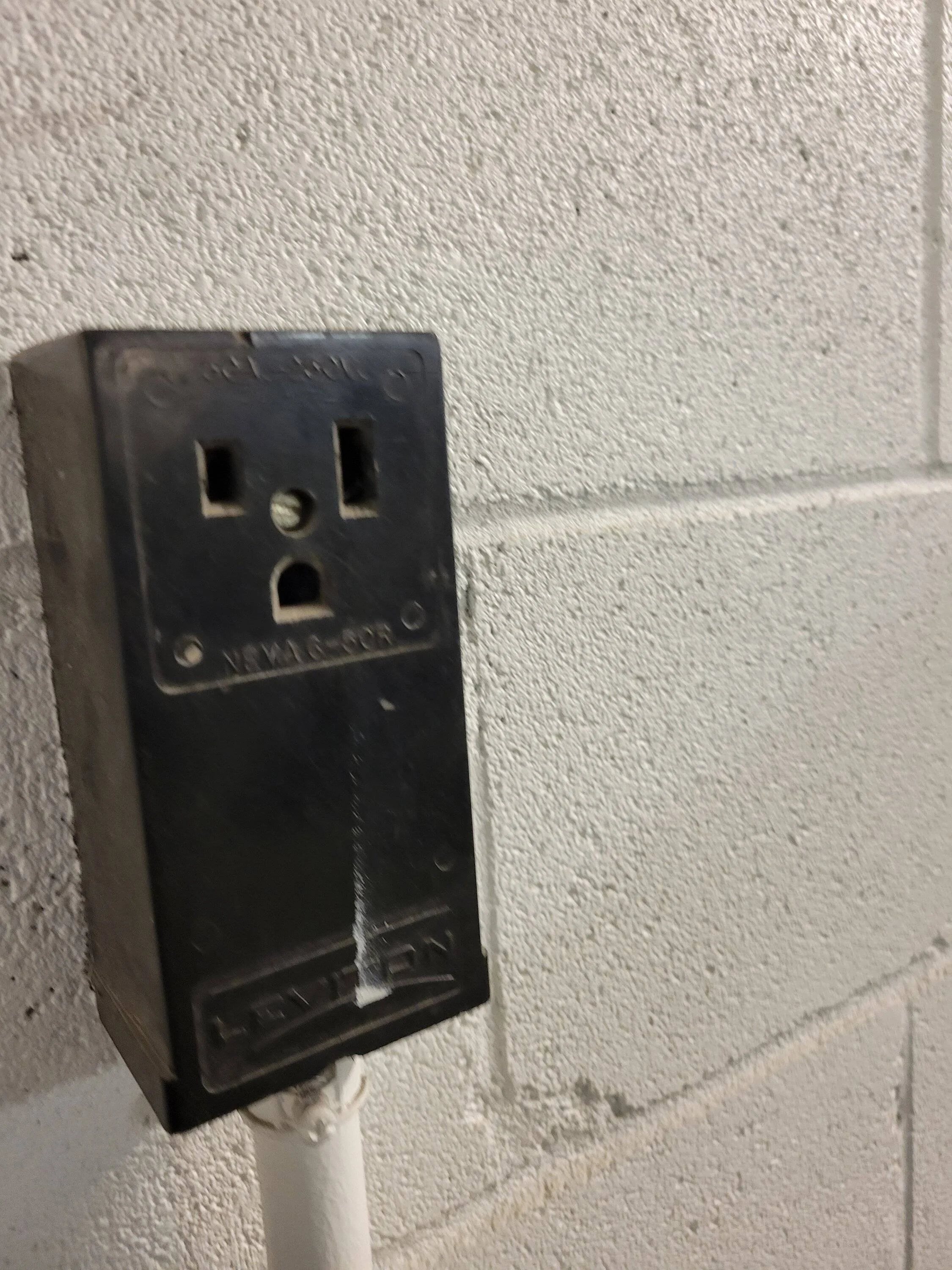

I am traveling and happened to carry the mobile charger. The hotel has this wall plug. Would this work to charge the MME?
Thanks.

No. You need a 14-50 outlet. You could also use this converter, but YMMV.

Since he is already there, adapter may not be feasible.

With a 6-50P to 14-50R adapter that outlet would work great. Is there a camper store/dealer nearby? They would probably have the needed adapter in stock.

Gotcha. I will check for adapter availability. The plug is in the hotel garage with restricted entry so should be otherwise safe.

That looks like a 5-15 receptacle so it should work fine. It will be 120v (Level 1) so don't expect more than about 3 miles of range added per hour. Better than nothing though....
I suppose it could be 240v.....if so, then your 120v plug won't fit anyway. Kinda hard to tell from the picture. Might be 6-50 I suppose...

Yes, I carry a 6-50 to 14-50 adapter in my car for those. Outlet is upside down so the cord will be a bit of a pain.
