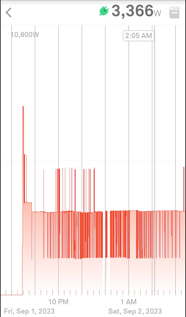

I know that there are issues with the Travel Charger. I am one of the affected. I have my charging circuit on a dedicated monitor that supposedly samples 1M times per second (although it only records second-by-second). My Emporia charger, on the same circuit, has no problem consistently delivering the full capacity.
I used my travel charger very frequently early on. It was producing 7kW+ relatively consistently. Over time, it degraded to where it would rarely allow the 7.6kW max. The amber/red/orange light comes on the charger when it is not able to allow the full output. Here is what it has been doing recently (the peak at the beginning is about 7.5kW):
(it is interesting that it seems to "step" up and down)
The average power it produces (this does include pre-conditioning, so presume charging is a little higher) is about 2.4kW:
I have taken it to the dealer twice and the first time, they thought it was something wrong with the car, as I was having my HBJV replaced at the time, and said to check back if it is still happening. Took it home, plugged it in - 5 minutes later, orange light. Called them, they said I would have to leave the car and charger with them to test.
Had the car in for something else yesterday, asked them to test the charger. They stated that they are unable to replicate the issue and that I need to have the circuit in my home tested by a qualified electrician. Not to go into details, but the circuit has been thoroughly tested and there is absolutely nothing wrong with it. Again, no issues using an Emporia charger on the same circuit.
