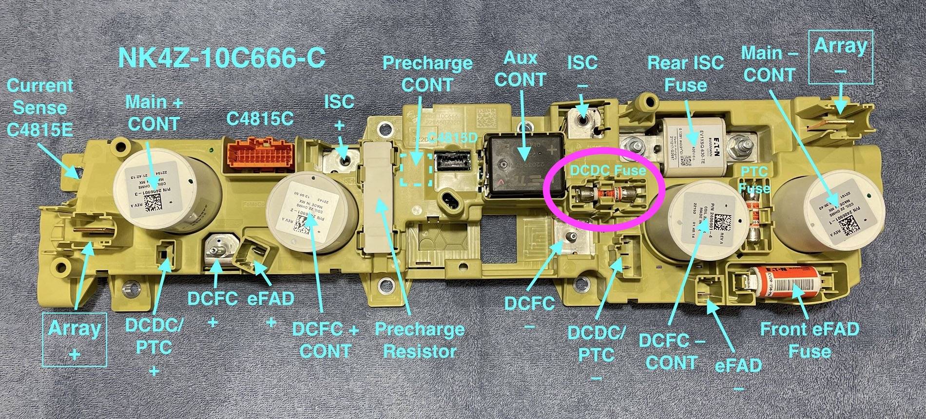

There must have been some kind of fault in the DC/DC converter module that blew the high voltage fuse powering it. The HVBJB is also the fuse box for the high voltage system. They simply replaced the 50A fuse that blew (twice because they did not identify the fault in the DC/DC the first time) along with the faulty DC/DC converter.
The fuse they replaced is circled in magenta, it just pulls out:
Ford Mustang Mach-E Help understanding a HVJB Repair HVBJB DCDC Fuse
You already have the newer version of the HVBJB in a 2024, so they didn't need to replace the whole HVBJB, just the fuse.
The DC/DC going bad is rare, nothing to worry about now.
