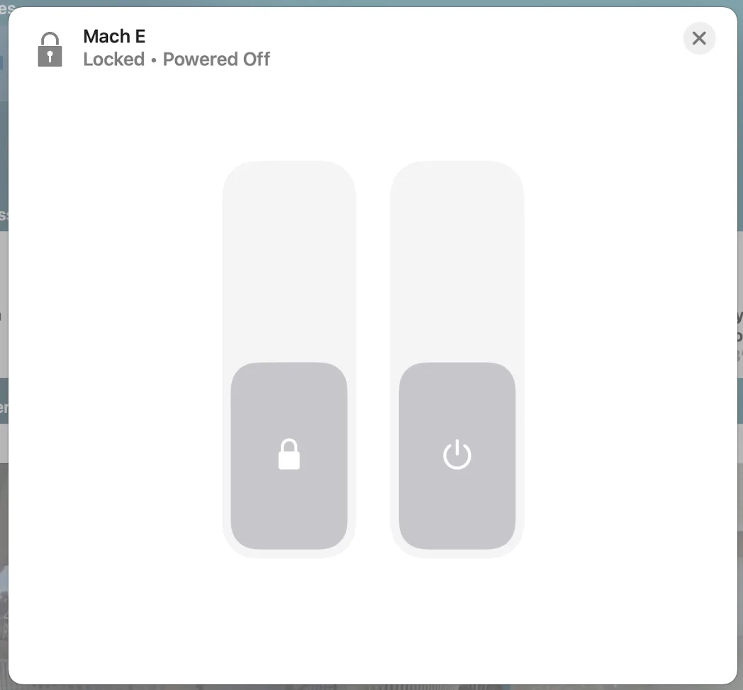

I've been running Homebridge on a RPi for over a year and it's the best addition you can make to standard HomeKit. It has so many benefits, including the ability to support Ring Cameras via Homekit. I've been using the Fordpass plugin as well for my F150. Just purchased a Mach E and it was a simple addition to the Fordpass plugin via Homebridge and my MME now shows up.
The plugin only supports turning the car on/off and locking/unlocking the doors for now. But I can say "Hey Siri, turn on Mach E" and it works.
Ford Mustang Mach-E HomeKit Integration? Screen Shot 2022-01-12 at 8.11.20 AM

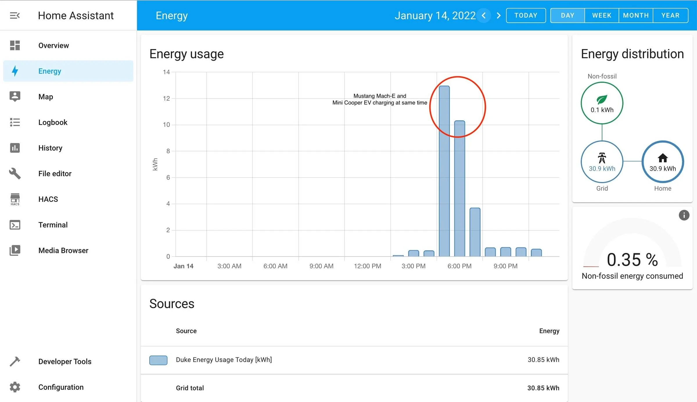

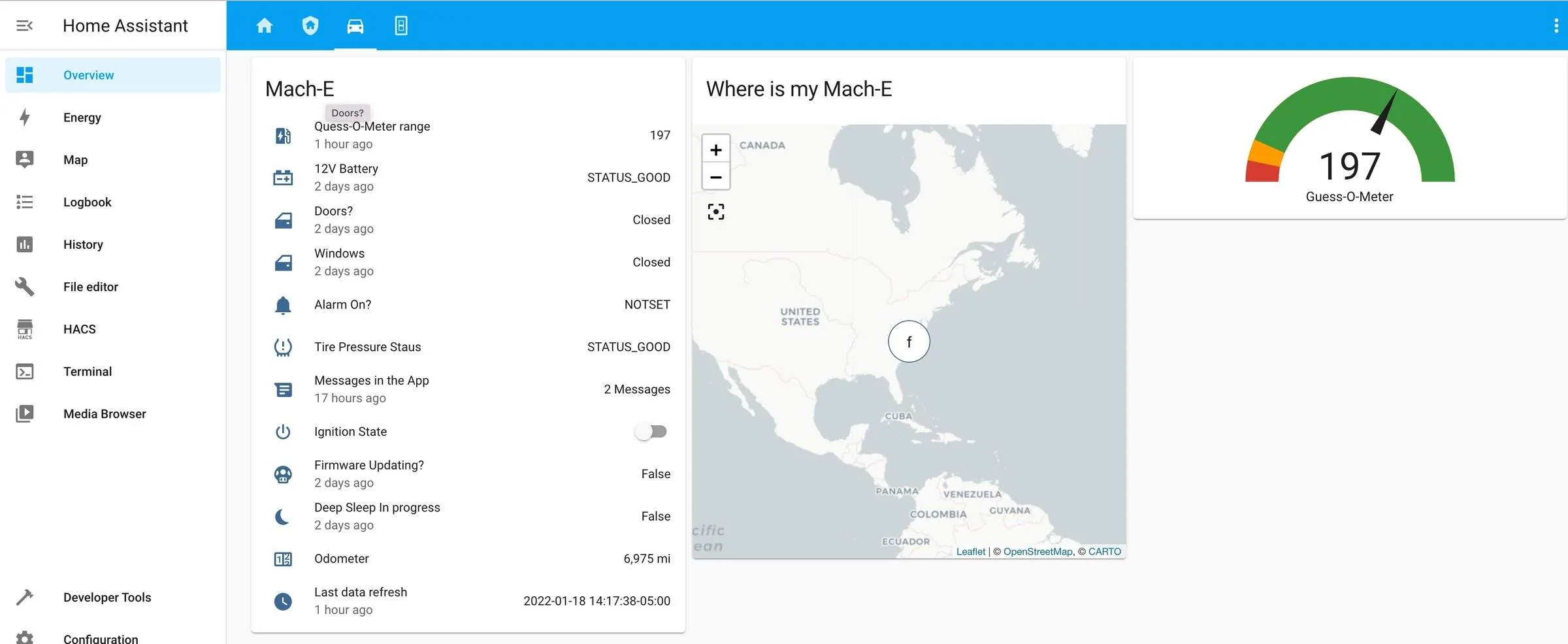

Doing HomeKit integration with Home Assistant. Added the FordPass plugin but the information does not report over to HomeKit, still looking into that. Did build a screen for the that in Home Assistant. And also added an integration for my Duke Energy smart meter gateway which is very informative when charging. Also not reporting over to HomeKit and looking into that s well. Some screen shots.
Ford Mustang Mach-E HomeKit Integration? HA Fordpass screen
Ford Mustang Mach-E HomeKit Integration? EV Power Used charging
