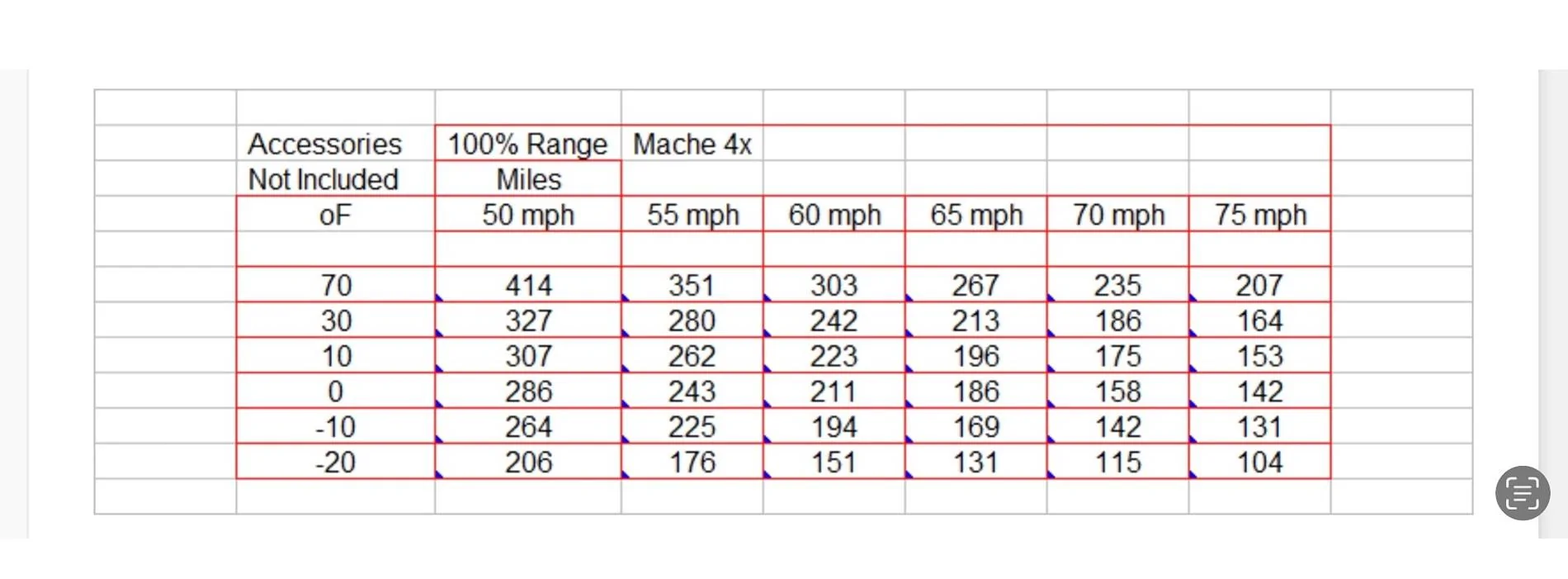

Mach-Lee, where did you get those numbers?
Womps
Sid
Nov 3, 2022
336
510
Alberta
2025 Cadillac Optiq and 2026 VW Tiguan
This is for a 4x extended range.
