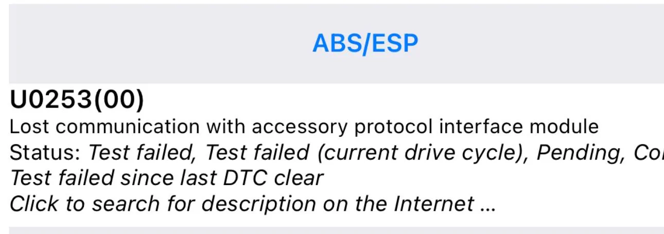

Today while I was driving, I experienced the drive mode unavailable so I ran a scan with Car Scanner while I was driving and this was a code I’ve never seen before so I stopped turn the car off put it back in accessory mode cleared the codes. No codes came back, the interesting thing was once I plugged the scanner in and started the scan It kicked into engage, no more error! See below an explanation of what this error code says.
“Severity in this case is never severe, as this is a customer convenience device, and there is always a manual workaround in the event of a complete electric failure. Vehicle operation is in no way affected by the lack of operation of the APIM. Symptoms of a U0253 code may include:
Steering wheel controls inoperative Cell phone won't sync with vehicle Unable to use Navigation System”
