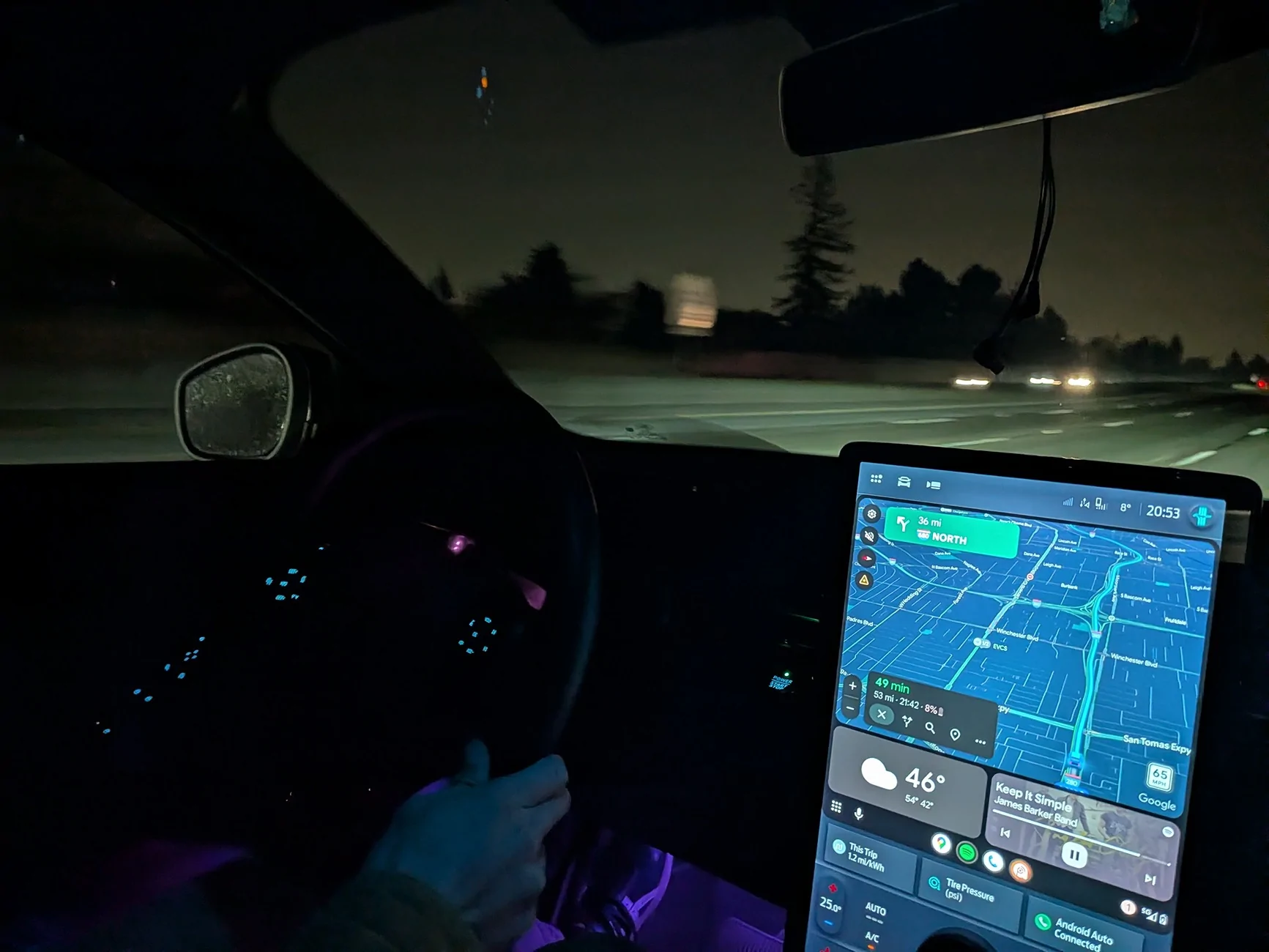

Everything was working fine about 5 hours ago but as I was leaving the house about 1 hour ago, I noticed the instrument panel was dark. Does anyone know why? I'm going to call the dealer tomorrow but wanted to see if anyone knows about this so I don't have to go to the dealer. Thanks!

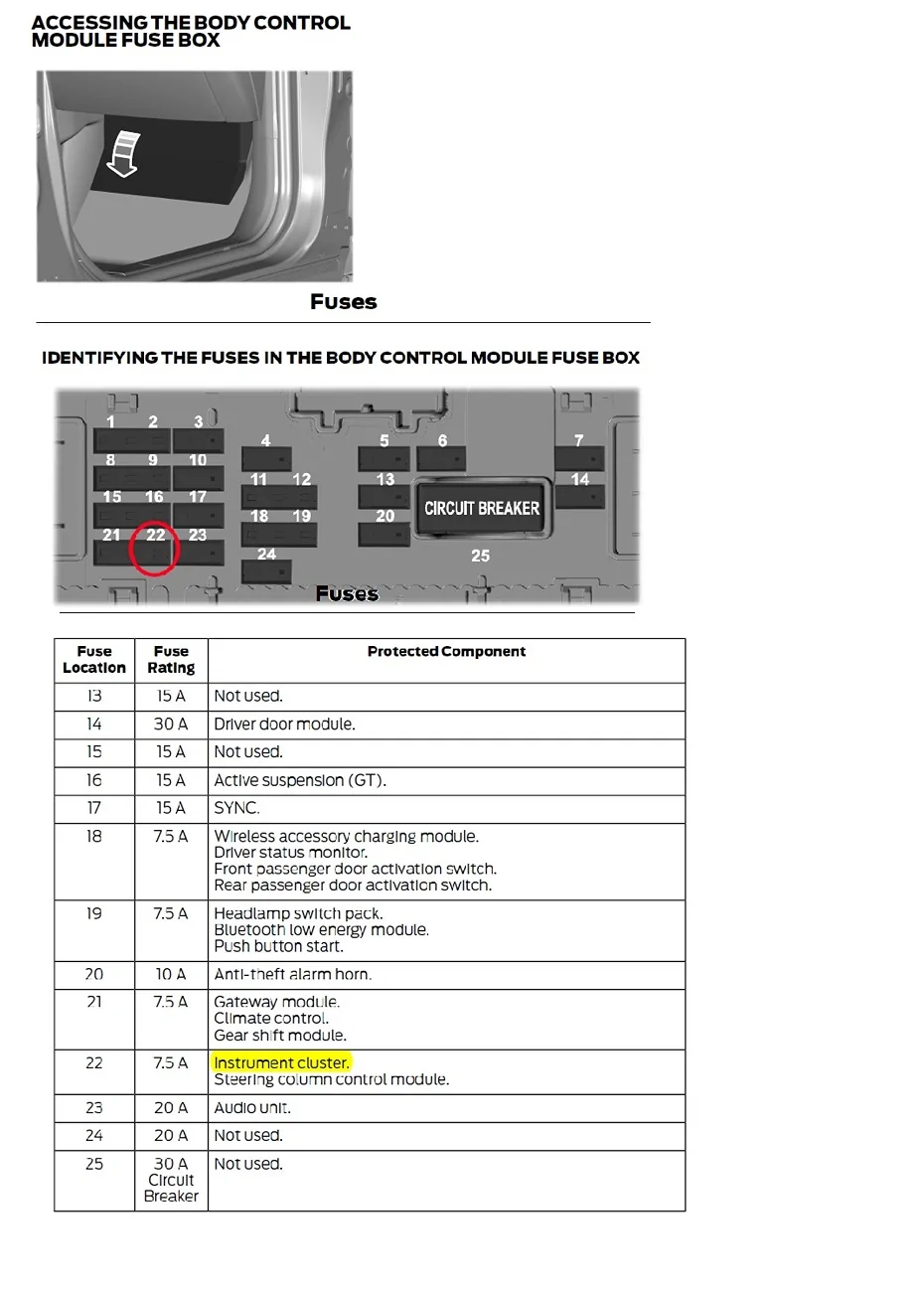

I'm surprised nobody has suggested a fuse?

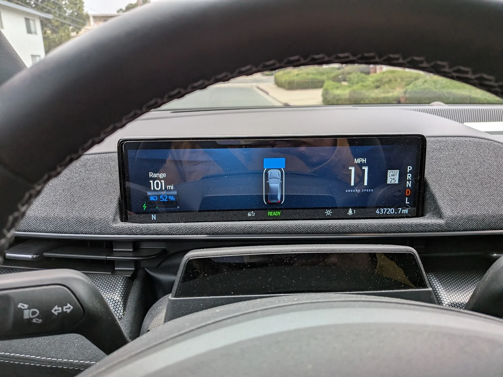

I was actually going to go and see this before taking it to the dealer. I got into the car this morning to start up just for kicks and giggles and voila, the IPC was on. This leads me to think that it could be a wiring issue. I could prob take it to Ford but Ford would bounce it back saying that since it's not broken, they can't take a look at it. Thanks for the help everyone!
