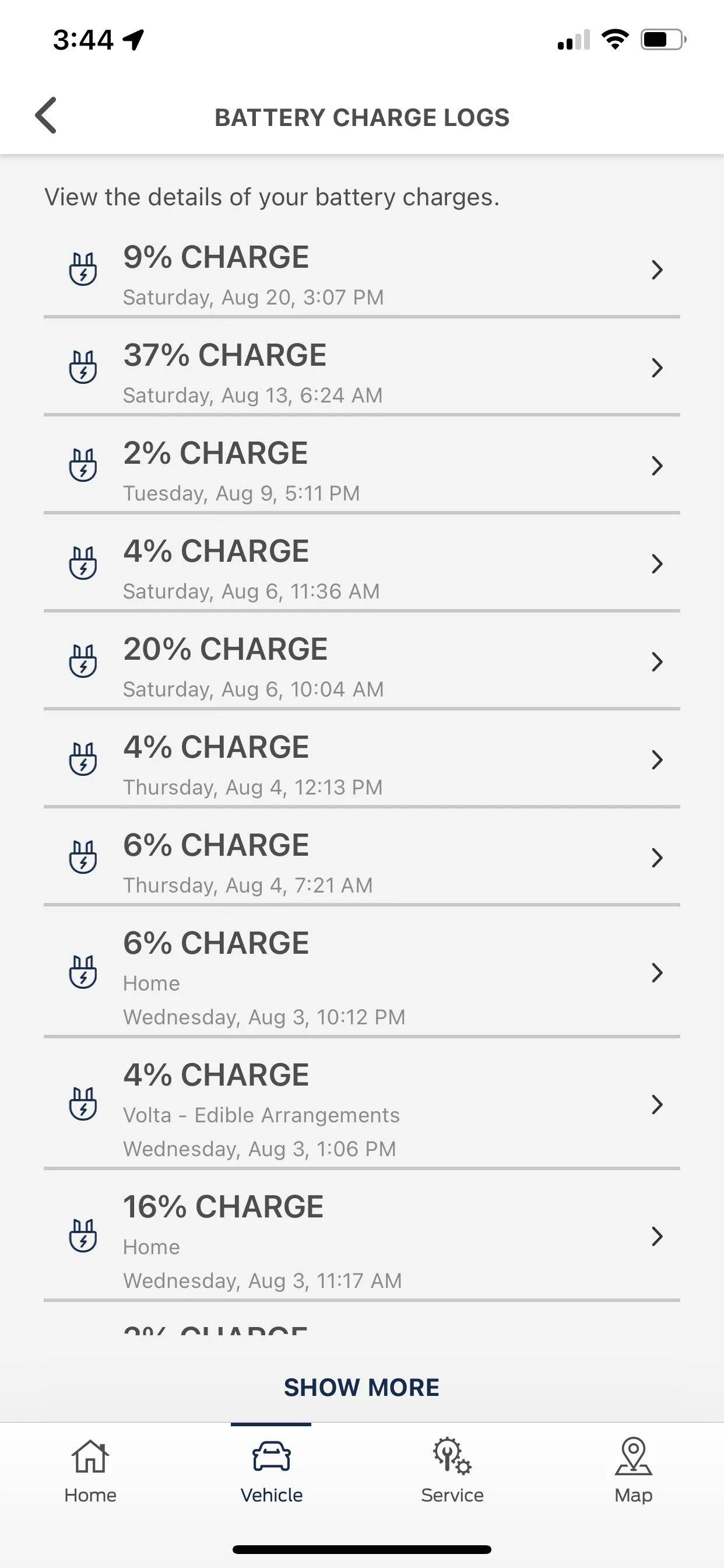

Started having issues two weeks ago with my Level 2 charger stopping after 10-15 minutes or so.
The only time I’ve had success charging is (of course) when I took it into the dealership and got accused of not pushing the charger in enough (after 18 months of use). I’ve gotten this error at two different stations.
I’ve seen some run into this issue on the boards but haven’t seen a resolution.
Additionally, I’ve recently had a tire pressure warning for low pressure - even though my manual test shows fine. Any ideas? TIA.

Clarification - the charge light on the car turns red; the charger seems fine.

And what EVSE are you using? How many amps?

Since the problem happens at home and not at the dealership, I'd start by checking the EVSE. If the supply is via a plug-in type, remove the plug and look for damage. Also while the charging is happening feel all the cables to see if anything is hot. There have been some on the forum who've had this type of issue and it turned out to be a bad EVSE plug and/or socket on the house side of the connection. Good luck!
