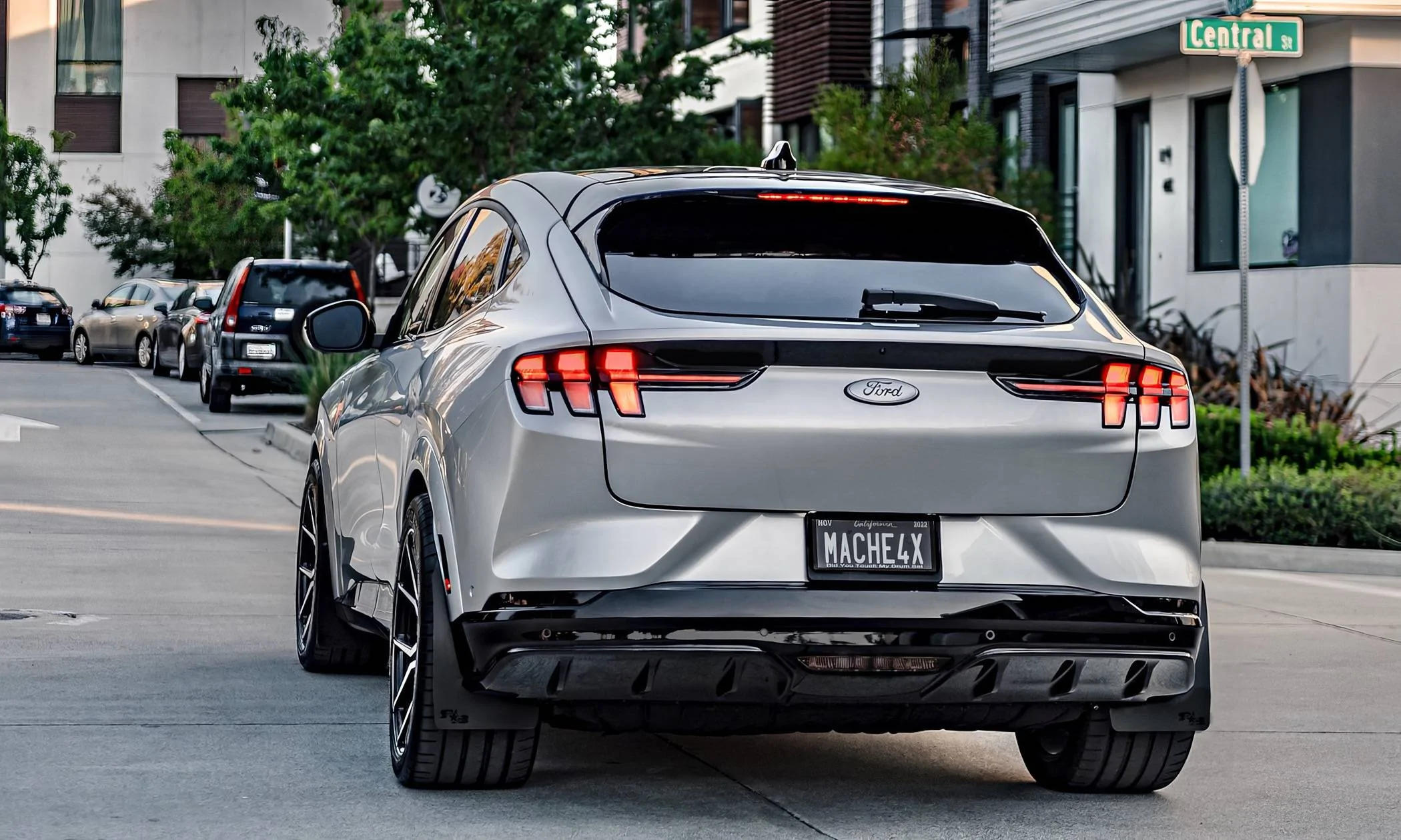

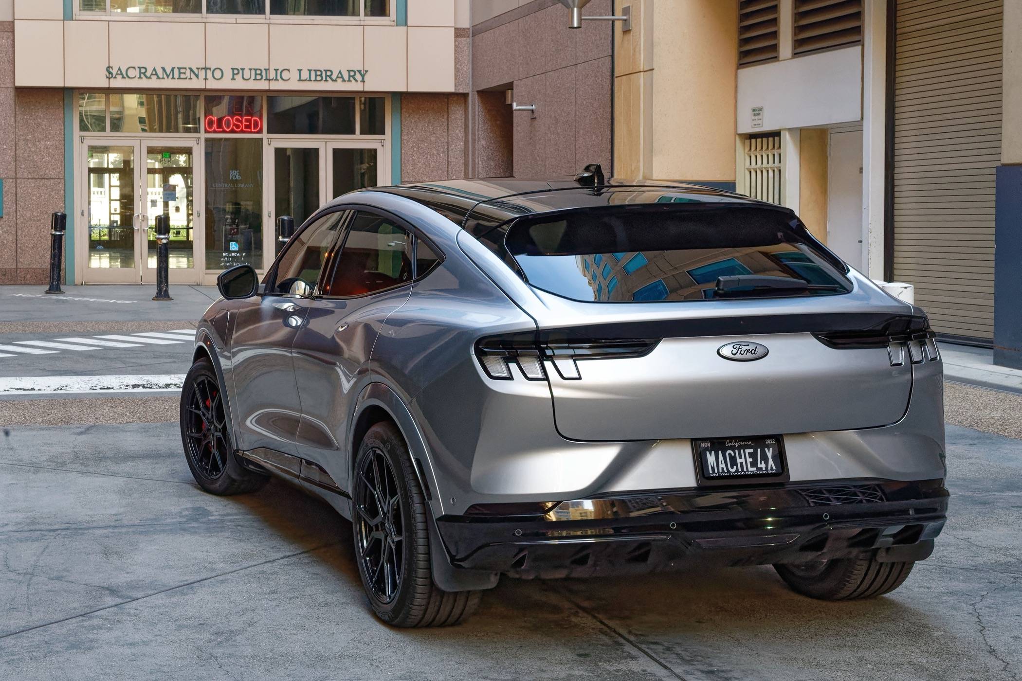

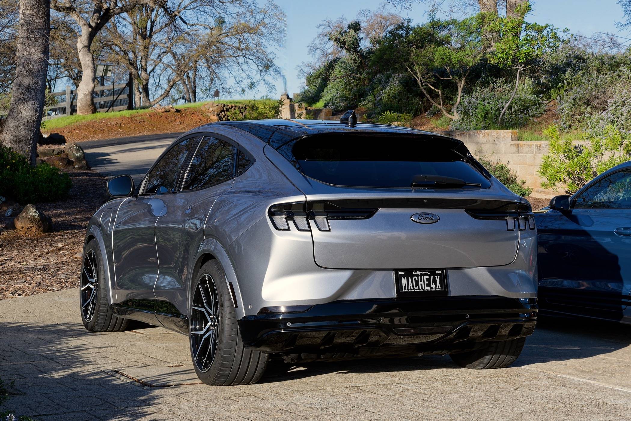

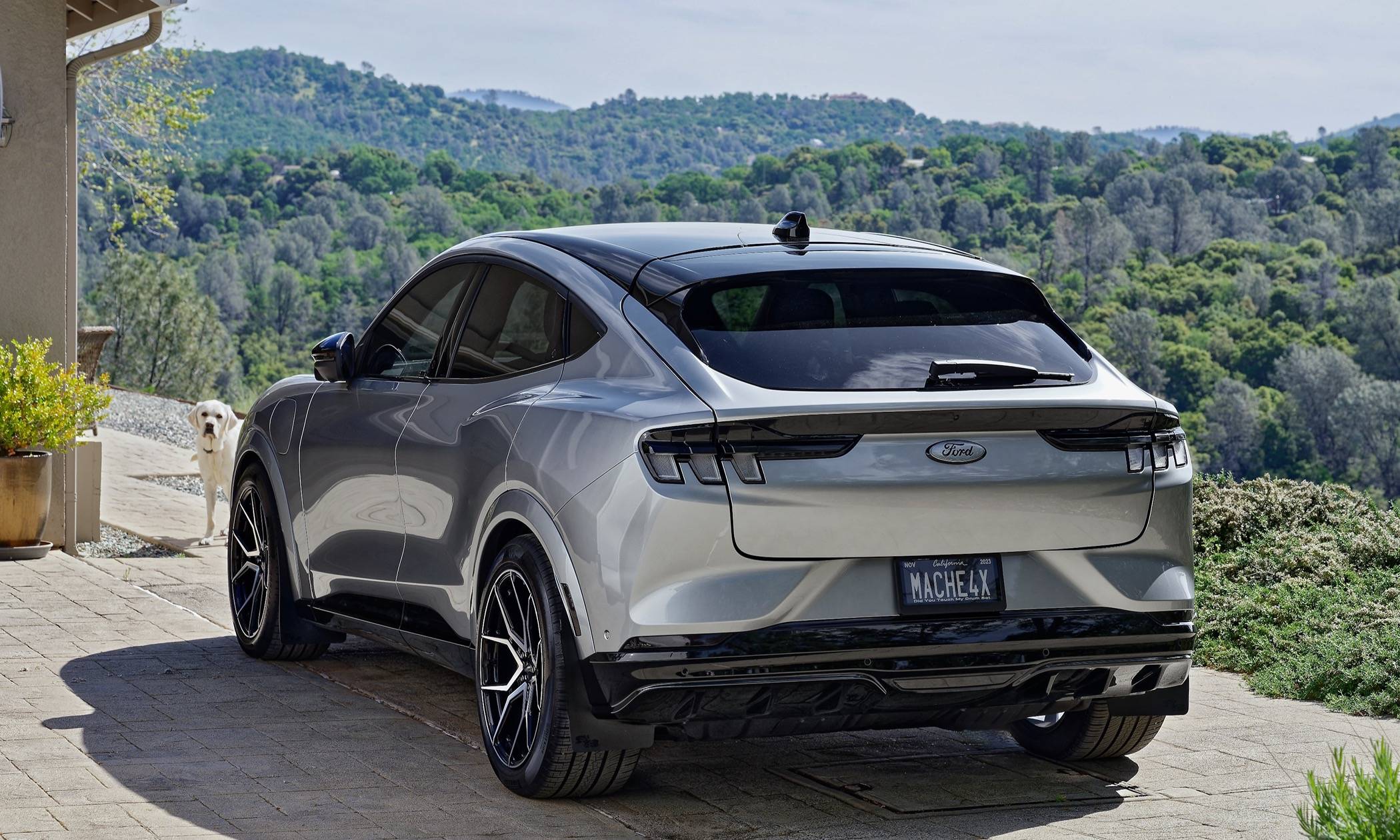

I've had many wheel/tire combinations (over 10) but here are four of the wider sets I’ve run showing the rear end only to get an idea what the tires looked like.
255/45/20 front, 285/40/20 rear

265/45/20 front, 295/40/20 rear

265/40/20 front, 295/35/20 rear

275/40/20 front, 315/35/20 rear
