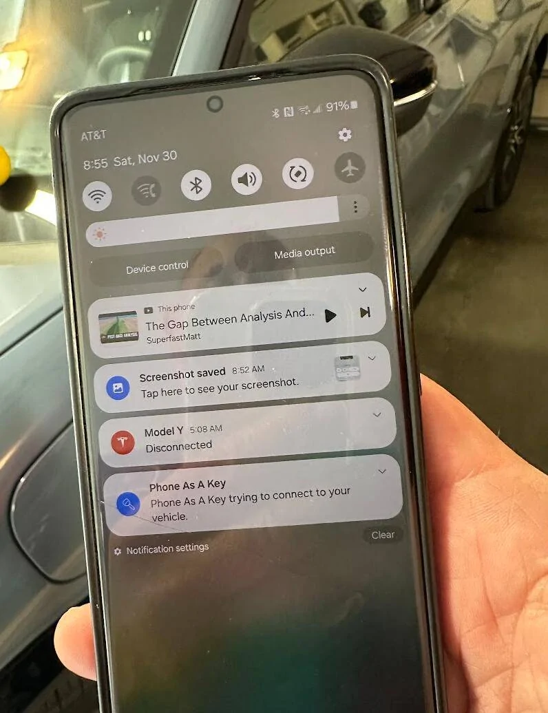

1) Sometimes I walk into the garage with my phone in my pocket and the lights of the car turn on to greet me. So friendly. But most of the time they don't. I often see a "Phone as a key is trying to connect to your vehicle" notification on my Galaxy. I can walk right next to the car and it still doesn't connect (see photo).

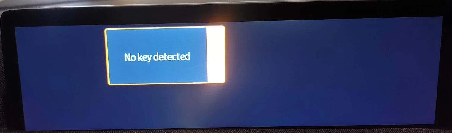

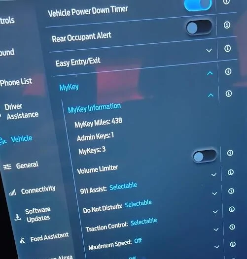

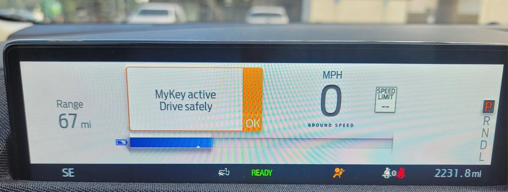

I can open the door with the code on the b-pillar and get inside and turn on the car. When I do, it briefly displays "No Key Detected" then the dash displays its spasmodic blue waves. I can't drive unless I enter a passcode at the prompt on the big screen. Frustratingly, and it direct conflict with my complaint number 3 below, I know the phone is detected because it automatically connects to Android Auto and starts playing my music. For 30 seconds. Then it turns off completely. See video and photos below, all taken with my phone. Also see photo further below from yesterday (20 miles earlier) where is says MyKey is Active. Same phone, etc. I can always open the Ford Pass app and lock/unlock etc via my Galaxy. MyKey worked great at the dealership and for the first few days/weeks, thus 438 of the 2251 miles via MyKey. Completely useless since because you live in constant fear of being locked out.
Video:
Using wife's admin key I can see list of MyKeys but not much else.

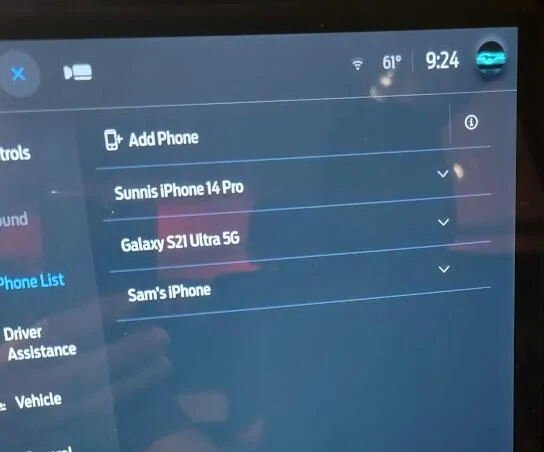

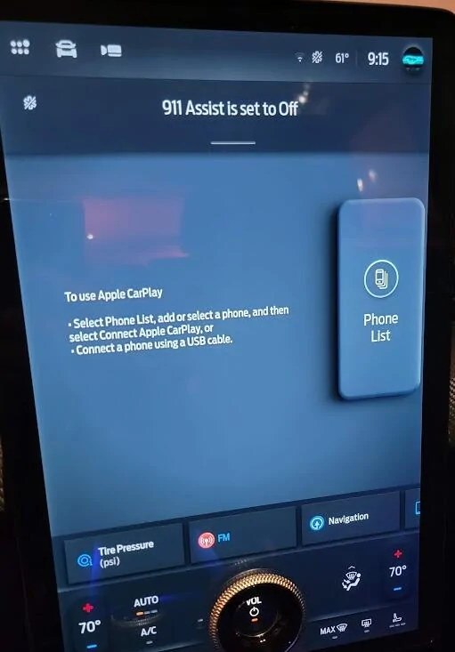

3) When either she or I (alone, with our phone and our key but with other phone/key not nearby) first drive the car in a day we are presented with a screen telling us to use Apple CarPlay select a phone. The message is the same for either of us (i.e. it says Apple CarPlay even though I have an Android). Once a phone is selected, it seems to properly auto connect for the rest of the day. Note re: #1 above, I had picked my phone once today so even without a physical key (and MyKey not detected), it did auto connect after that.

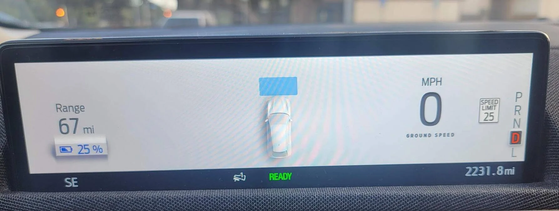

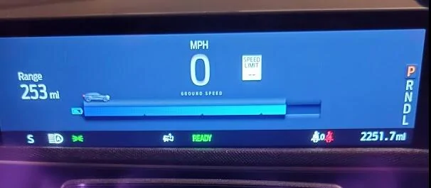

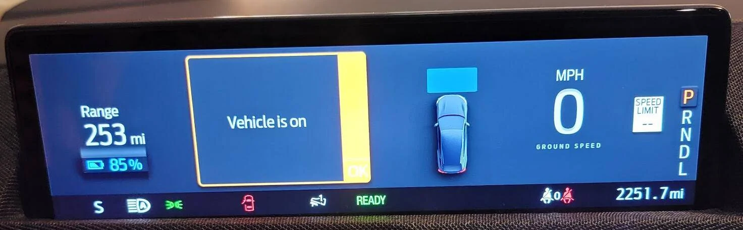

4) Maybe related to #2, when I drive alone (with my key) the dash shows the following distance to the car in front. Bluecruise is off. No difference in display when I turn on/off BC. When she drives, or when I drive with her, the dash shows a battery charge status thermometer. Interestingly, my display also shows the battery status bar for a few seconds after startup but the it switches to the following distance. I don't really care which display I get but I don't know how to change. Probably deep in some manual and screen somewhere.

My physical key (and I have my phone) at home in garage alone at initial startup:
A few seconds later:

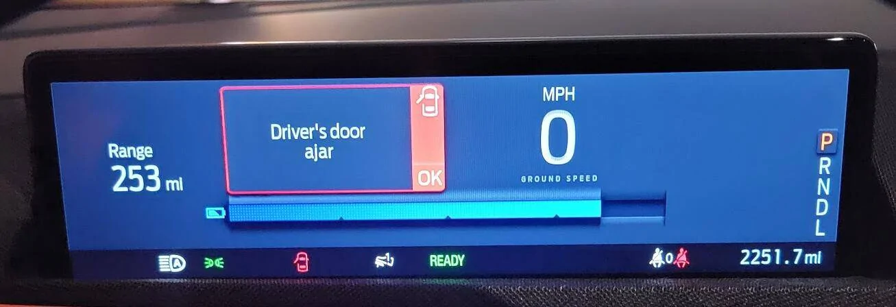

My physical key (and I have my phone) away from home alone at initial startup. Note MyKey working here while not working above. Same key/phone. Different day/location (20 miles earlier).
A few seconds later, in gear, and for rest of drive:
