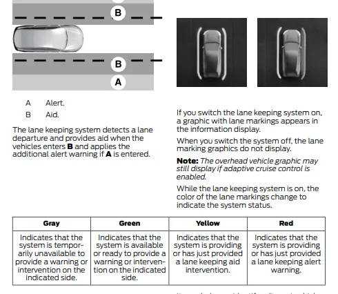

When the lines turn green the car is tracking the lanes. If you swerve quickly out of your lane the car will not do anything as it knows you are purposely trying to. If the lines are grey the car is not tracking the lanes and will do nothing. To test the system be sure it is in aid or aid+alert mode and gradually let your car touch the lane line WHILE the line is green. The line should turn yellow in the instrument cluster and the car should gently steer back into the lane. This works best when it is a straight road.

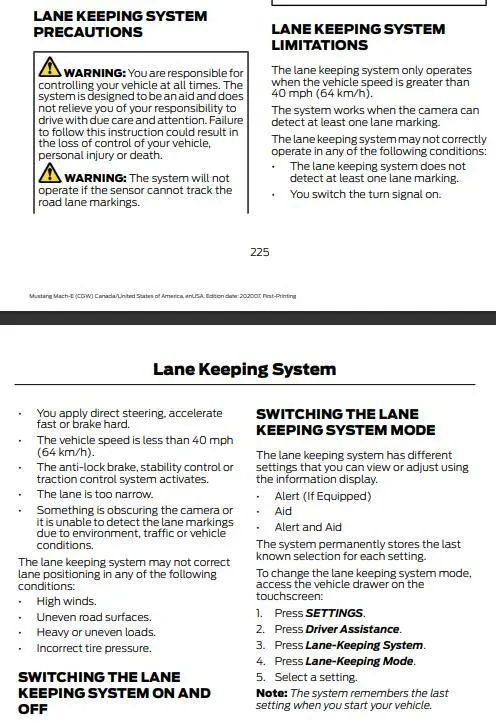

thank you! This is very helpful. RTFM not so much. I agree it would have been better to have spent more time with the salesman, but a) he didn’t. Know much, and b) he had covid, so I was anxious to get away from him. I really appreciate your patience with all this. I’m gonna stop worrying about it and wait for my dealer appointment.
On RTFM, I learned that it won’t activate if speed is under 40mph and if “direct steering“ is applied. i guess in order to really test it I have to take some sleeping pills and head onto the highway. In other words, I’ll just have to assume it’s working.
