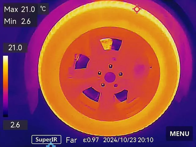

I am at 99,361 miles and friction linings still got plenty of meat left, not even half worn.
However, for a few weeks been feeling a slight twitch at steering wheel at slow speed, been meaning to check tyres for damage, bleb, bulge or something.
However, just bought new thermal imaging camera to help with fault diagnosis and looks like high spot or warp on front brake disc [rotor for the US] could be the cause.
After last 100-mile leg of Wednesday’s 575 mile road trip I photographed the wheels to see where the heat was on each wheel, tyre, brake etc.
Always using OPD and didn’t touch the brakes between a charge at Scotch Corner and home 100 miles later.
Attached illustrates the temperature of the tyre in low 20s of centigrade scale, discs stone cold except for some heat on one section of a front brake disc as if there’s a hotspot there.
Know where to look now after tyre inspection at weekend.

That hot spot is likely from when the hydraulic brakes took over from the electric motors to stop the car At somewhere around 4mph. ??
