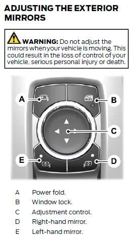

Folding mirrors should not be folded manually. To reset them, follow these instructions from the manual:
To reset the power-fold feature, use the
power-folding mirror control to fold and
unfold the mirrors. A loud noise could occur
when you reset the power-folding mirrors,
this sound is normal. Repeat this process
as needed each time the mirrors are
manually folded.

I'm not having this issue but is this ( power-folding mirror control ) where is this control? Just incase.
