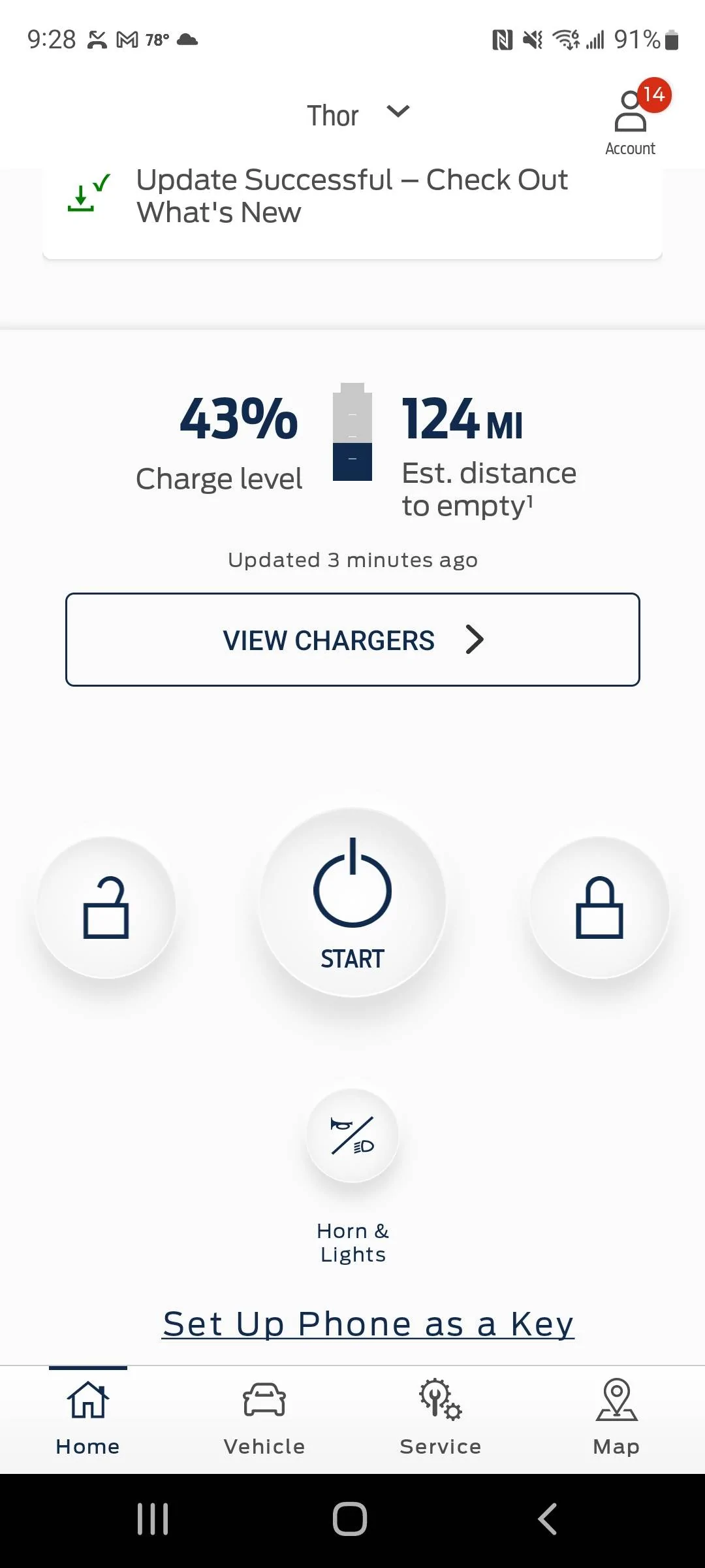

I agree with the agree. It might even have a note on the home screen asking to have PaaK set up.
Looks like this.
Ford Mustang Mach-E Missing Buttons on the Ford Pass App Screenshot_20221015-092826_FordPass
