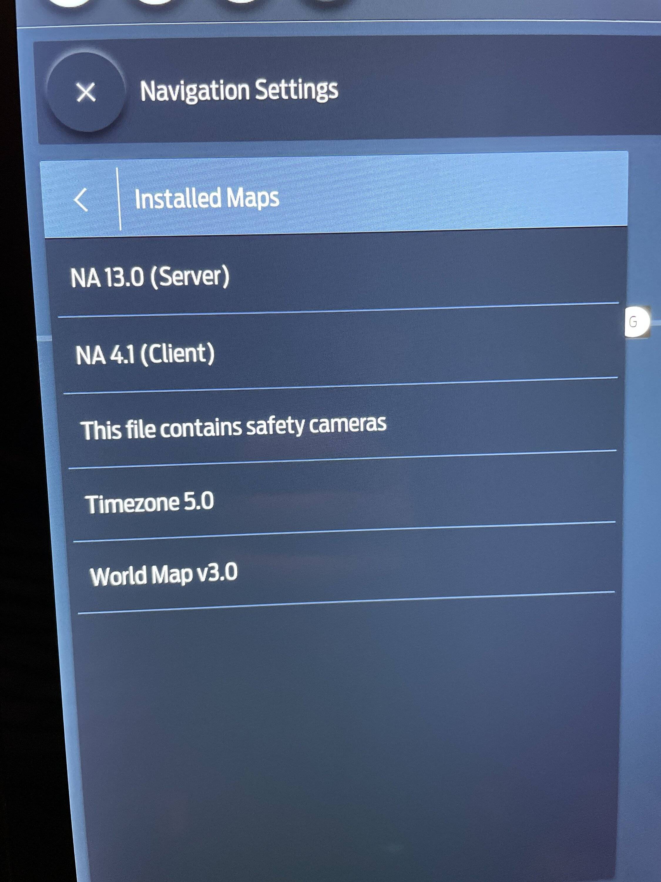

That’s what I’ve got.
@Mach-Lee, thanks for this screenshots.
