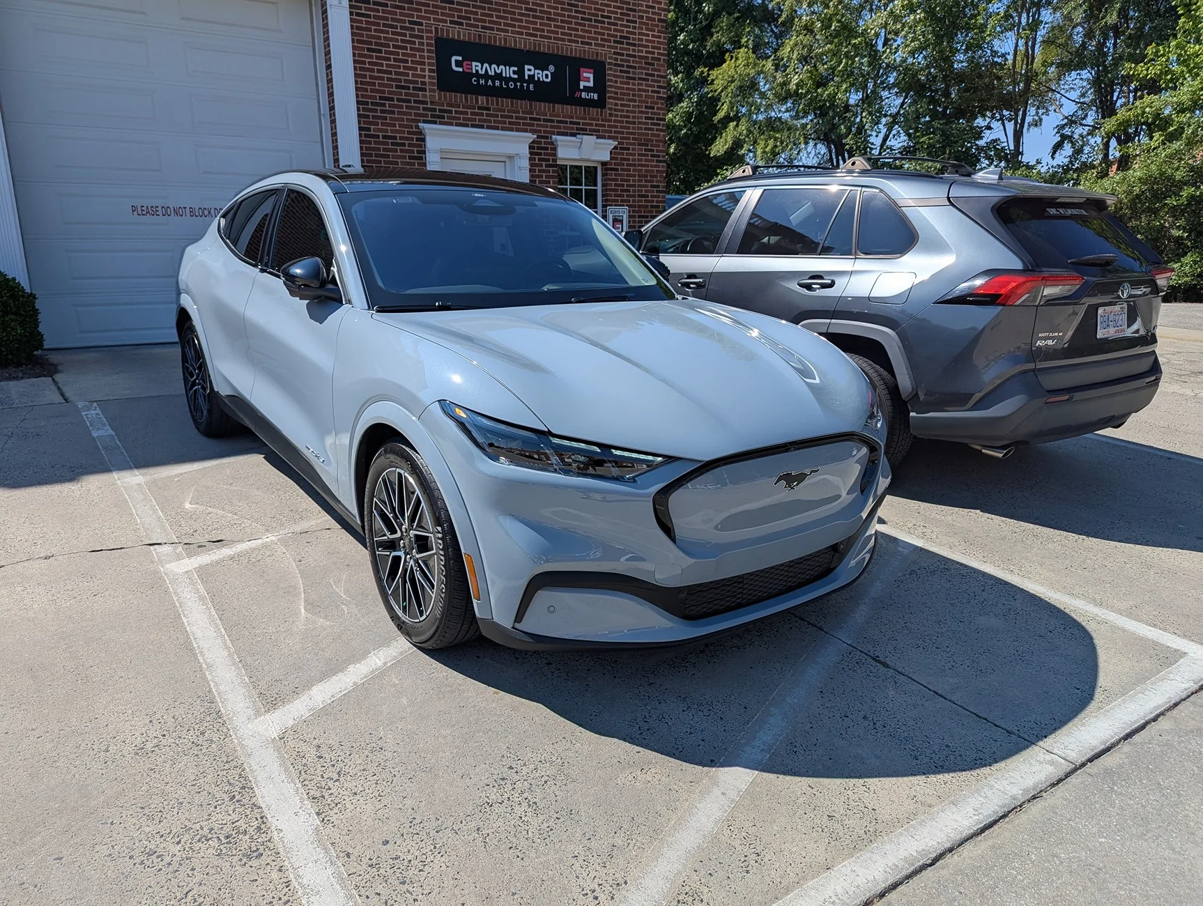

Ford Mustang Mach-E Myles Stangish gets a Range Check PXL_20260730_143454794.MP
(Myles after his checkup at the detailer)

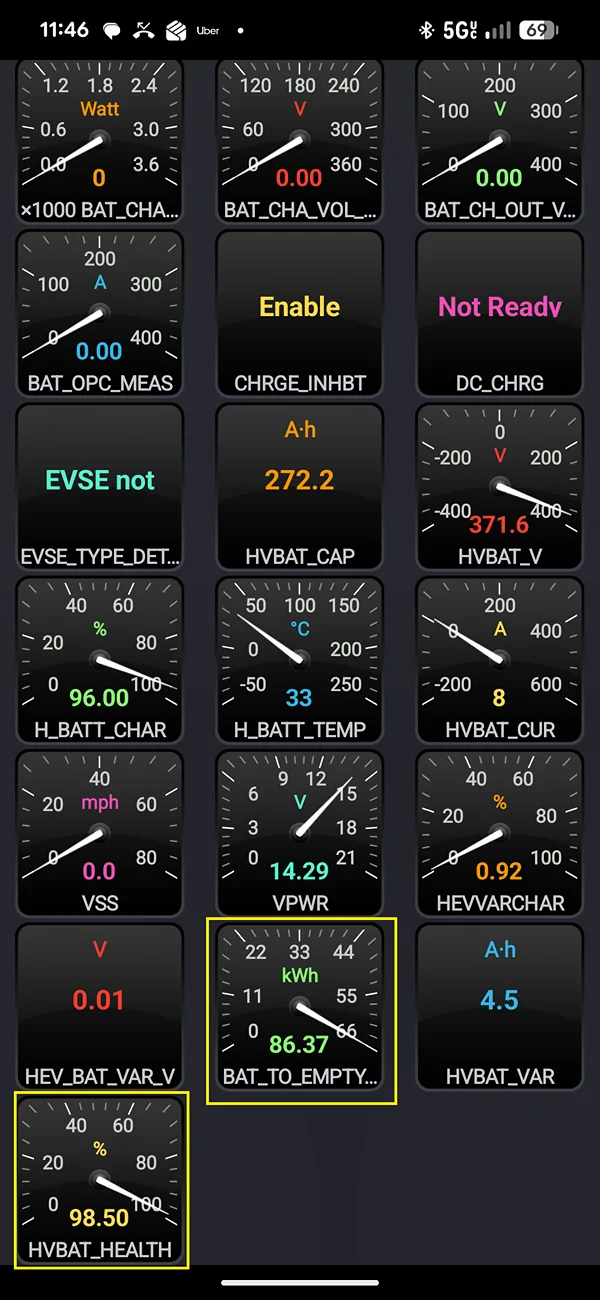

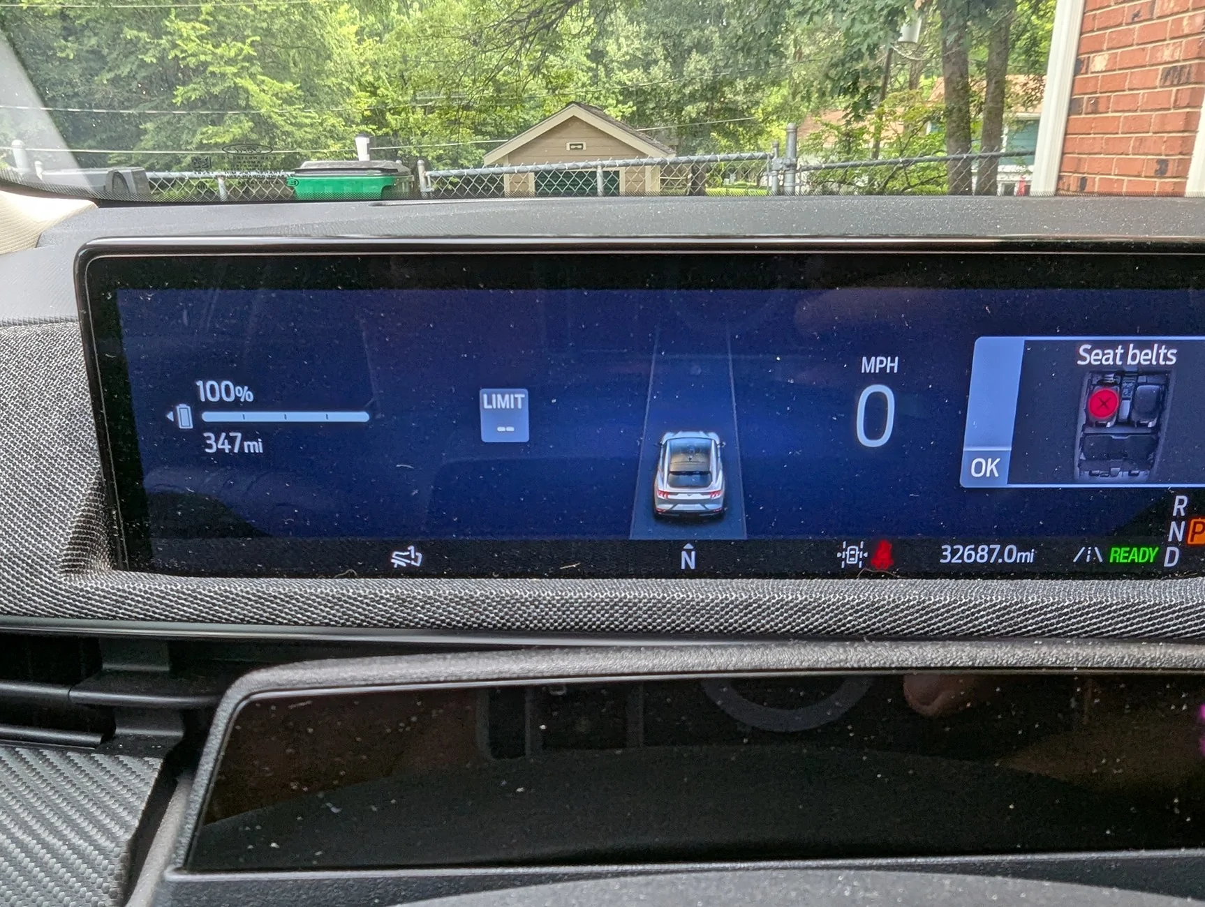

Tuesday morning, I started out with 100% charge, 347 miles on the guess-o-meter and there was 86.37 kWh in the ‘battery to empty’ reading. My battery state of health read 98.5%.
Ford Mustang Mach-E Myles Stangish gets a Range Check PXL_20260728_154604641
(100% charge and 347 miles range)
Ford Mustang Mach-E Myles Stangish gets a Range Check Screenshot_20260728-114649_BatterykWH
(98.5 SOH and 86.37 Battery to Empty)

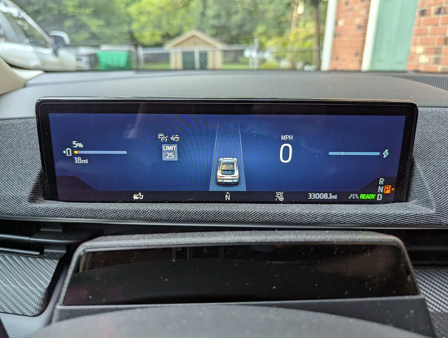

Friday I drove 82.6 miles. The extra miles were just trying to get the charge down to 5%. I stopped the test as soon as I hit 5%. The guess-o-meter read 18 miles remaining and there was 7.788 kWh left in the battery. Miles driven (320.2) + the guess-o-meter reading was 338.2. 82.6 miles / 20.242 kWh comes to 4.08 mi/kWh for this day.
Ford Mustang Mach-E Myles Stangish gets a Range Check PXL_20260731_221502089
(5 % left and 18 miles projected range)

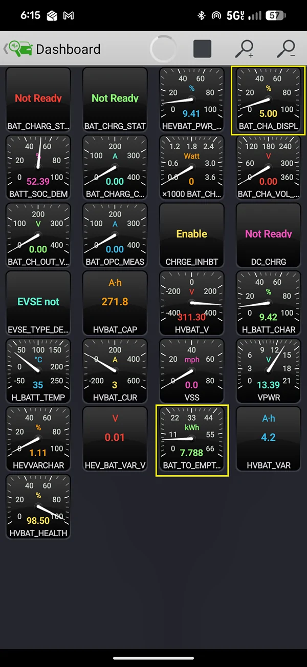

Ford Mustang Mach-E Myles Stangish gets a Range Check Screenshot_20260731-181516_FinalkWhToEmptyAndChargePct
(7.788 kWh left and Charge at 5%)
I have never run the car completely out of charge. I did run it down to 2% once. So it can clearly go below 5%. And I feel that it probably would have gotten pretty close to that 338 mile total projection I saw on the last day.
For these four days, total energy used was 86.37 kWh – 7.788 kWh which comes to 78.582 kWh. 320.2 miles / 78.582 kWh is 4.07 mi/kWh. The mi/kWh reading from the trip odometer was 4.1. So, not far off.

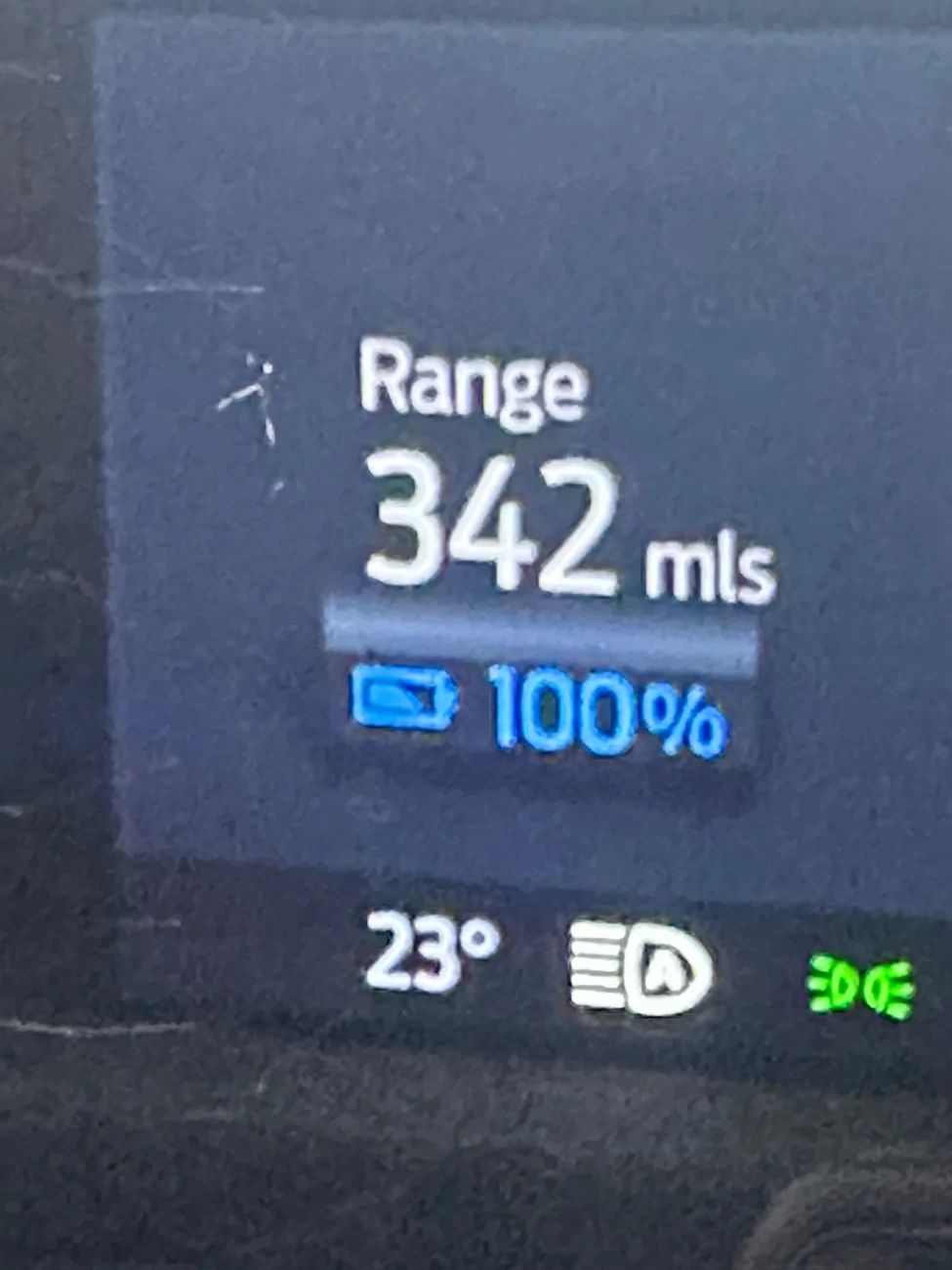

Big Red got charged this morning and……..well if you believe that good luck🤷🏼‍♂️
