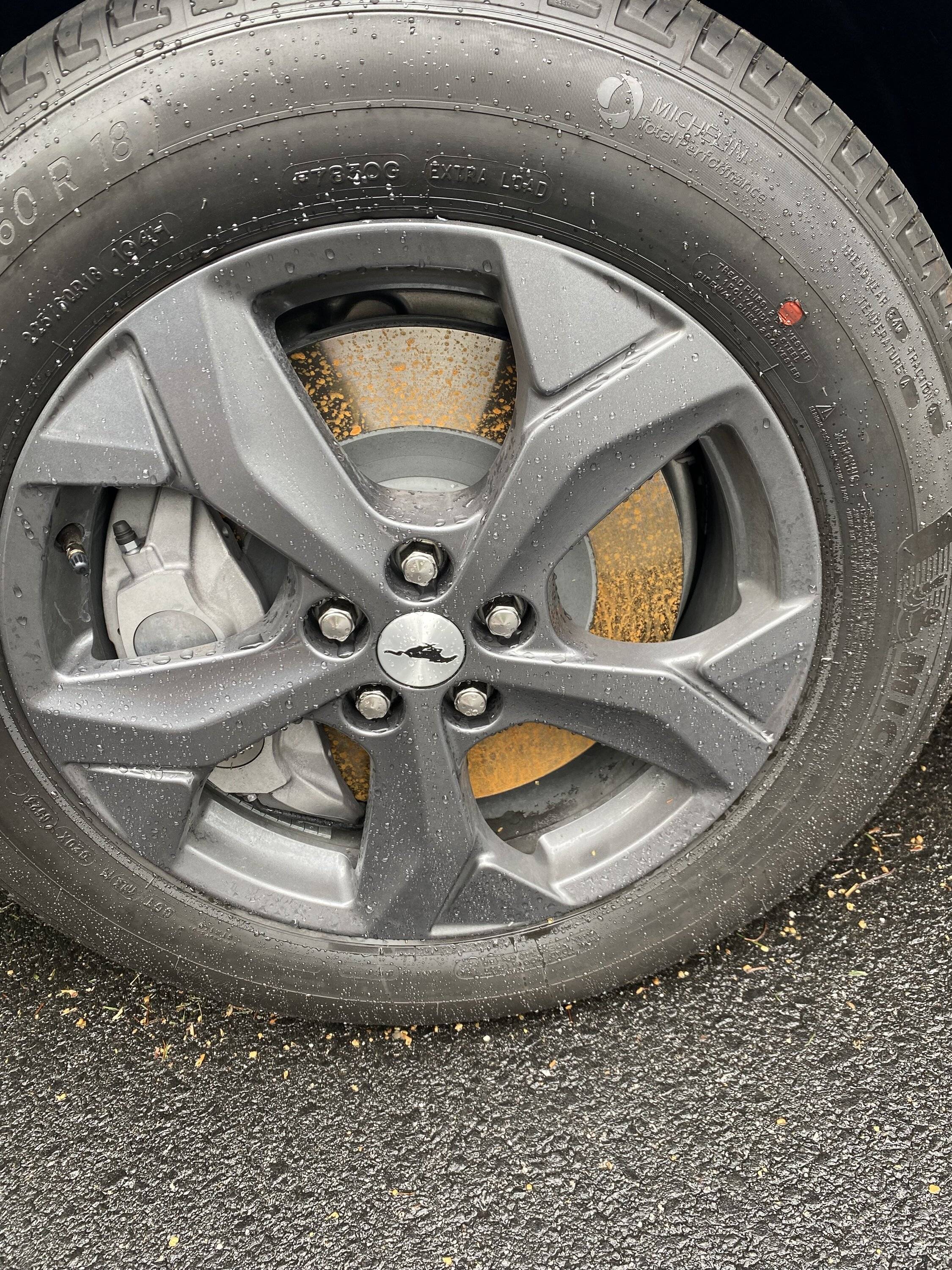

Just got a new Mach E (Select) and (I think/hope only when) after it rains, seeing a lot of this yellow/orange/brown splotching on the inside wheel. Any idea if an issue (indicative of fluid leak?) or if just some normal breaking in?

And make sure you do that (shift to neutral on a vacant road and apply the service brake to polish off the rust), since if given enough time, that light oxidation will lead to deeper putting and rotor-destroying corrosion.
