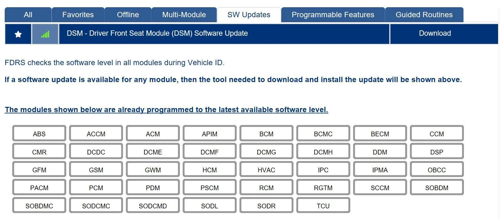

Just spotted this update in FDRS for my 2022 RWD ER....
Anyone know what it does?

I'm guessing it solves either a) easy entry/exit not either moving backwards when you turn the car off or, more commonly, not putting your seat back forward when you turn the car on. b) The intermittent nature of the power controls - occasionally on my old Premium when I would get in the car, if I wanted to move the seat forward, the seat wouldn't respond to the controls. I have to let go and re-press, sometimes a few times, before it starts to actually move.
I've done this update on my GT PE and, so far, easy entry/exit has been working properly, but the issue is so intermittent and the update so recent, that it'll take a bit longer to confirm.
