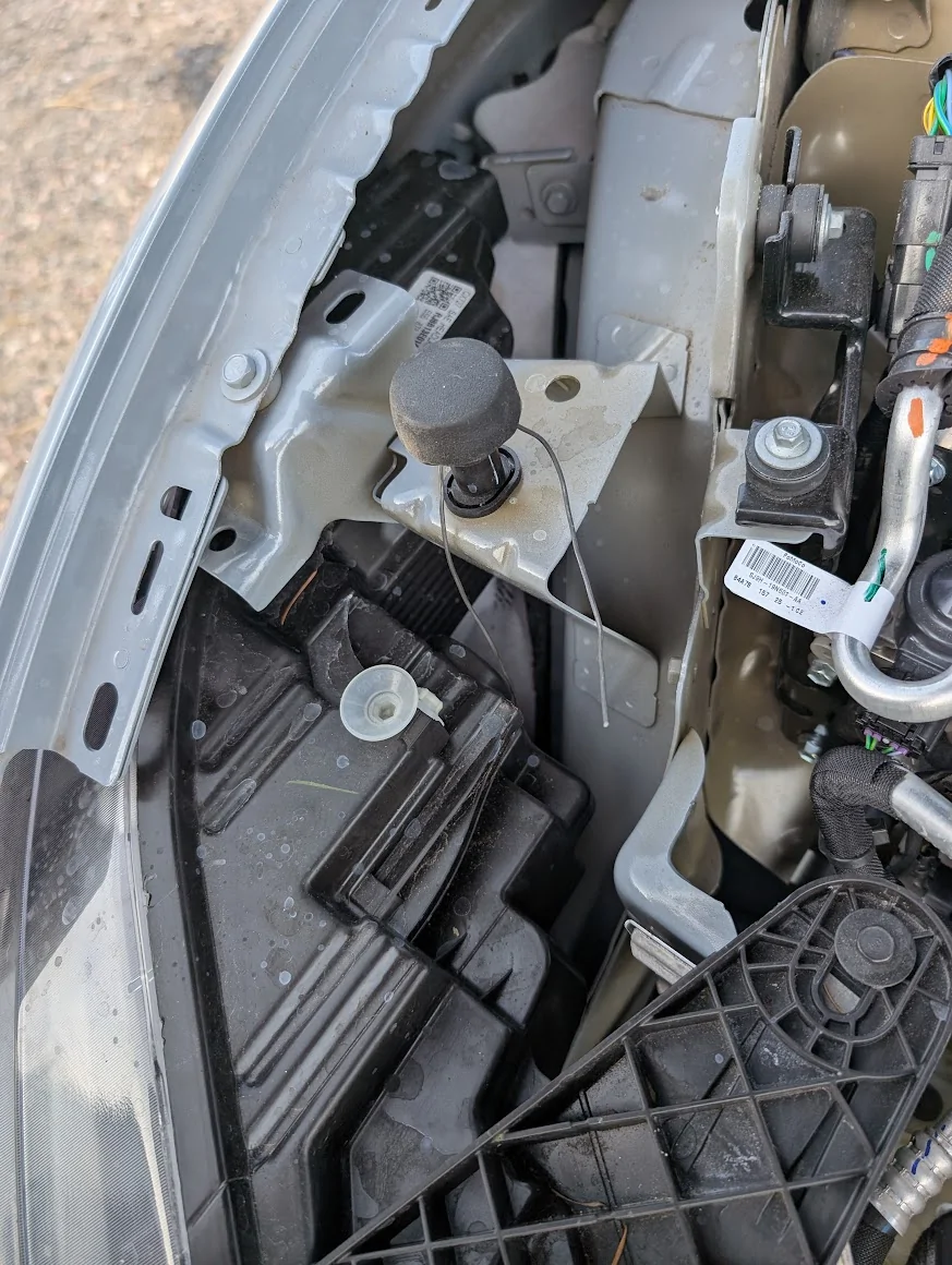

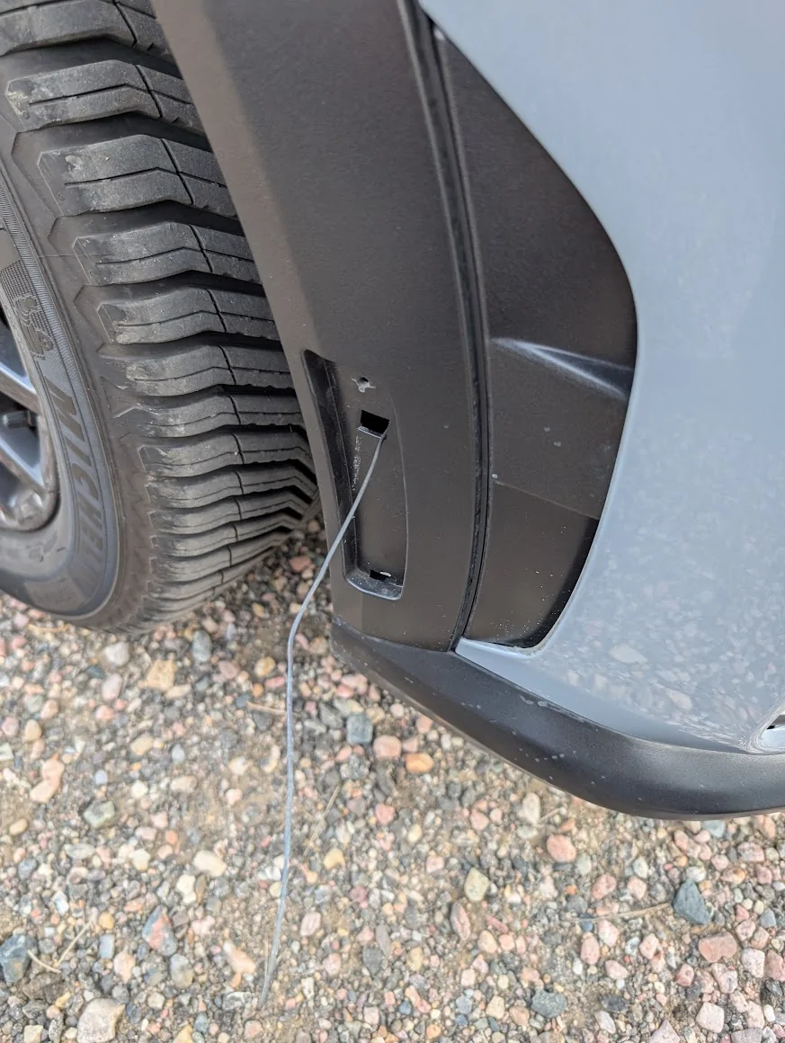

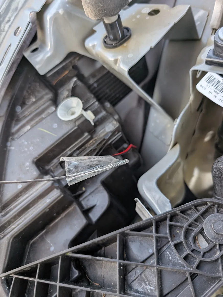

Just a quick follow-up on this thread as I did this upgrade earlier this year. I'll provide the few pictures I took while doing this upgrade. I ended up going with an "Amazon option" as I wasn't aware the EV-Vida had an option. ;) I don't believe the set I went with is quite as bright as mentioned in the other posts of the EV-Vida's.
After removing the frunk and side plastic pieces, I ran a small wire up from the front clip hole and was easily able to spot and grab it in the front. Then taped the wires from the front side markers and pulled them up and through.

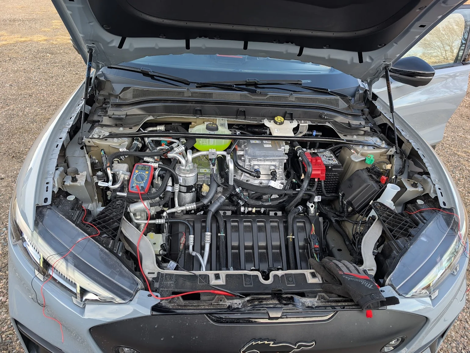

Once the frunk bolts are removed, it's pretty easy to pull the plastic side covers off.
I used the volt meter to test wires at the headlights for tapping into the parking lights like when the rear markers light up, but was unable to find that. Looks like that's also why EV-Vida provides the plug and play and still states that front markers will only come on with headlights. I may end up running a patch wire from the BCM connector for parking lights positive, or from the rears as was mentioned in another post.
Hope these pics help others.
