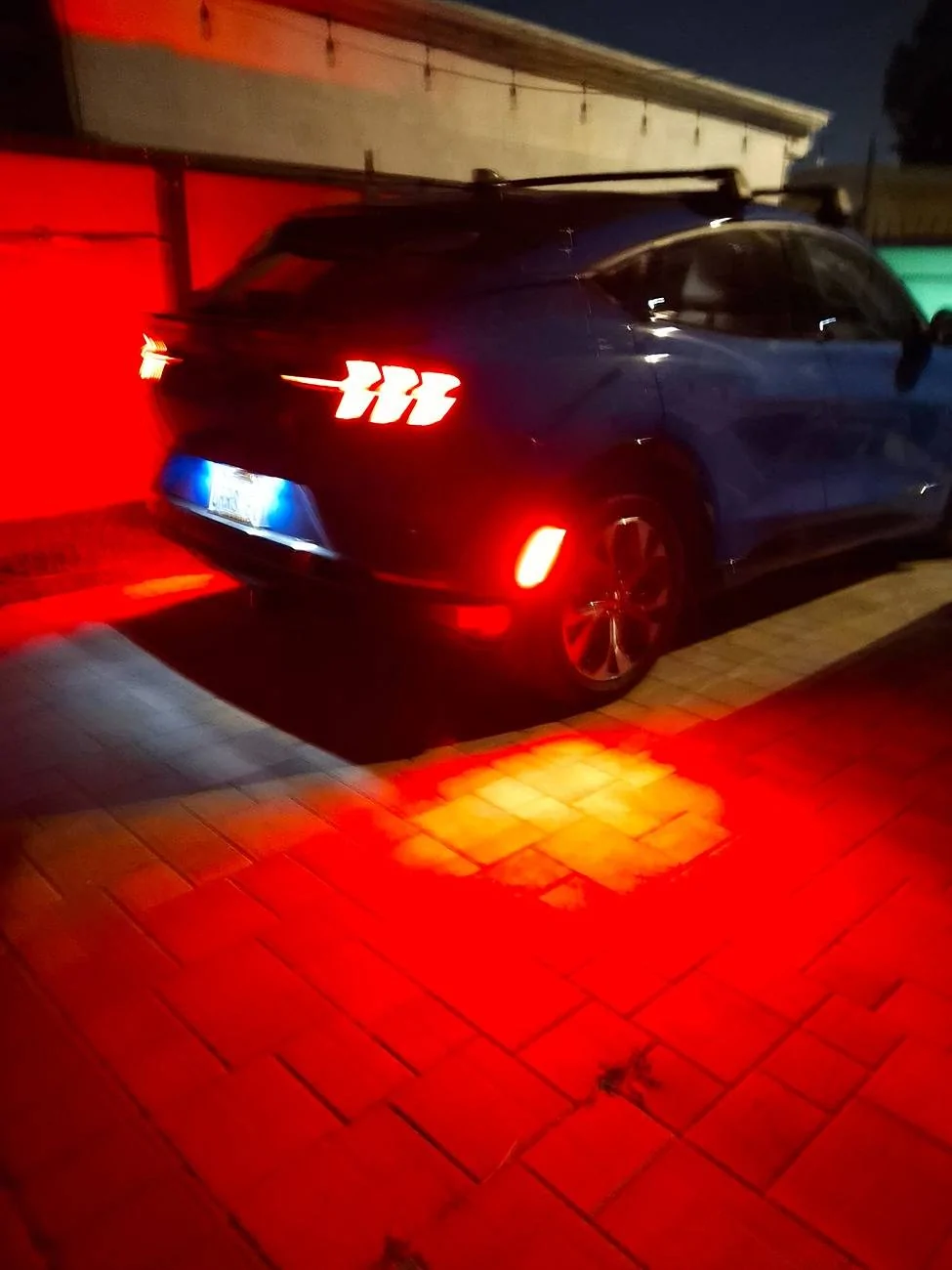

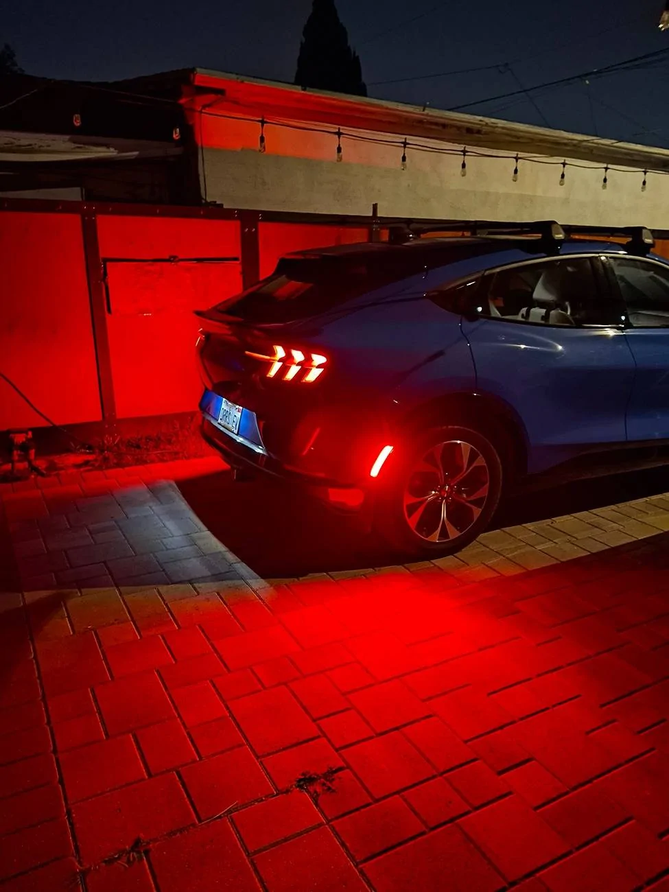

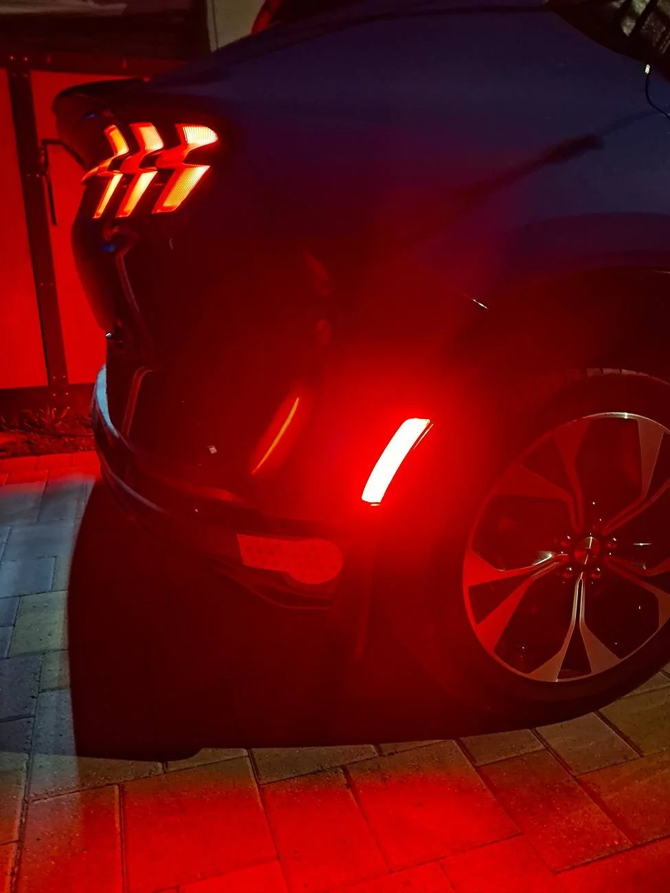

Yeah, I'm bummed too. The red color hue doesn't match the tail lights either, which I expected, which is ok. It's a little on the yellowy side to me. I could live w/that. But it was just the brightness. They're brighter than the taillights (though not brighter than when the brakes are applied). Just didn't do it for me, but I'm sure I'm in the small minority. They're probably fine for most people. Hopefully they're good for you.

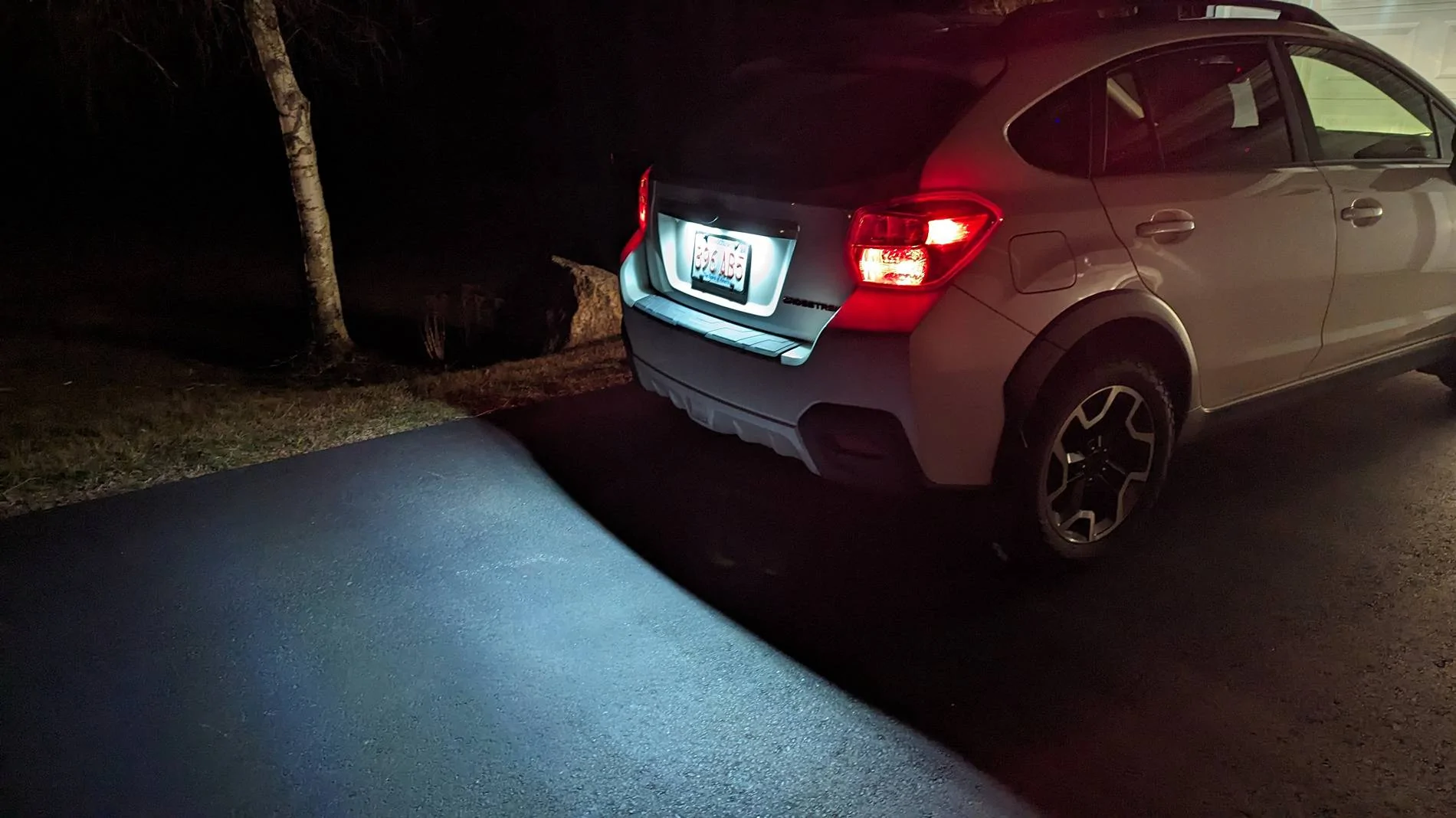

Wow, those do seem uneccesarily bright!
Reminds me of when I changed out the plate lights on my Subaru with Led light fixtures.?

Those are bright license plate lights! Could be a search & rescue spotlight ?
Again, for me these lights were a tad too bright, but they could be fine for you, and I imagine most people. It's purely an aesthetic decision ?

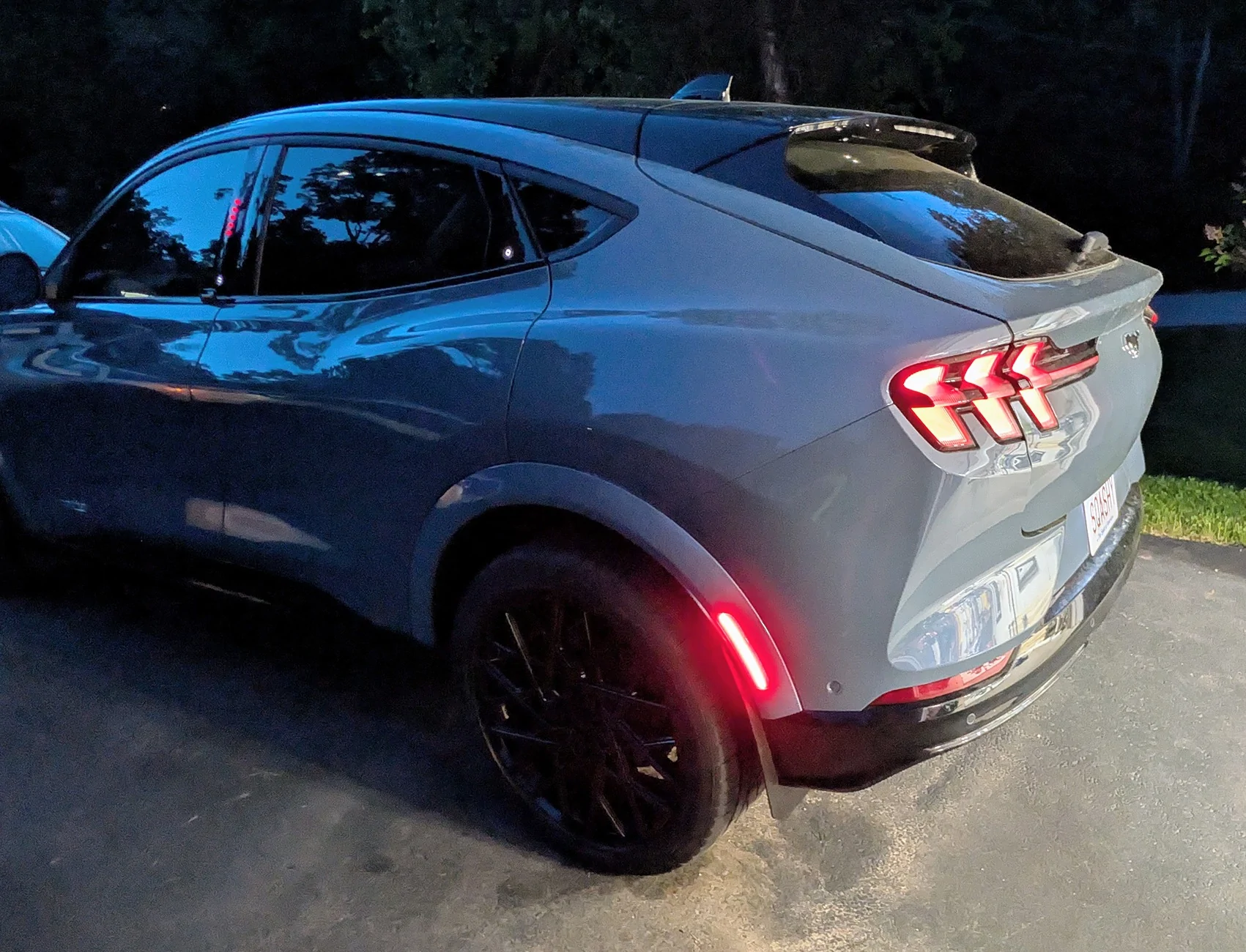

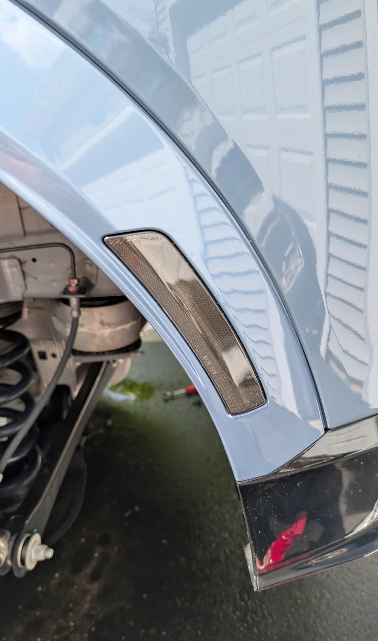

So it took a hot minute, but I finally got around to swapping out the side markers this week. Well, actually only the rears. I'm not sure yet if I'm going to install the fronts as they're not meant to light up anyway.
I do like how they look lit up, but dang are they bright! A bit too bright. I need to live with them a little longer before deciding whether or not to keep them.
