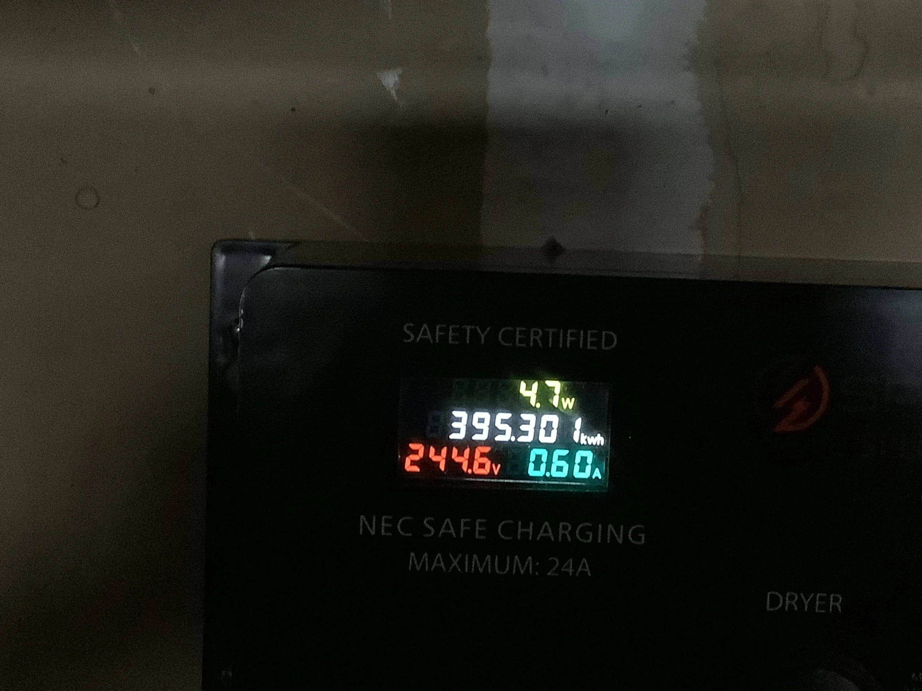

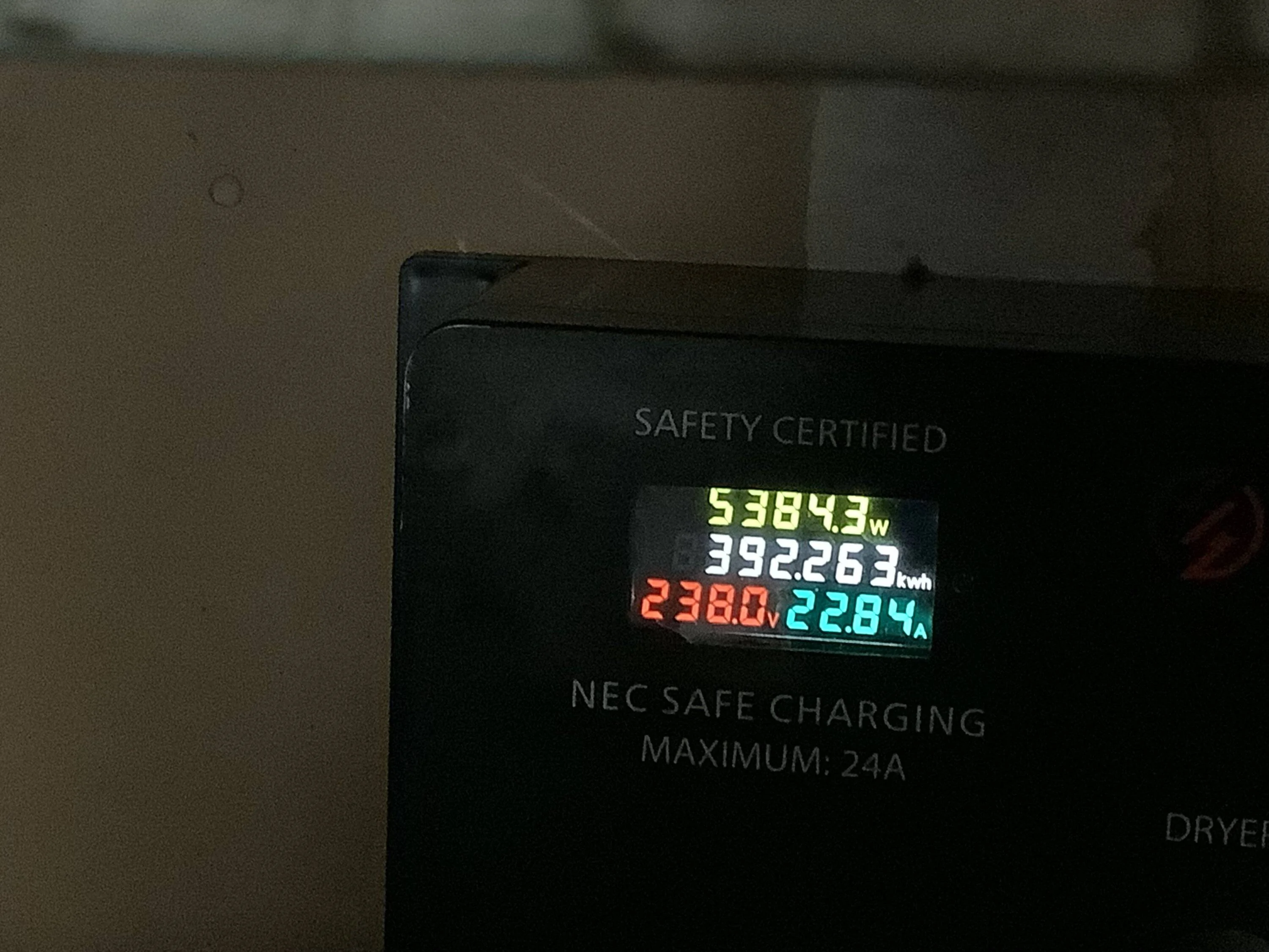

This is the car keeping the battery above the low temp limit. It is a good thing for it to do that since it keeps the battery from getting too cold. It does use about the same amount of energy as charging on mine but I use a 30 amp outlet so my max is lower. I have a SplitVolt switch which shows the wattage being used and the voltage and current going to the charger. I got a photo of the screen during one of the preparing for drive events and one when it was idle, Even at idle the car is using some electricity. My guess it is to keep the functions on that are needed to control battery temp. The first one is during the preparing for drive and the second one is when it is idle.

There is a KWH meter on the SplitVolt. During the time when I too the photo it was at 392.263kwh. When I too the second photo it was at 395.301kwh so it used quite a bit between the photos. It was not that long between them. I do not have a set charge time or a schedule departure time setup, but when it is not doing the preparing for drive it is using very little current.

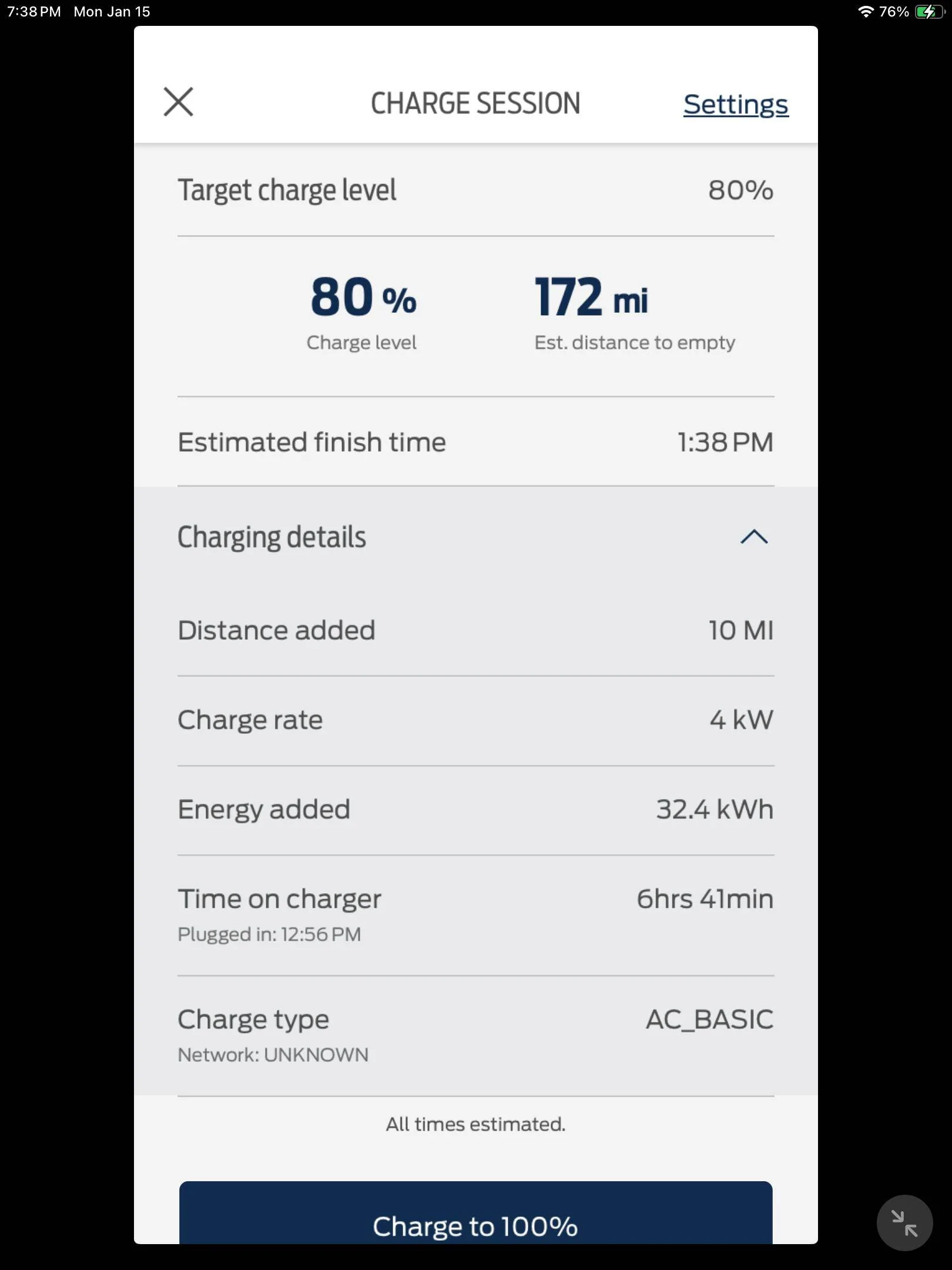

I forgot to add this. I unplugged long enough to get some lunch today and that dropped it from 80% to 78%. I plugged it back in when I got home and here is the current usage on Ford pass. So according to that it has used 32.4kwh to add 2% of charge. It is currently 22 degrees. I don't normally leave it plugged in unless I am charging it but since I have the 12v battery has gone up to 99%. It is usually the low nineties or high eighties. So I might have to start leaving it on overnight when I do plug it in to charge. I was just leaving it plugged in while we were having temps below freezing.
