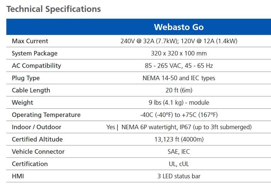

There seems to be an error in the operating temp range listed in their spec sheet... Ford's mobile charger takes a nap when it's 110 in my garage... There's no way it stays operational at 167.
This is way way higher than I've seen on any other EVSE's spec sheet.
It should probably say "storage temperature," not operational.

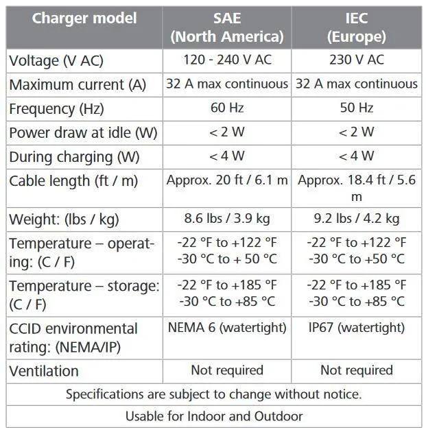

OK, digging a little deeper, I found the user manual. It disagrees with the tech sheet shown above (which are the same data that are embedded in the OEM version of the specs).
So who knows what's right, but the table in the manual is more reasonable. Still, I'd say they've done a subpar job with heat management in my personal experience with this product.
