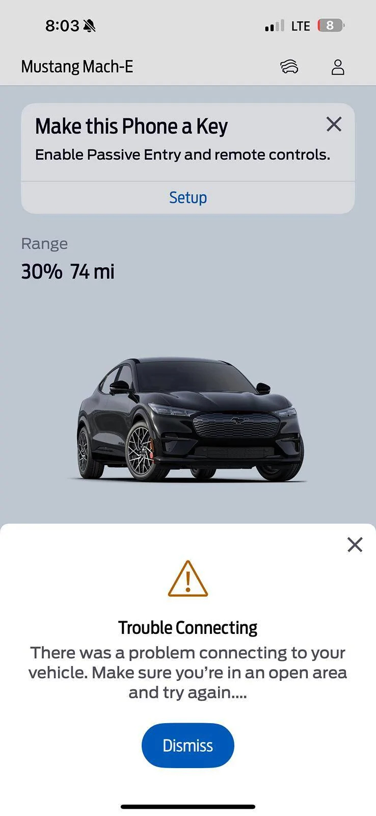

I deleted the app after successfully installing the PAAK as it was buggy. Now I can’t reconnect; I get this error message yet an email from Ford saying it was successful. What am I doing wrong? Thx!!!

Maybe toggle your Bluetooth on and off or hard boot your device?
Ignore the email, it’s not an accurate representation of Paak being setup as there’s steps after that that have to happen.
Reset Paak in the vehicle under settings and try again.

Yep, are three years of successful PAAK the new app destroyed it. But I did get it working after 3 days of experimenting and hours on the phone with support. Here's how.
1. Unpair ALL Bluetooth devices and uninstall FordPass
2. If you have a smart watch pair it first
3. Install FordPass and setup PAAK
Setting up PAAK first seems intuitive but I learned the hard way that installing the watch AFTER PAAK causes PAAK to stop working.
