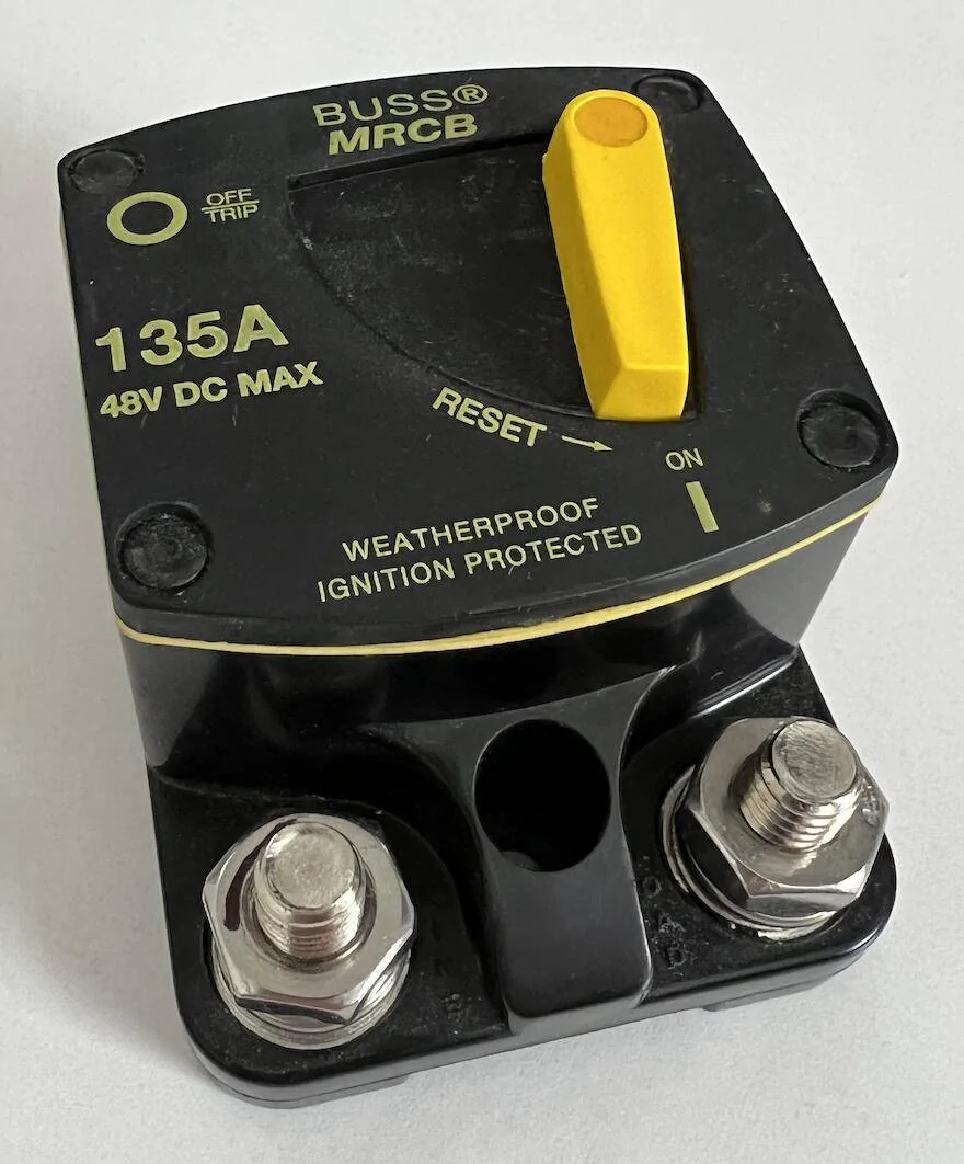

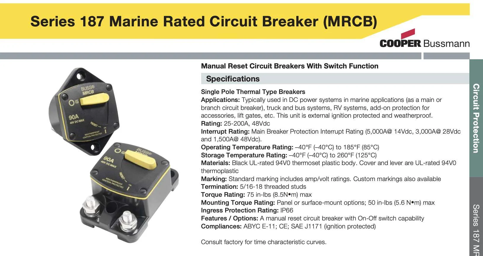

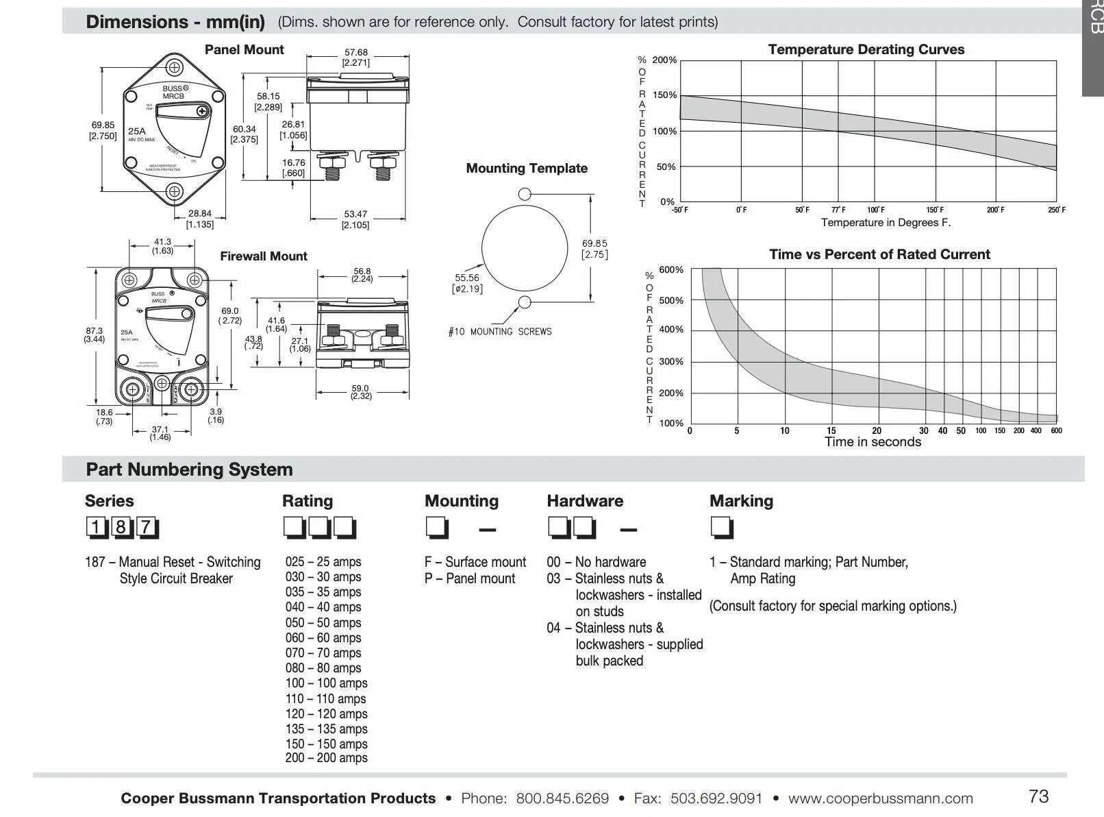

From past DC work with a Chevy Volt, I still have a BUSS (Eaton) MRCB breaker, marine applications, very nice quality, near industrial if not. I have a 135A, but they trip very slowly as shown in curve below. For example, the actual 135A trip is over 400 to 600 seconds. (I actually got a smaller one for the Volt, once I realized the trip curve.) The threaded studs are large to accept industrial quality #2 cable crimp lugs. I need to pull the covers later to see if there is room for the breaker. If so, I am thinking this might make a good quality inline ground switch. The switch could be used for installation work (e.g. amplifier work, adding a sub woofer fused power line, etc.) or just for cold booting MME, like last month when I lost my driver's speedo display, and lifting the negative terminal reset it near instantly.
I guess I should try to measure the resistance to see what it would add to the ground leg. This would be an unconventional use, usually these devices are used positive side, such as for DC distribution. Note that the DC/DC converter path too (+) and from (-) the 12V bus would be unaffected.
Still need to check to see if there is room. Otherwise, what do you think about this possible approach? (most people will not have access to Greenlee heavy cable shears and industrial crimpers for industrial quality lugs, so it is not an easy universal solution).
Also, a slight irony is that to install a switch or breaker, I will need to take the ground cable completely out, so at least one more 10mm loosen, BMS lift off.

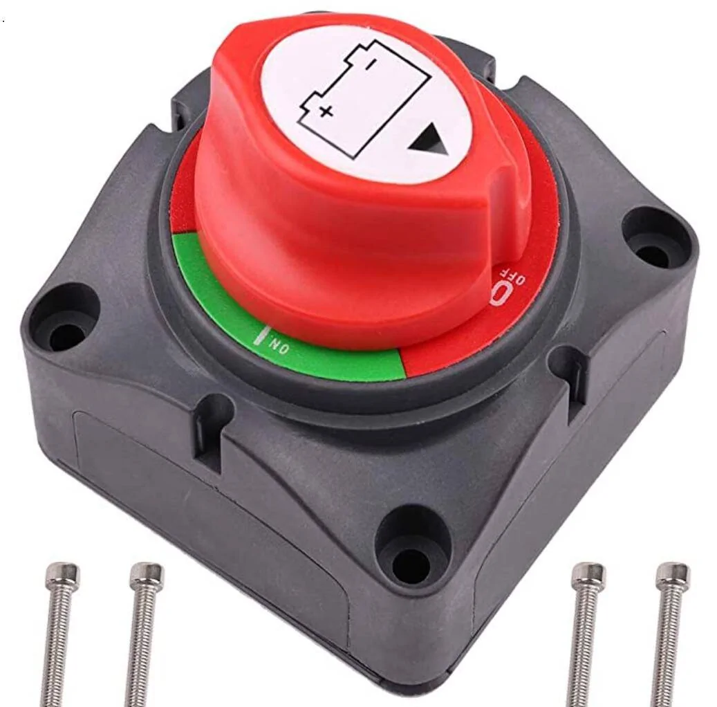

That approach could work. I would prefer a more industrial U.S. or EU version, but I think it would be the same. The resistance of a 100 to 200A breaker might not be an issue, but I do need to measure it later. Eaton (BUSS) or similar manufactures might offer a switch too.
There are of course any number of negative terminal quick disconnects, but we need the BMS to mount on the terminal, plus the quality of many of those auto store products is probably dubious at best.
I put one in my RV seems pretty solid even after about 5 years. (Granted not that specific one I linked to.)
